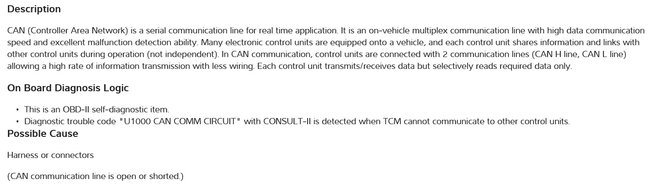

Can you please help me figure out this code I have cleaned multiple ground connections just to make sure that that isn't a problem is there a specific one that needs to be cleaned

that is communication has been lost see pic for explanation. a pro has to hook his scanner up to see where the problem lies.
