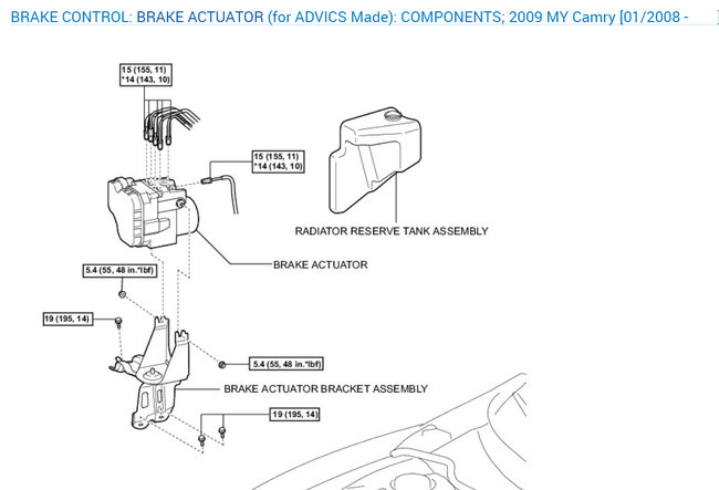

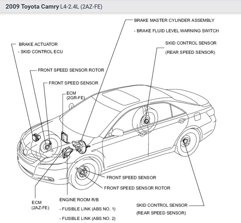

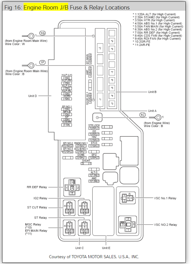

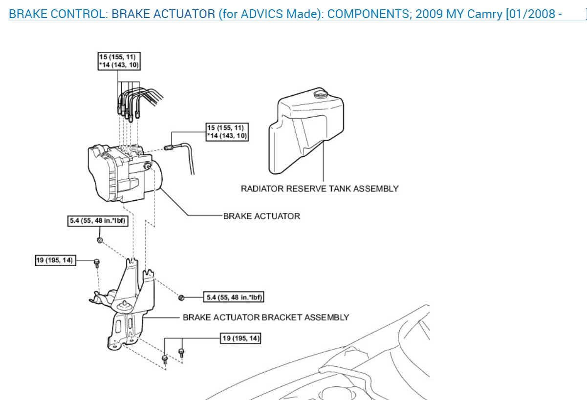

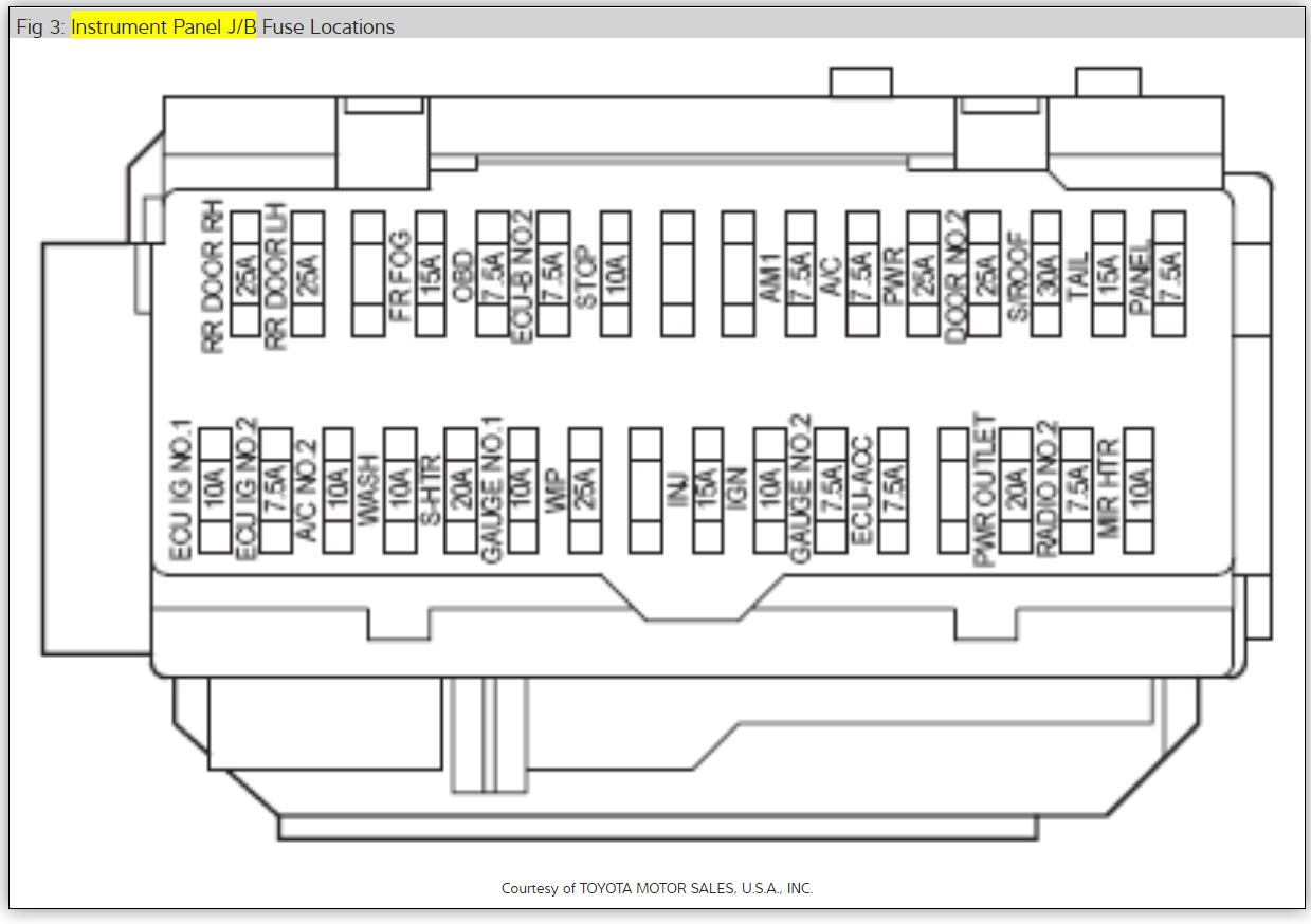

The U0073 code is for the lost communication with the ABS module. I would check the fuses first and if okay replace the module.
Here is how in the images below:
Check out the images (below). Please let us know what happens
