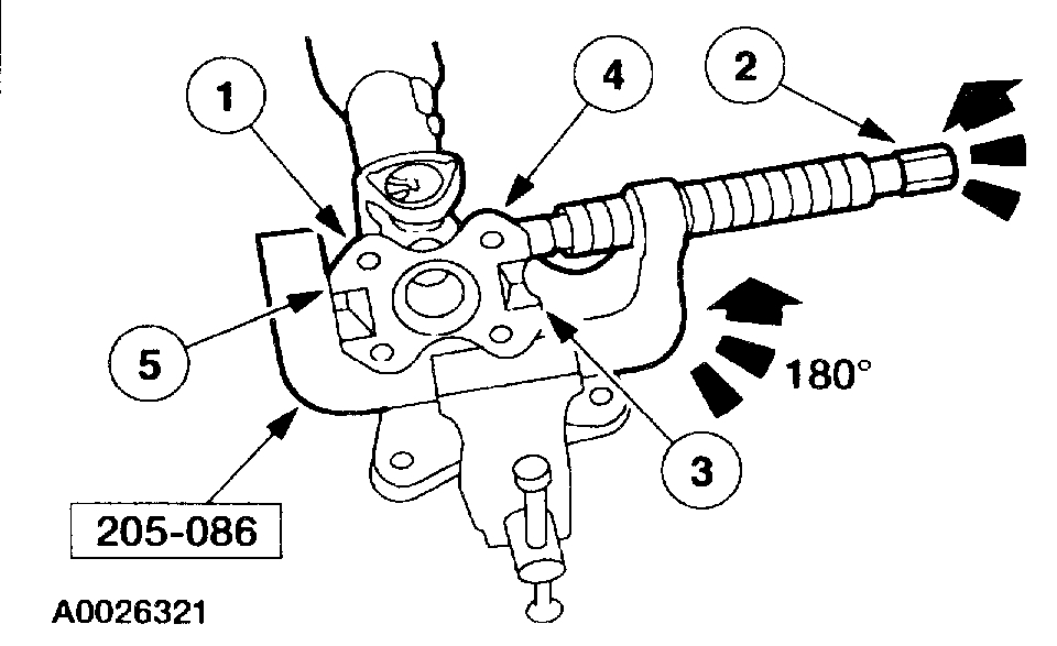

I'm in a really desperate need to replace my driveshaft u-joints by next weekend. I pretty much know how to get the shaft off the rear axle and slide it out from the transmission (after I mark it's positions) but my challenge comes after removing the snap rings, a lot of people use a ball joint press and an impact to get the caps out of the ports. but I really don't want to go that route and buy extra equipment I more than likely will never use again. I know there's loan a tool but they either don't have the press or there's pieces missing from it. I was hoping it was possible to gently knock them out with a rubber mallet or some other way, or maybe if there being a trick to it. can you guys help me? Thanks!

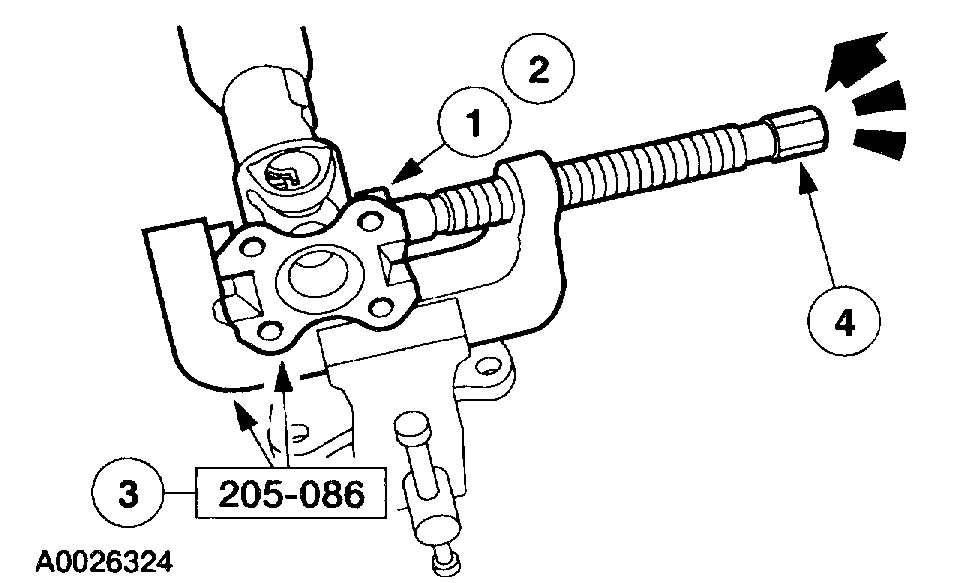

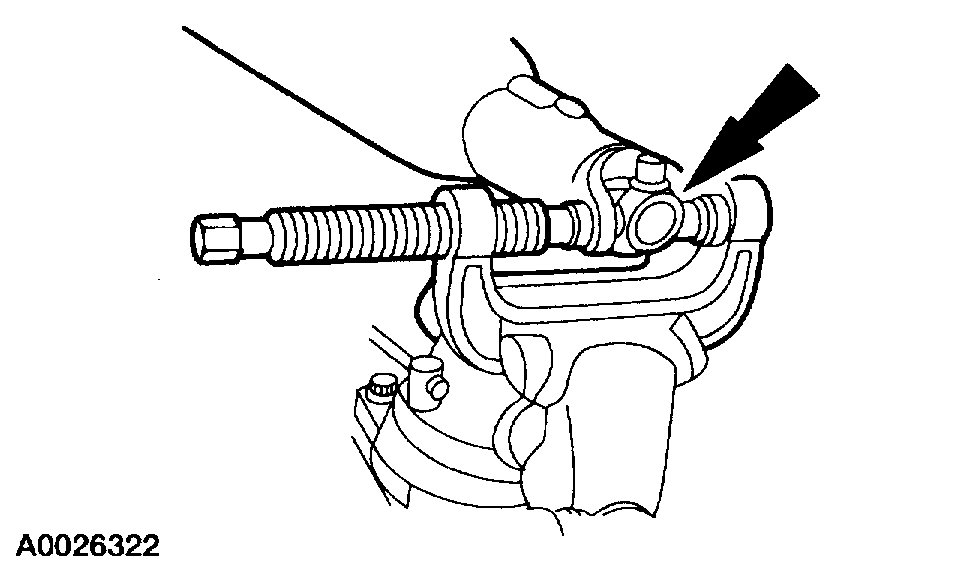

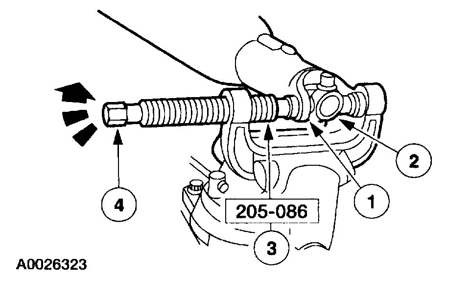

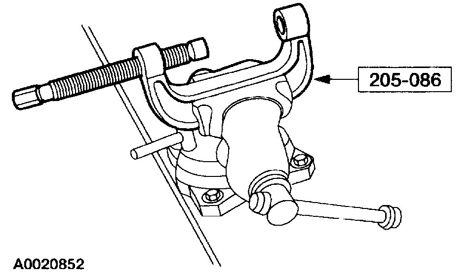

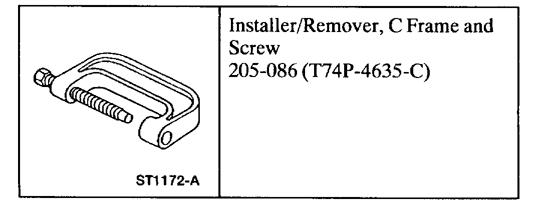

Honestly, you need a good C-Clamp. I have also used a vise and two sockets. Once that is slightly smaller in diameter than the end cap on one side and one that is larger that the outside diameter. Using a vise, I place the sockets on the joint. And by tightening the vice, the smaller socket will force the end cap into the bigger socket. Honestly, you won't get them out with a rubber mallet.
Here are the directions specific to replacement using the C-clamp or a c frame screw as described in the directions. The attached pics correlate with the directions.

Special Tool(s)

4. Clamp the special tool in a vise.
Bearing cup removal
5. NOTE: If necessary, use a pair of pliers to remove a bearing cup that fails to press out all the way.
Remove the bearing cups and the flange.
1 Position the flange in the special tool.
2 Press out a bearing cup.
3 Rotate the flange 180 degrees.
4 Press on the spider to remove there main bearing cup.
5 Remove the flange.
Final disassembly
6. Repeat Bearing cup removal in this procedure to remove the remaining bearing cups and the spider from the driveshaft.

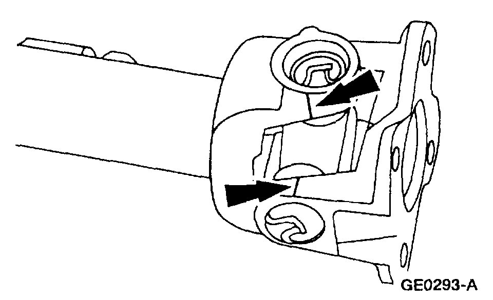

Install a new spider and bearing cups.

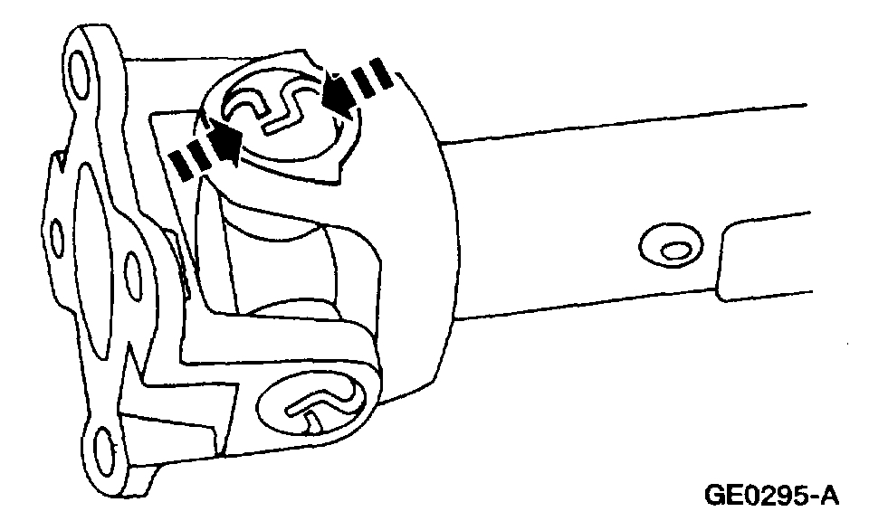

1 Start a new bearing cup in the driveshaft yoke.
- Check the needle bearings for correct positioning.
2 Position the new spider in the driveshaft yoke.
3 Position the driveshaft yoke in the special tool.
4 Press the bearing cup to just below the snap ring groove.
- Repeat to install the new bearing cup on the opposite side of the driveshaft yoke.
Flange installation
2. Inspect the flange. Install a new flange, if necessary.

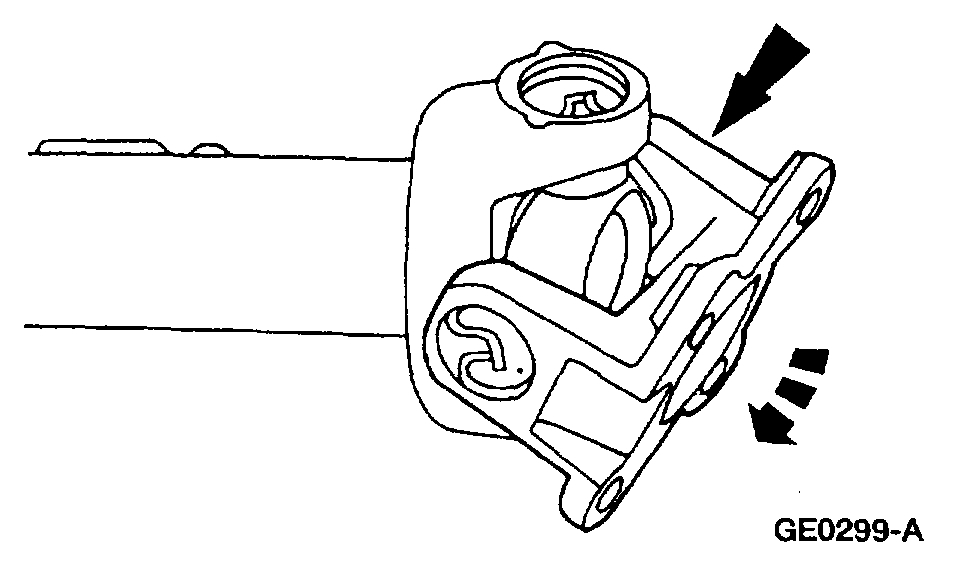

3. Install the new bearing cups and the flange.
1 Start a new bearing cup in the flange.
- Check the needle bearings for correct position.
2 Position the flange on the spider.
3 Position the assembly in the special tool.
- Repeat to install the new bearing cup on the opposite side of the flange.

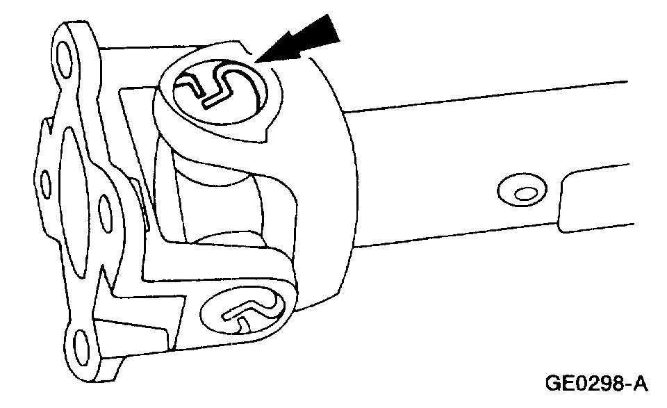

4. NOTE: Use the yellow snap rings supplied in the kit to assemble the universal joint (U-joint). If difficulty is encountered with the yellow snap Rings, install the black snap rings.
Remove the driveshaft from the special tool, and install the four new snap rings.
5. CAUTION: Do not strike the bearings. Check the U-joint for freedom of movement.
If binding, strike the yoke with a brass or plastic hammer.
