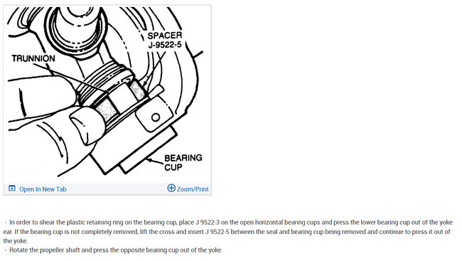

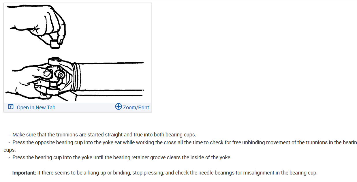

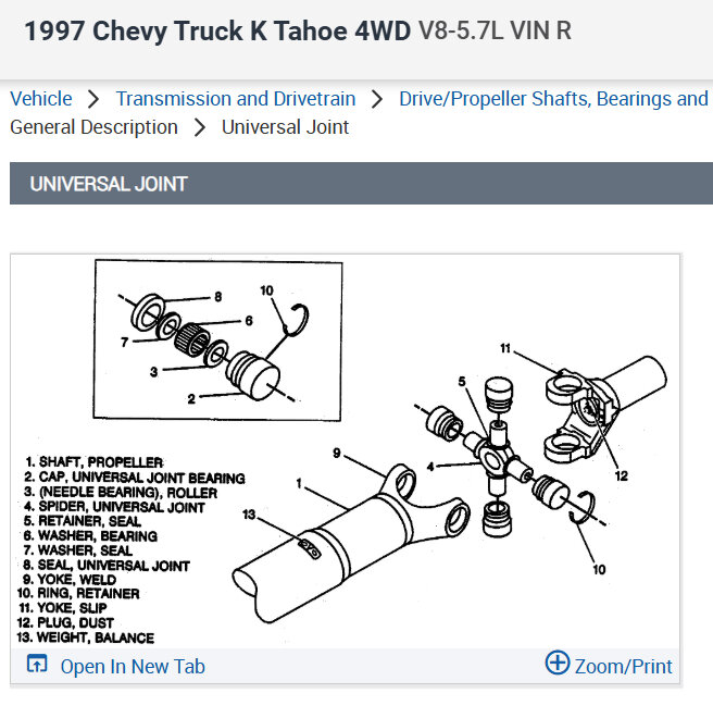

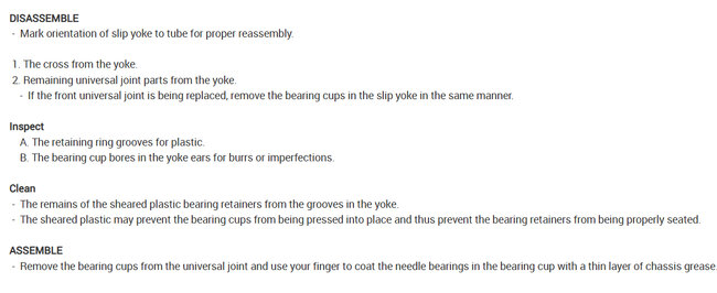

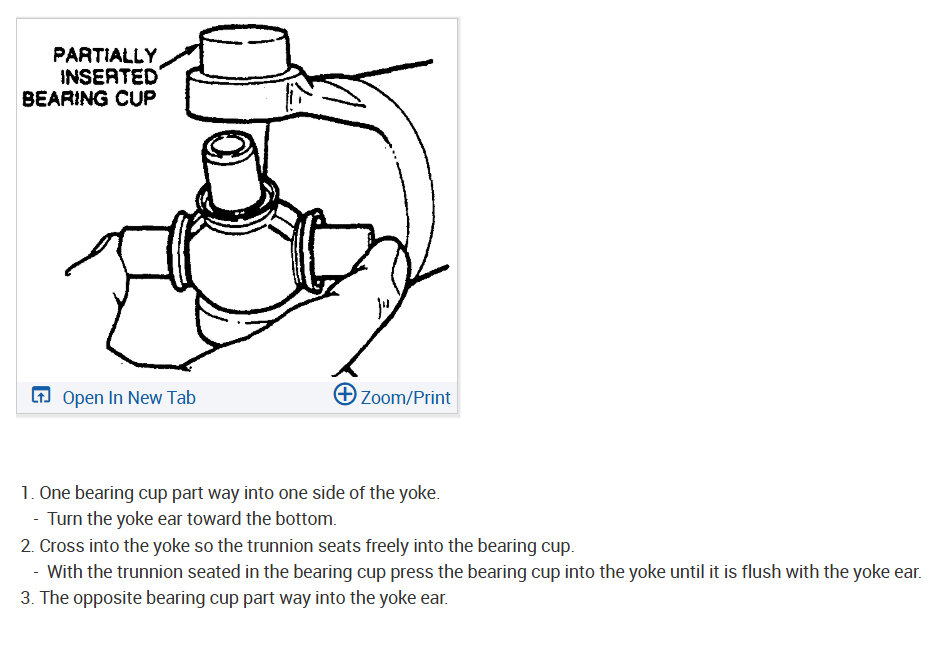

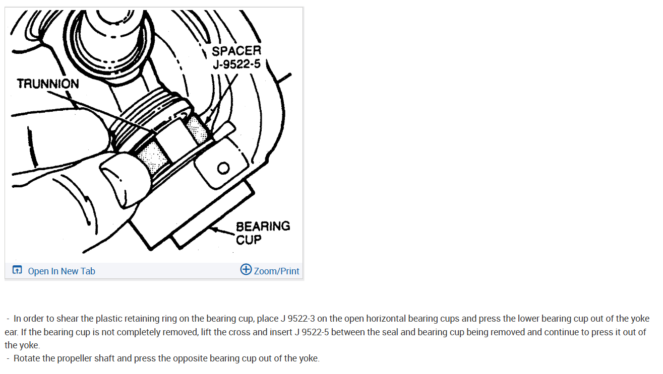

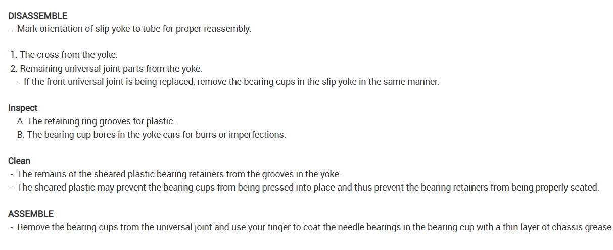

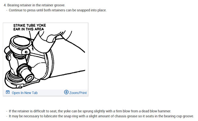

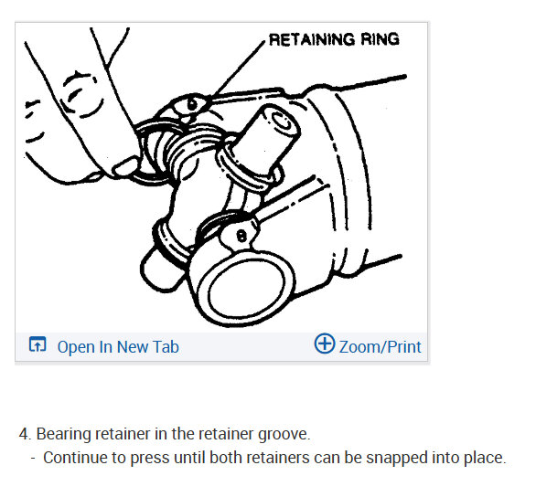

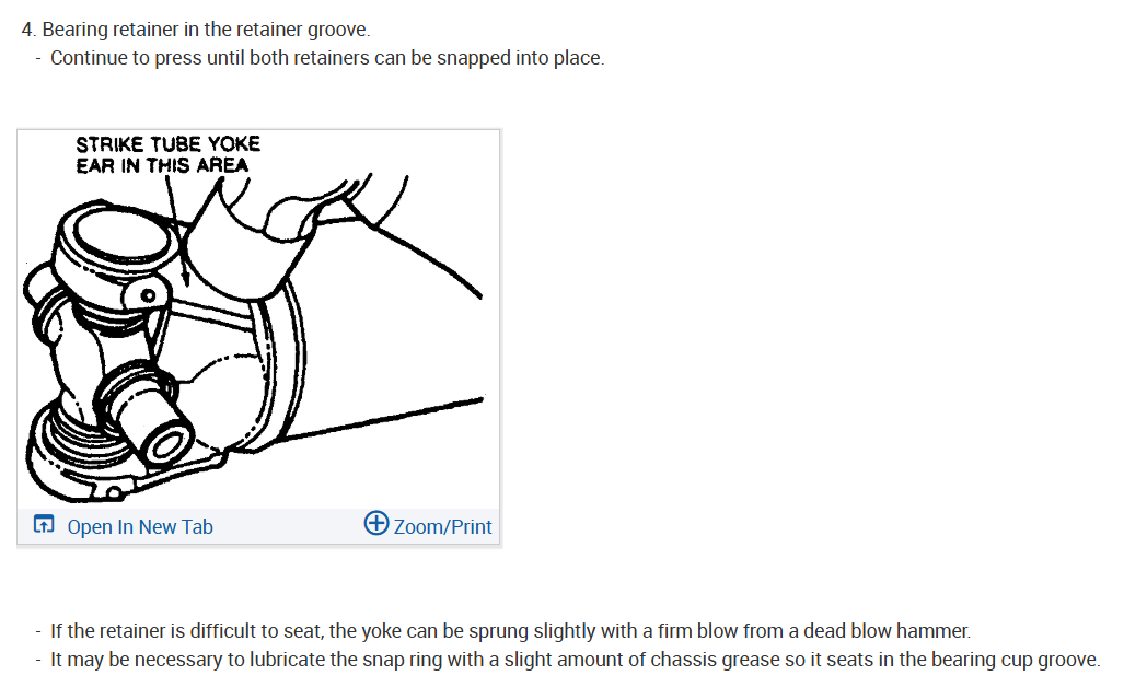

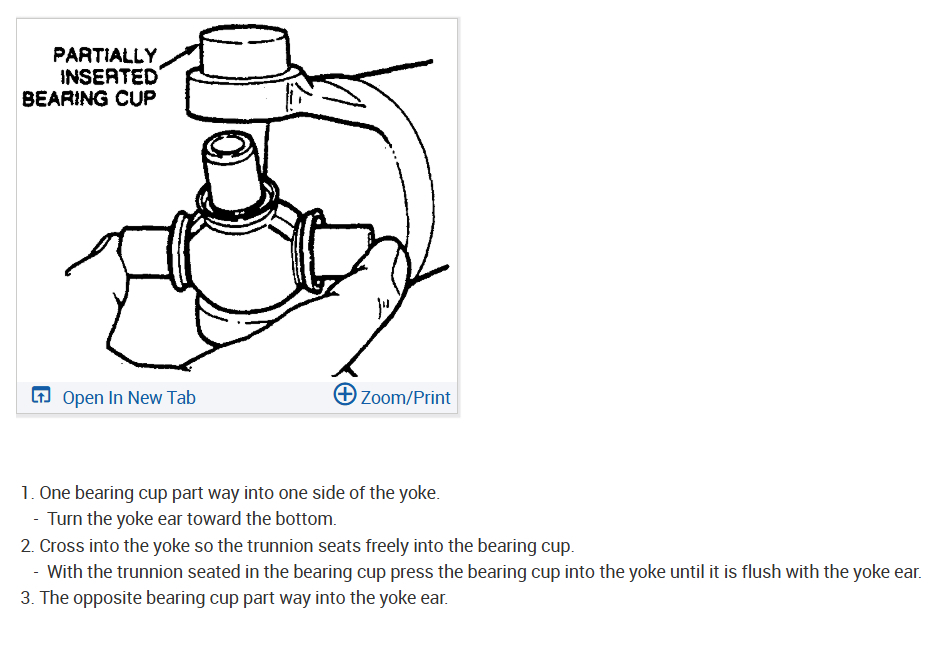

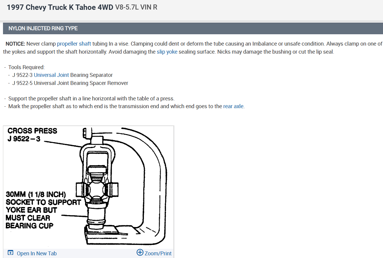

Can you upload a short video of the moment? Some movement is normal, can I ask of the rear end howls while driving? Here is a guide to help you change the U joints out:
Here is how to replace the U joints on your truck. Check out the images (below). Please upload pictures or videos in your response of any problems so we can see what to help you with.
