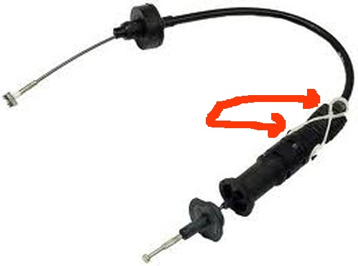

This should be a self adjusting clutch cable... however, in order
for the mechanism to work correctly, you need to first "collapse"
the cable so that it can be installed. Some do not have a cable fyi
Once the cable is collapsed (outer accordion shell compressed), attach
the cable at both ends and then it can be extended.
Pump the clutch pedal 5 or more times to allow the self adjusting
mechanism to find the correct adjustment.
In order for the cable to stay collapsed, it should have a plastic
tie-strap of some kind, that hooks into the lower part of the accordion
bellows, to keep the bellows collapsed... see image.
