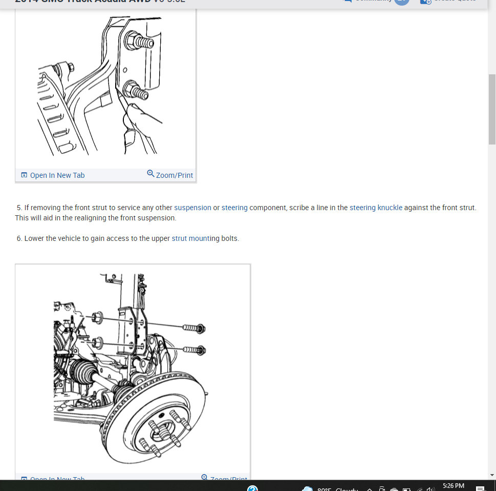

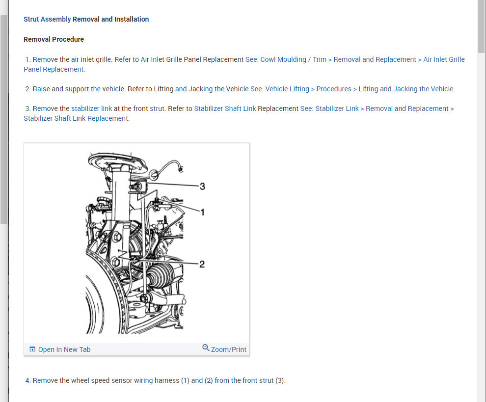

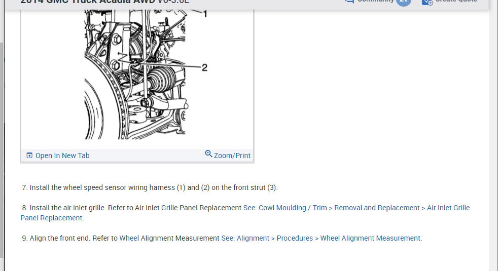

Sure. That is not an issue. These are not to difficult on this vehicle.
Here is a guide that will give pretty good info on how to do this as well:
Clearly this is not your vehicle but it has good tips that will help with getting it replaced.
https://www.2carpros.com/articles/replace-shock-absorber

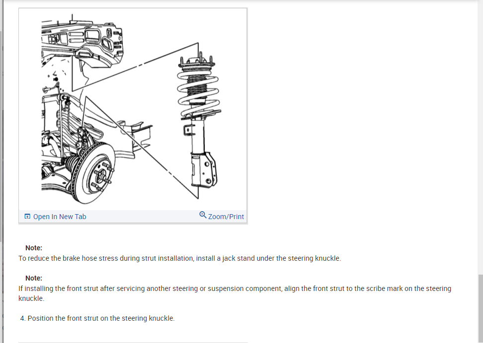

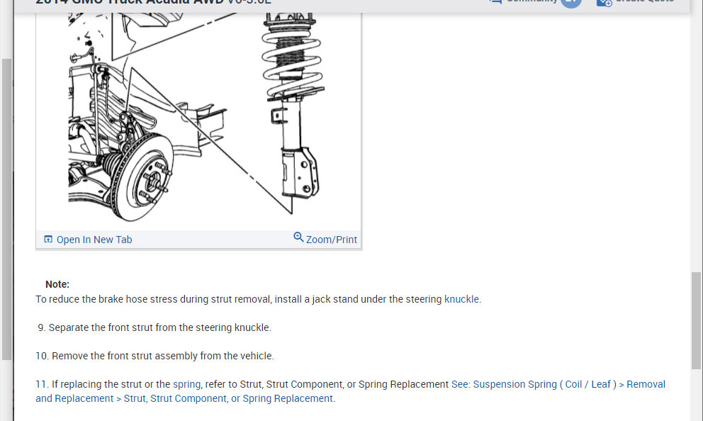

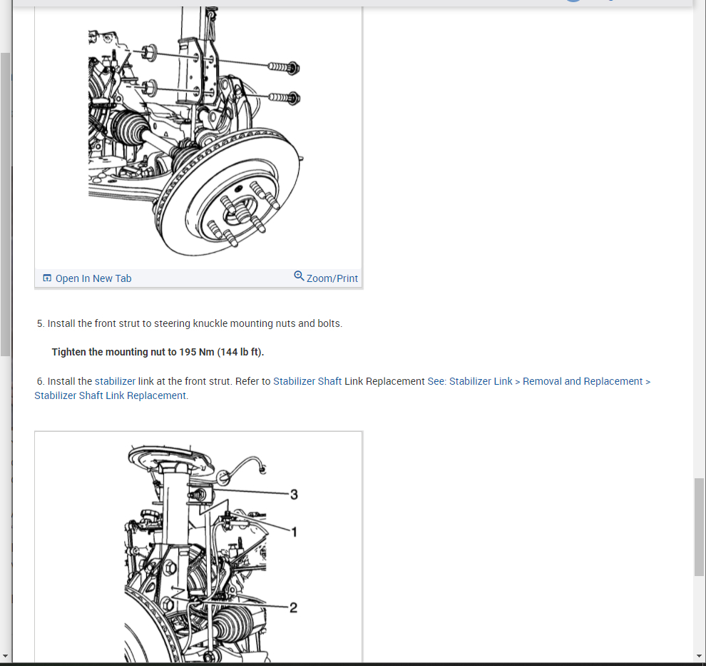

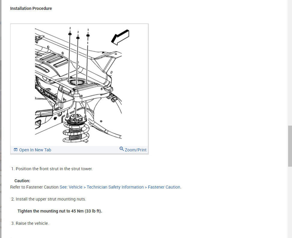

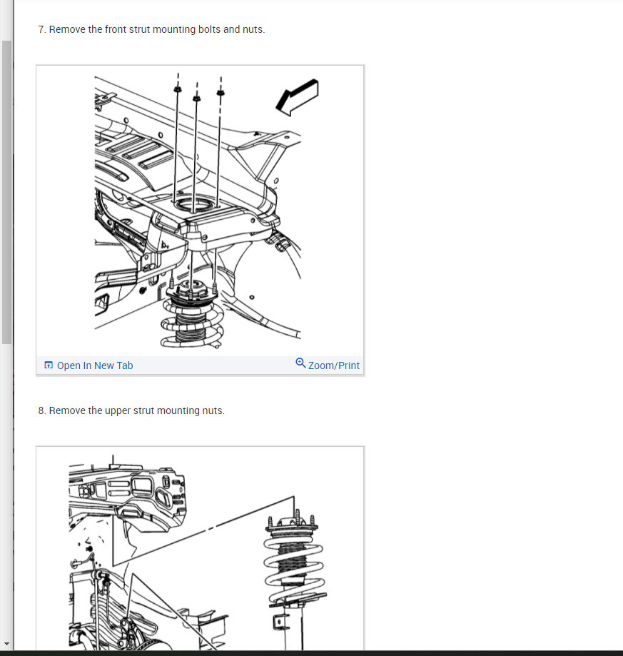

Below is the process from the manual that will help with replacing this info specific to your vehicle.
Please run through this material and let us know if you have other questions.
