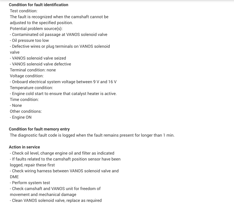

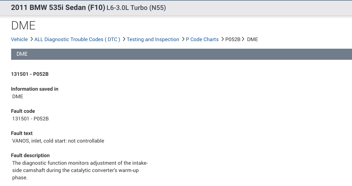

Can a crankshaft sensor cause a p052b and p054b two to three minutes after start up.
Dec 8, 2019 at 6:24 PM
SCGRANTURISMO
  • 4,897 POSTS

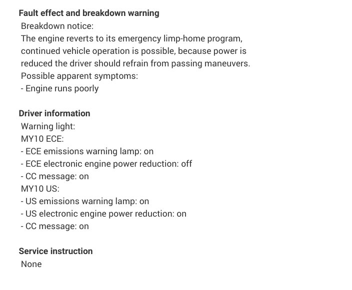

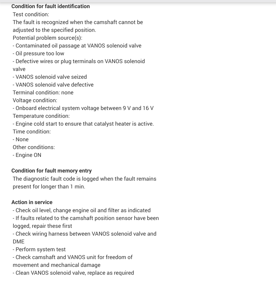

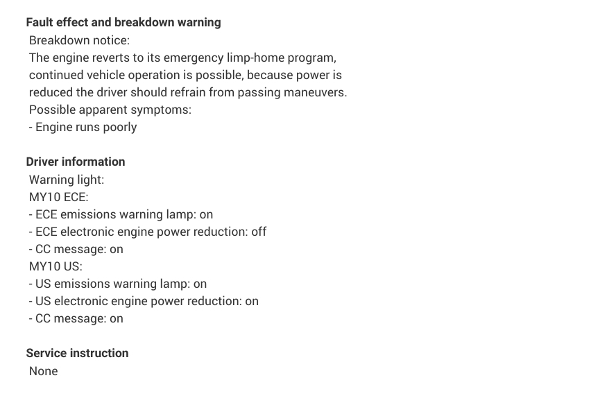

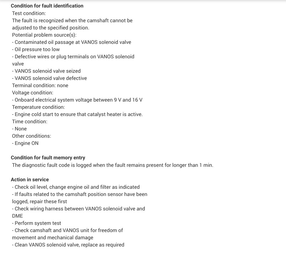

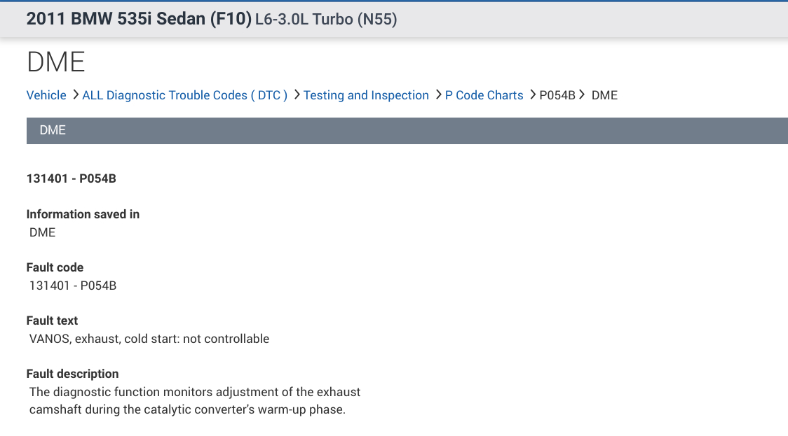

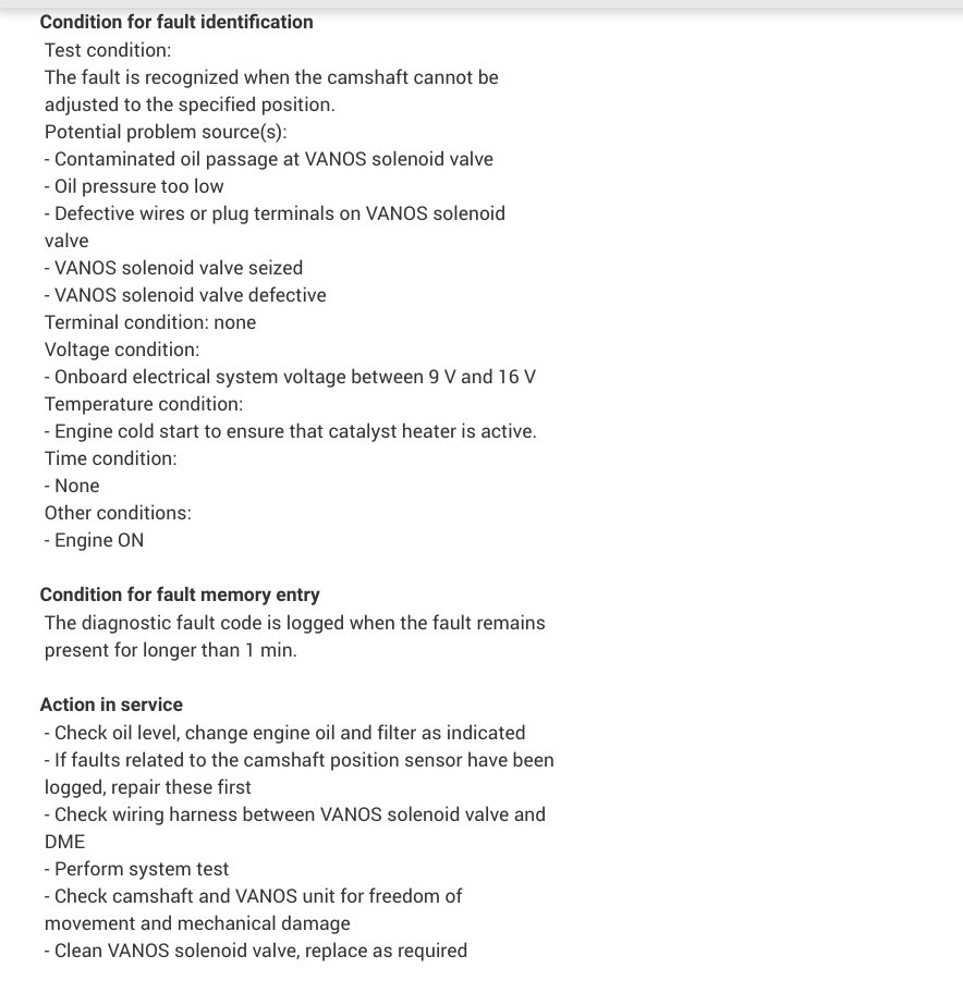

No. These two Direct Trouble Codes [DTC][s] are dealing with your vehicle's engine's camshaft not being able to be adjusted to their proper spot. In the diagrams down below I have included the description and troubleshooting guide for your vehicle for these two DTC's from the vehicle manufacturer. Please go through these guides and get back to us with how everything turns out.
