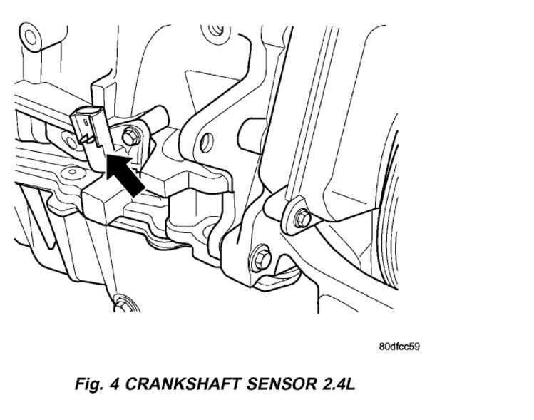

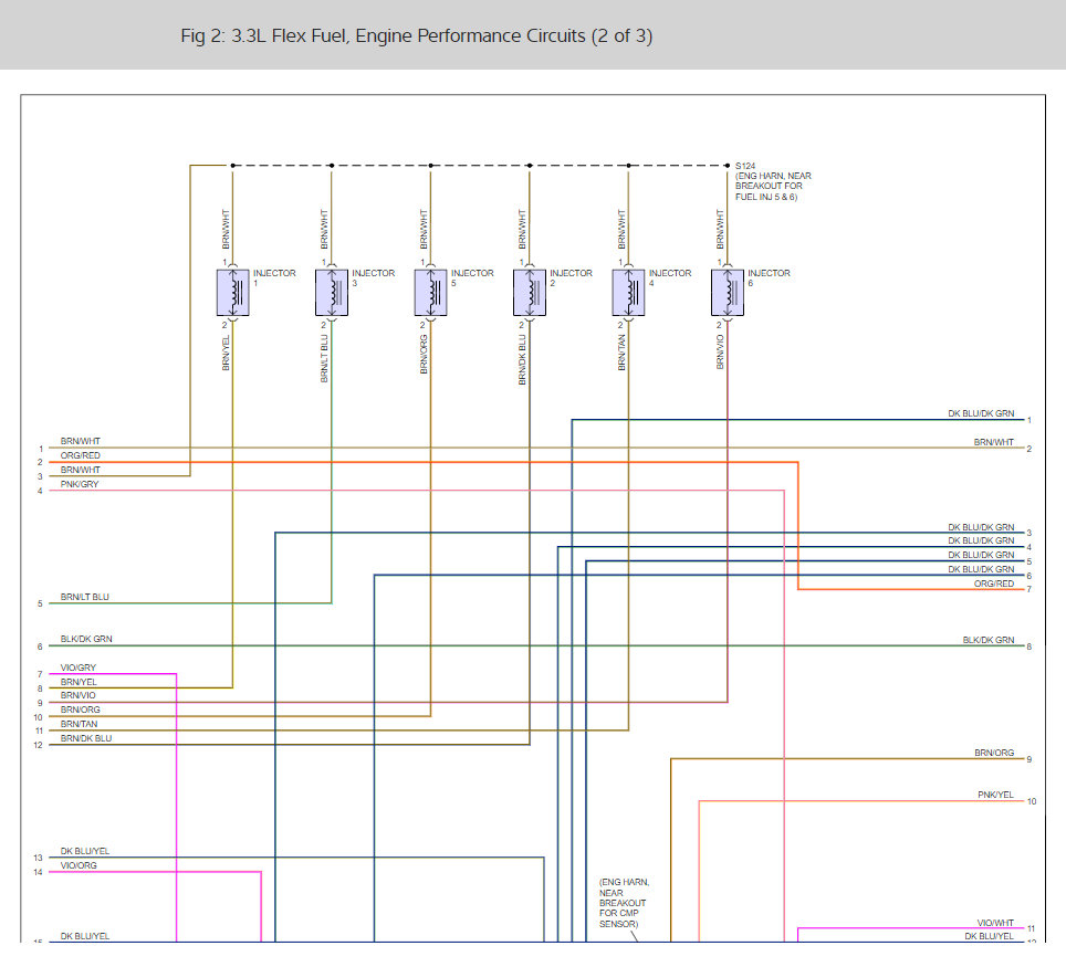

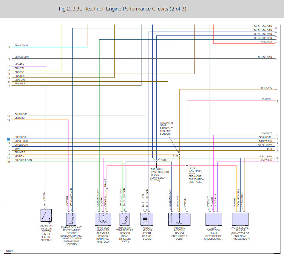

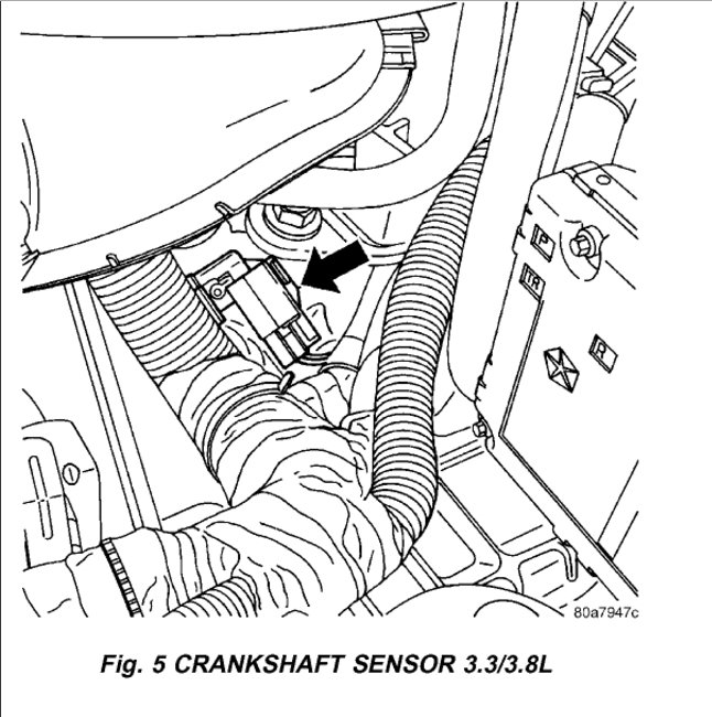

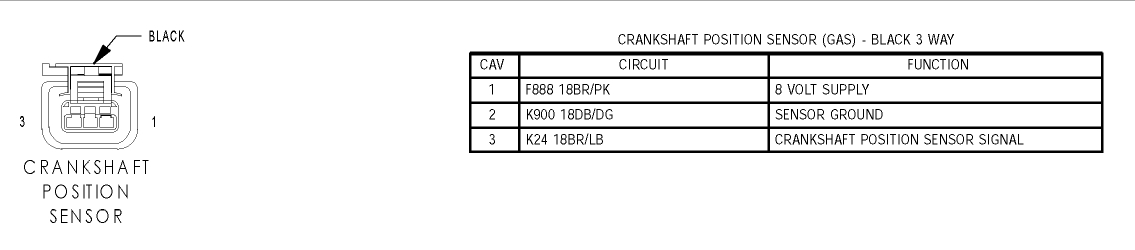

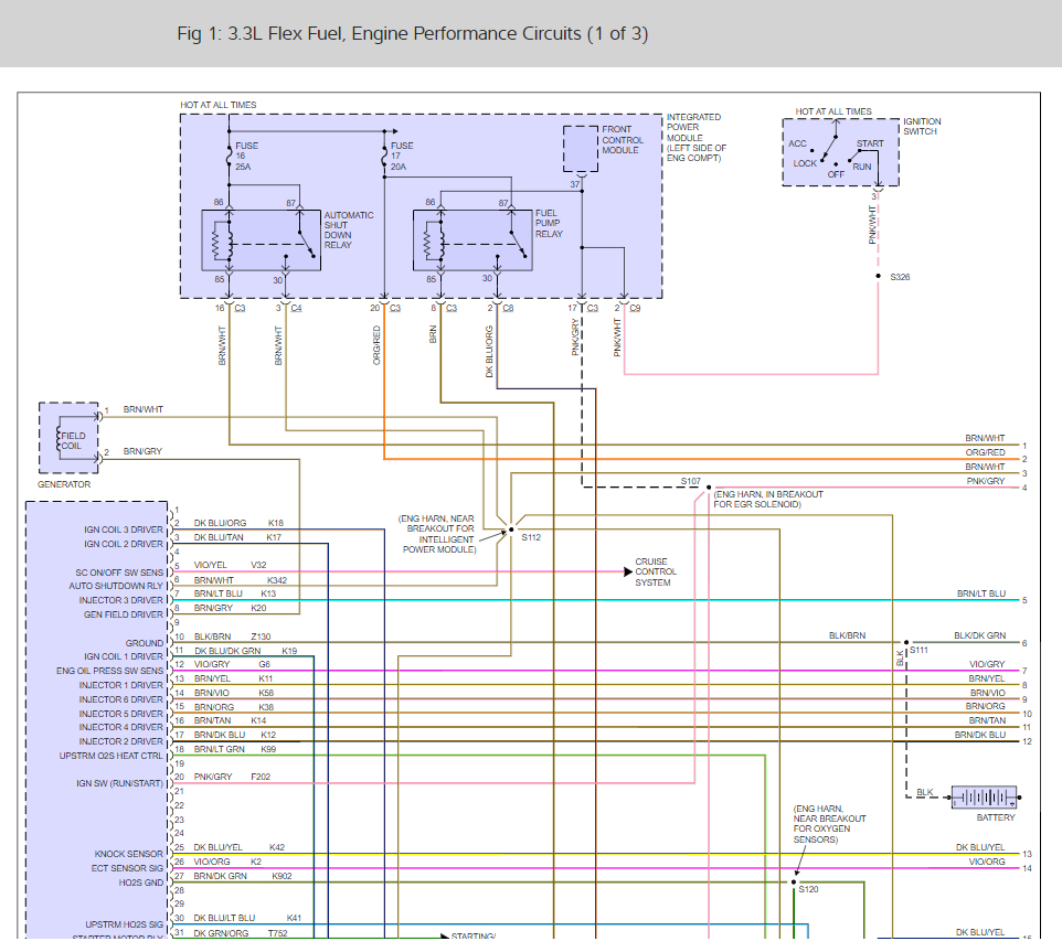

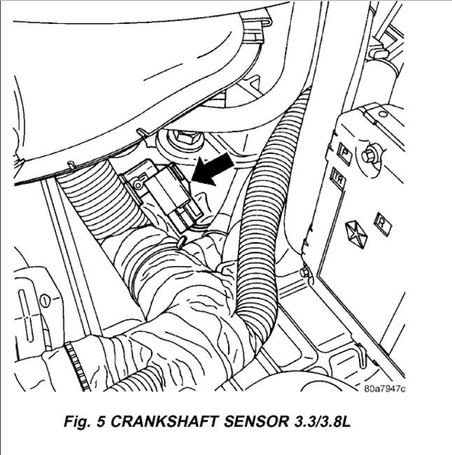

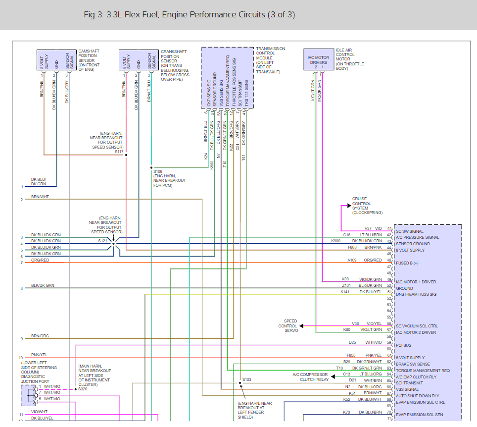

It sounds like you have a crankshaft angle sensor going out which may or may not set a trouble code.
These sensors will make the engine stall without warning. Here are a could guides and some diagrams (Below) that will help you see whats going on.
and
https://www.2carpros.com/articles/engine-stalls
and
Please let us know what you find.

Replaced the crankshaft sensor... Still same sound of it trying to turn over but no spark. Real head ache of an issue.

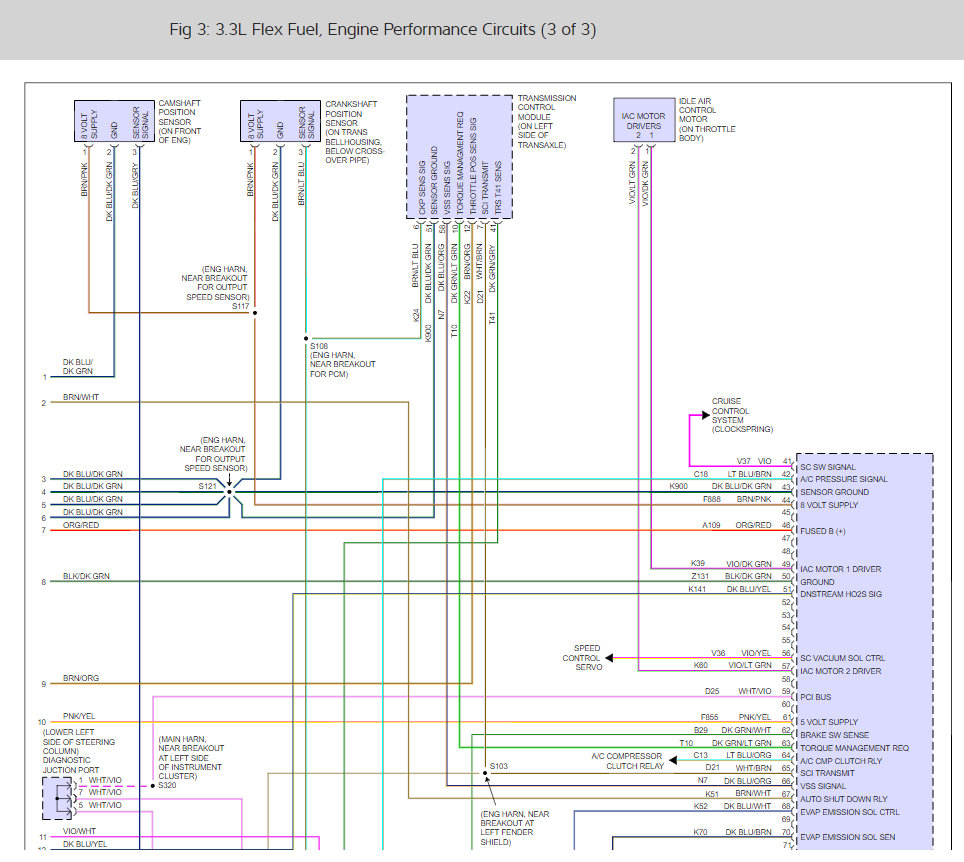

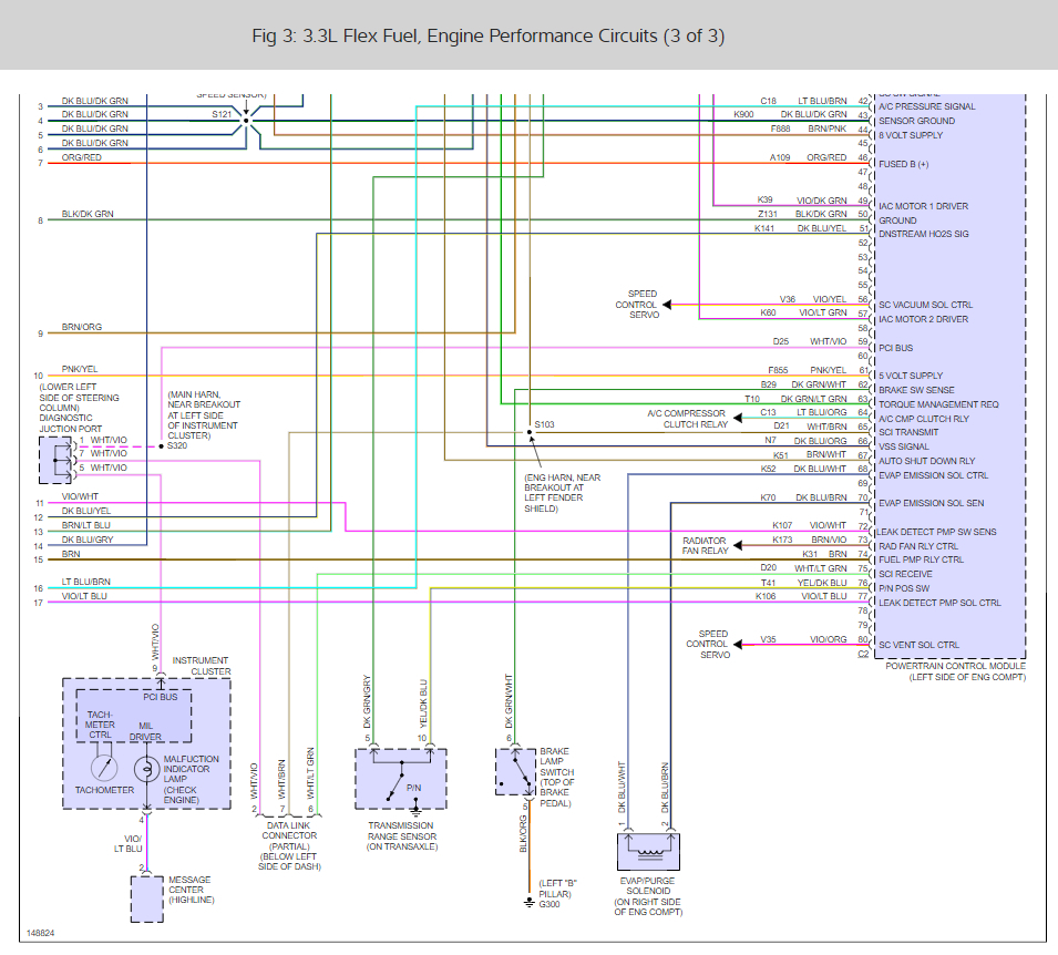

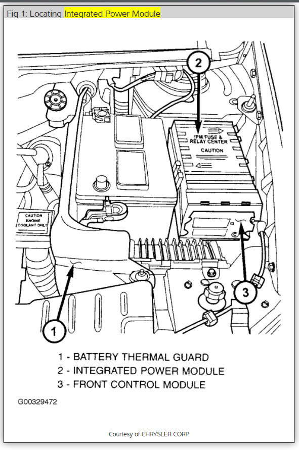

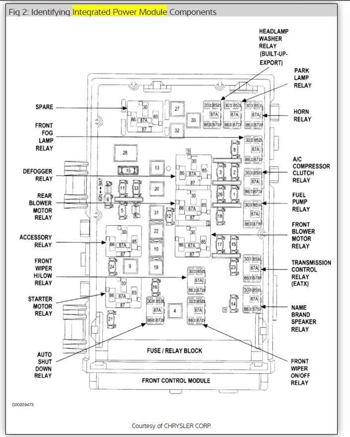

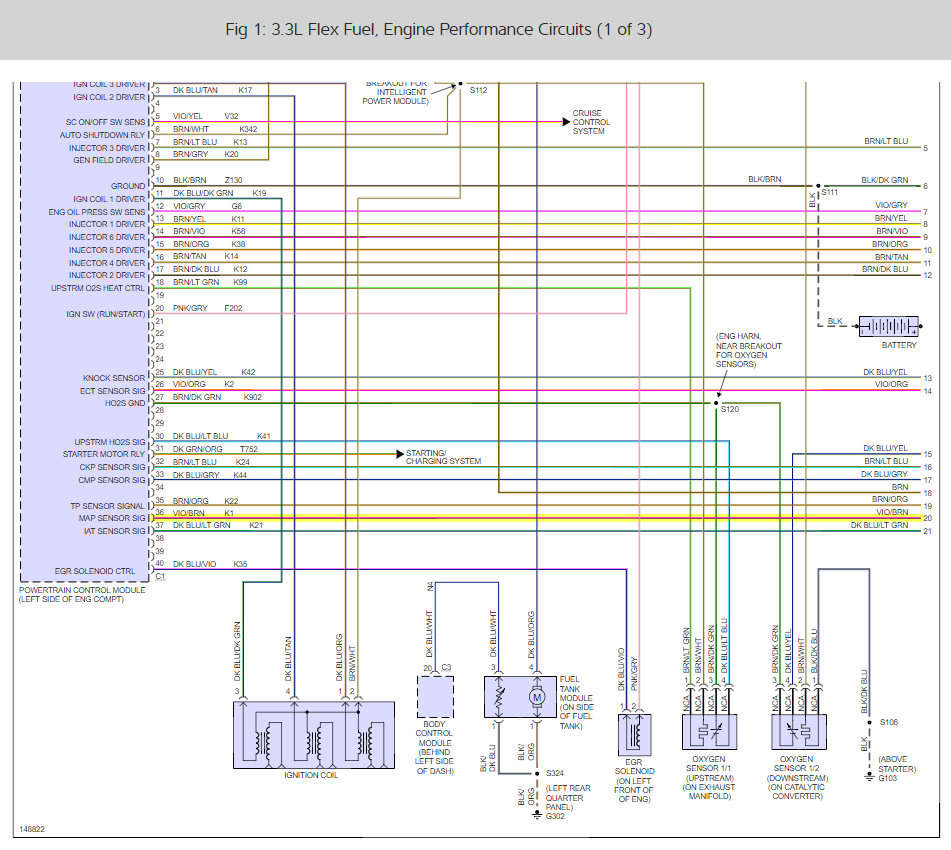

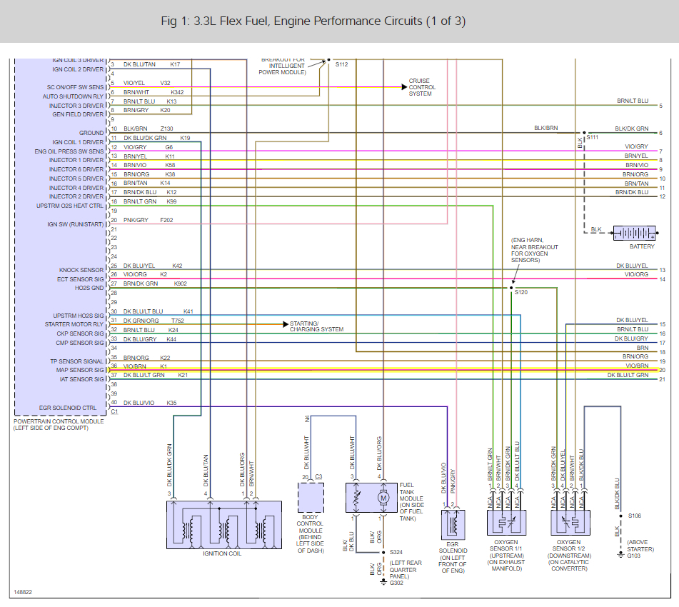

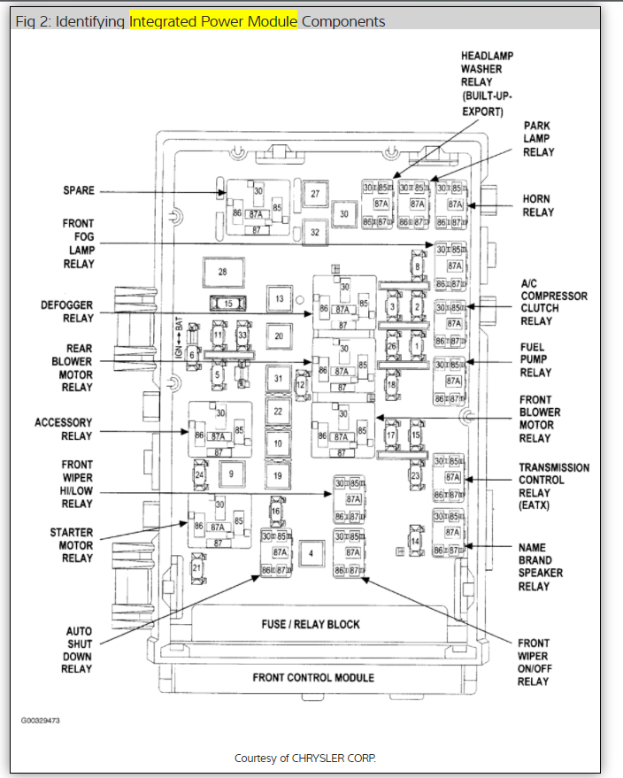

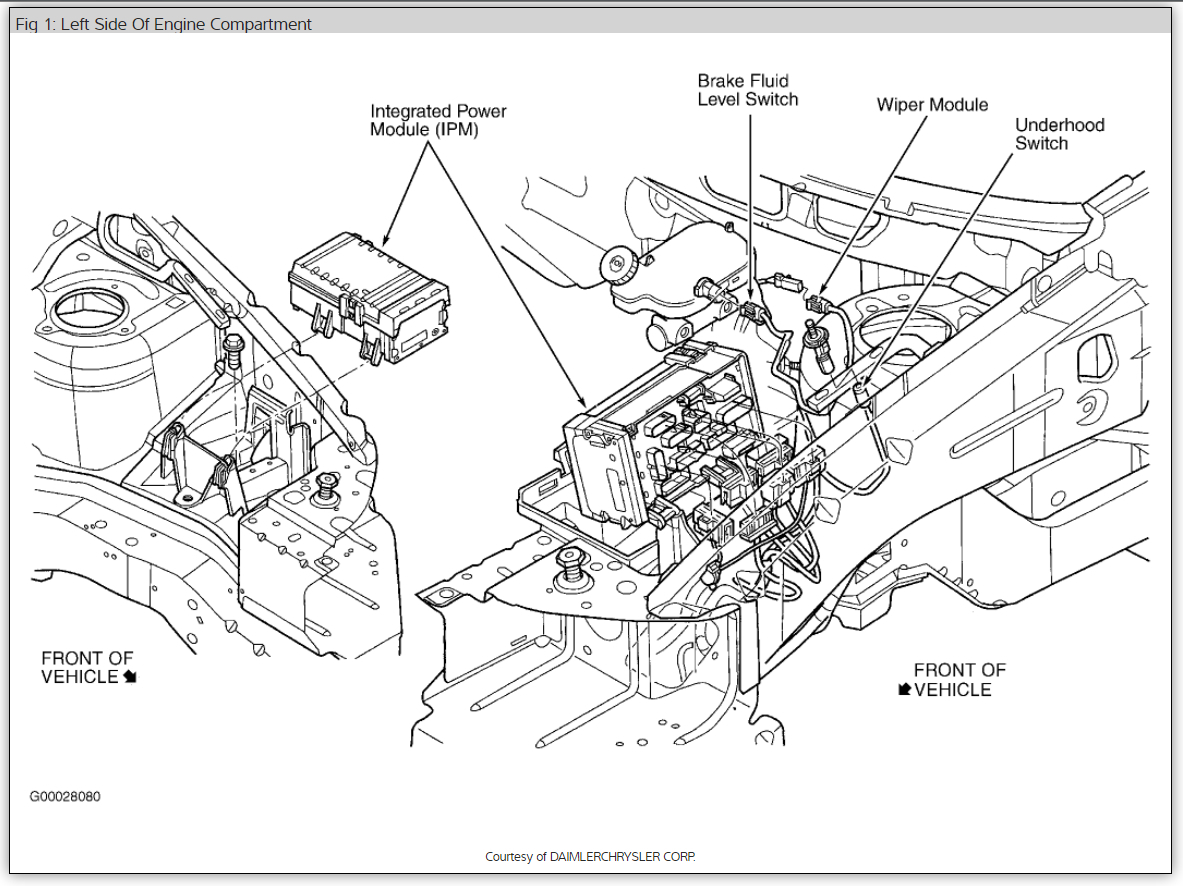

I am thinking the auto shut down relay can cause this problem. Here is a guide and some diagrams so you can do some testing.
and'
