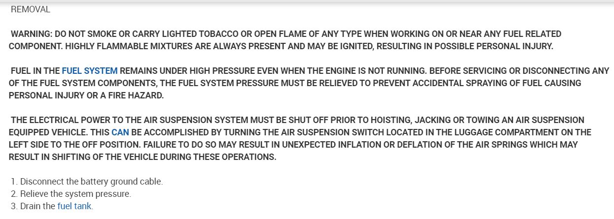

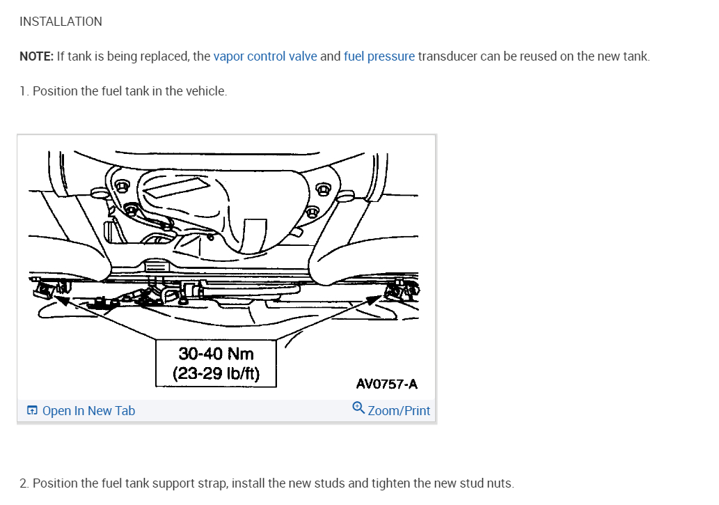

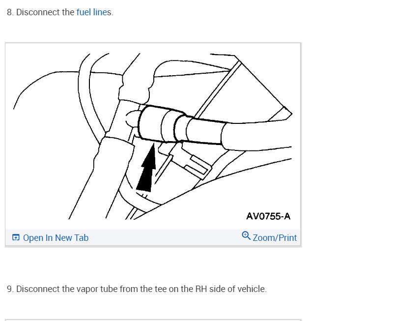

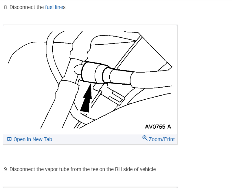

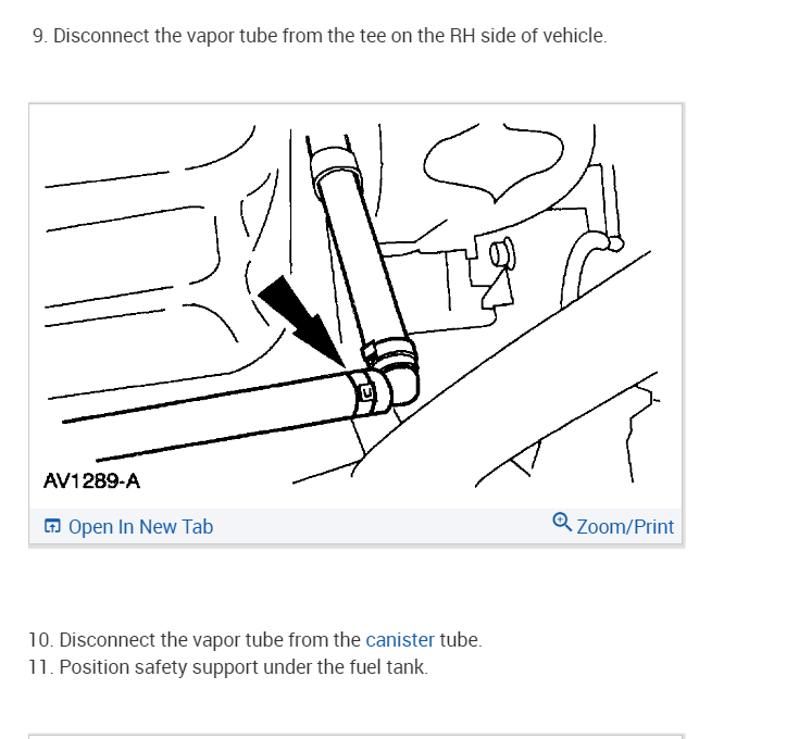

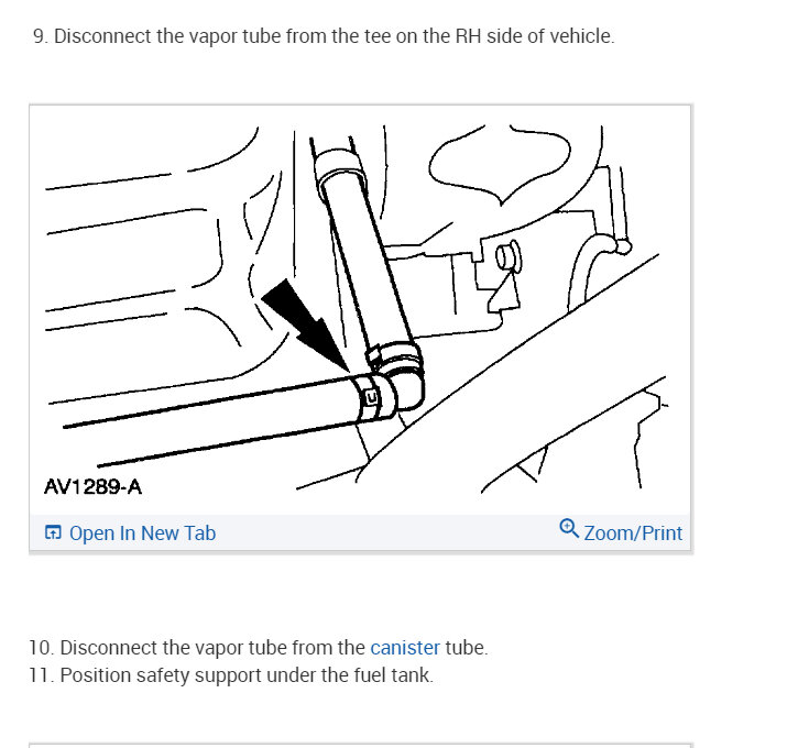

If the fuel pump has no pressure the engine will not start. This guide will show you how to check the pressure and you can rent a fuel gauge from the auto parts store for free or cheap and this guide will help you step by step.
Engine Running Fuel Pressure 210-310 kPa
Key On, Engine Off Fuel Pressure 240-310 kPa
This guide can help as well:
https://www.2carpros.com/articles/car-not-running-advanced

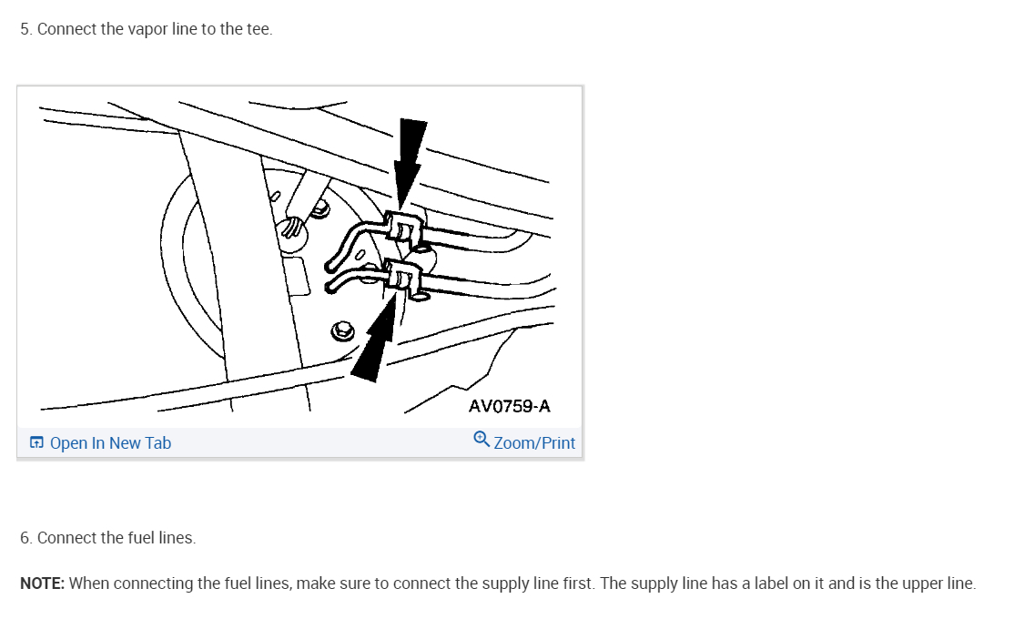

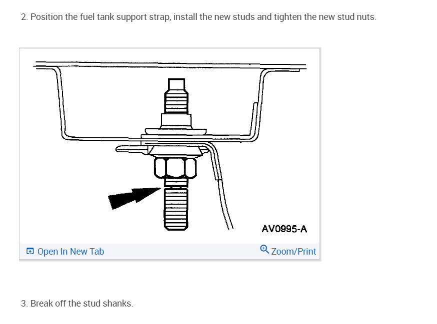

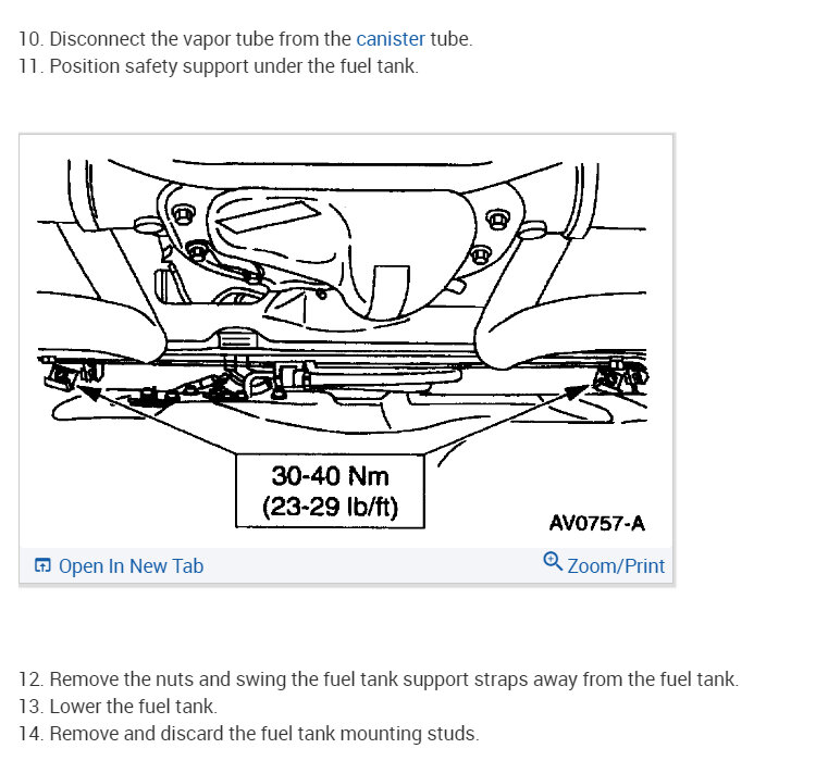

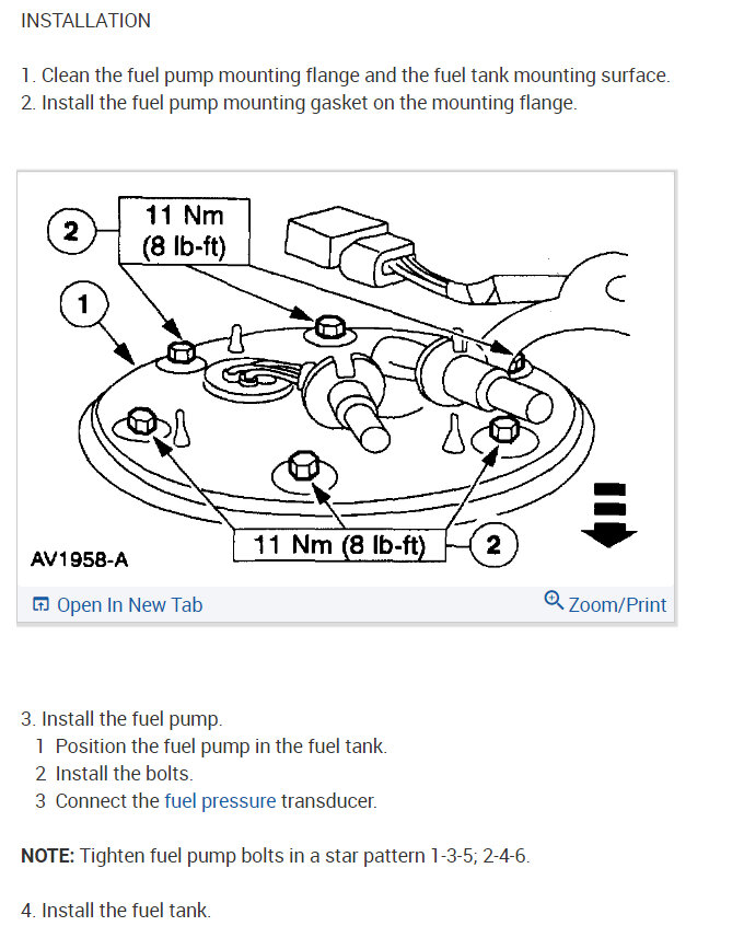

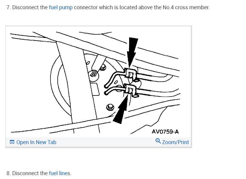

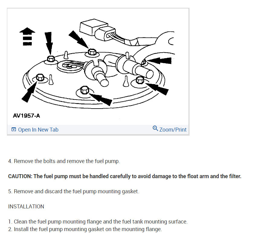

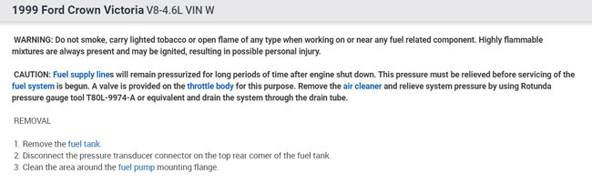

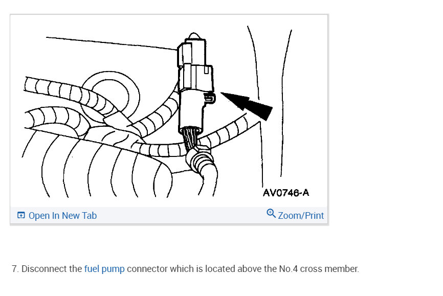

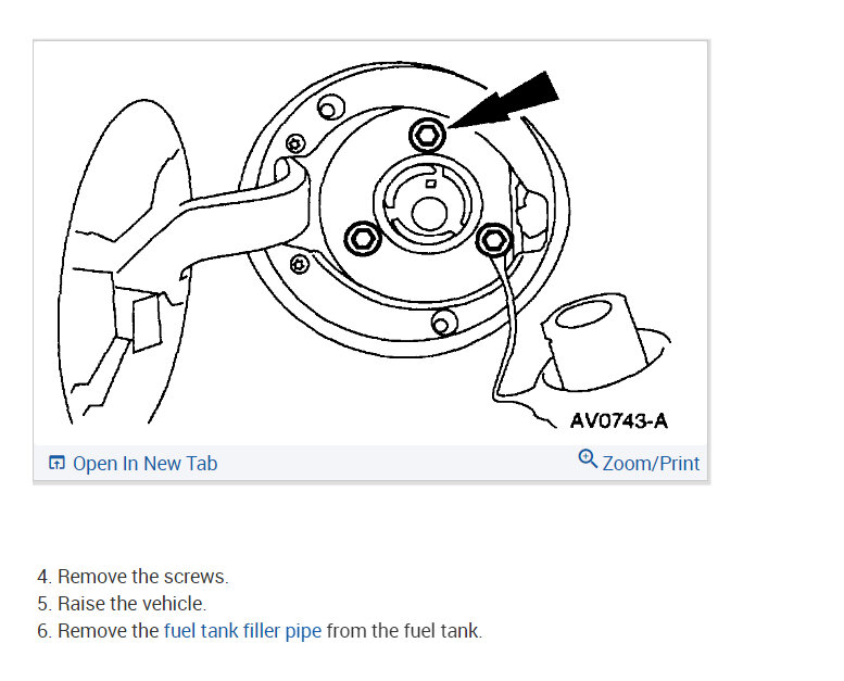

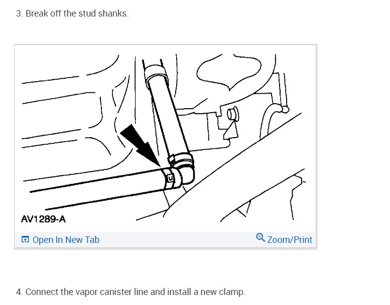

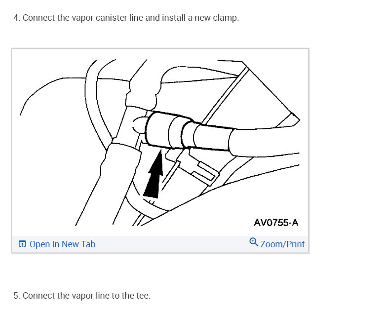

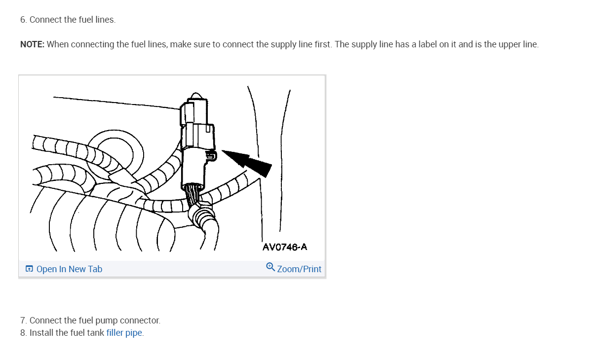

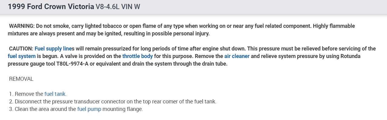

I have included how to change the fuel pump out in case you need it. You will need to drain the tank first, this video will help:
https://youtu.be/Q5MH2gnyFH0
Check out the images (below). Please let us know what you find. We are interested to see what it is.
