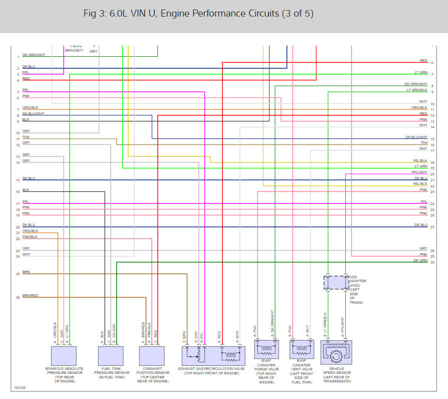

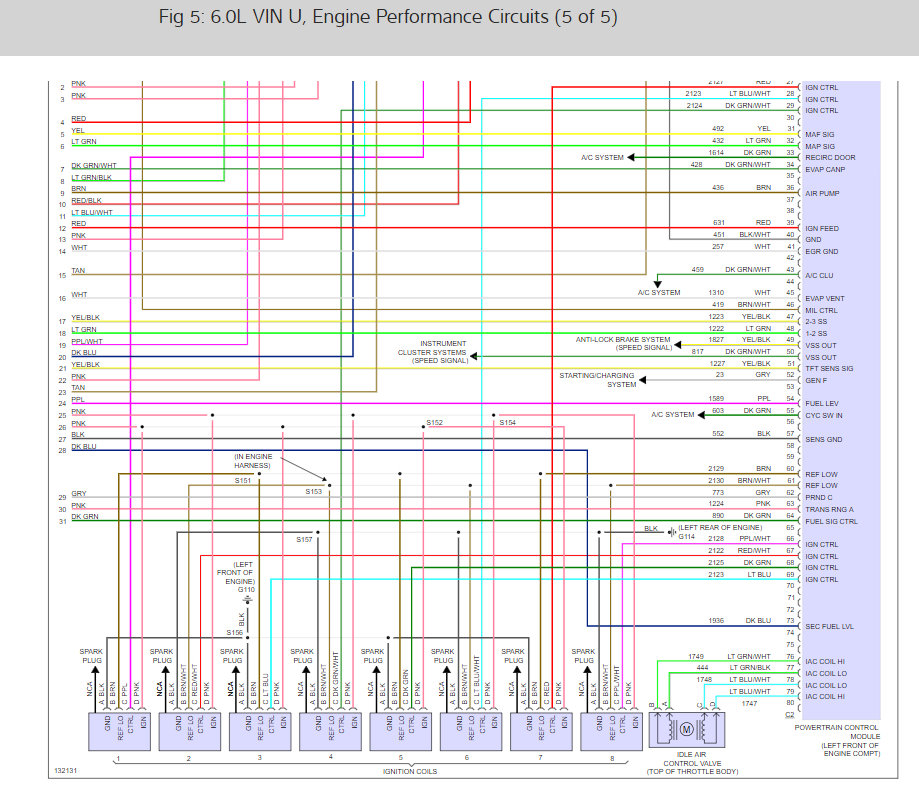

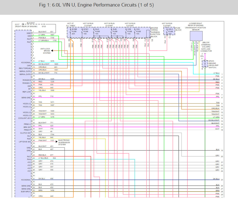

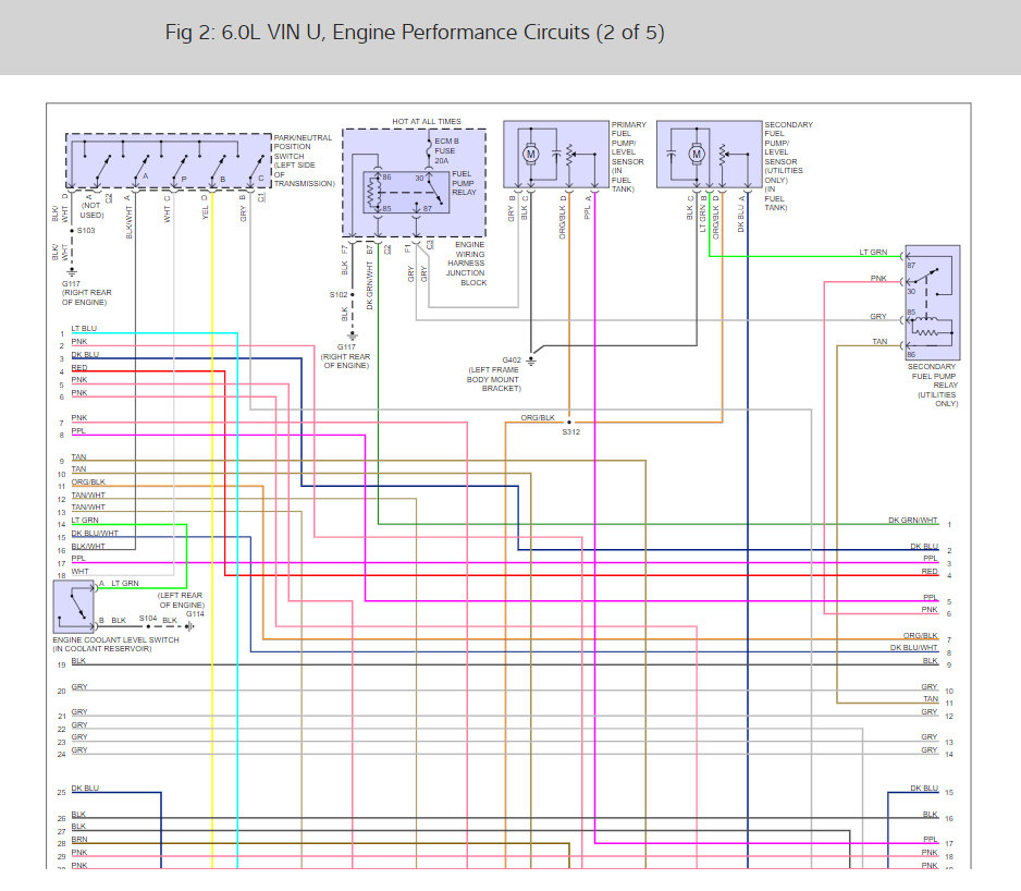

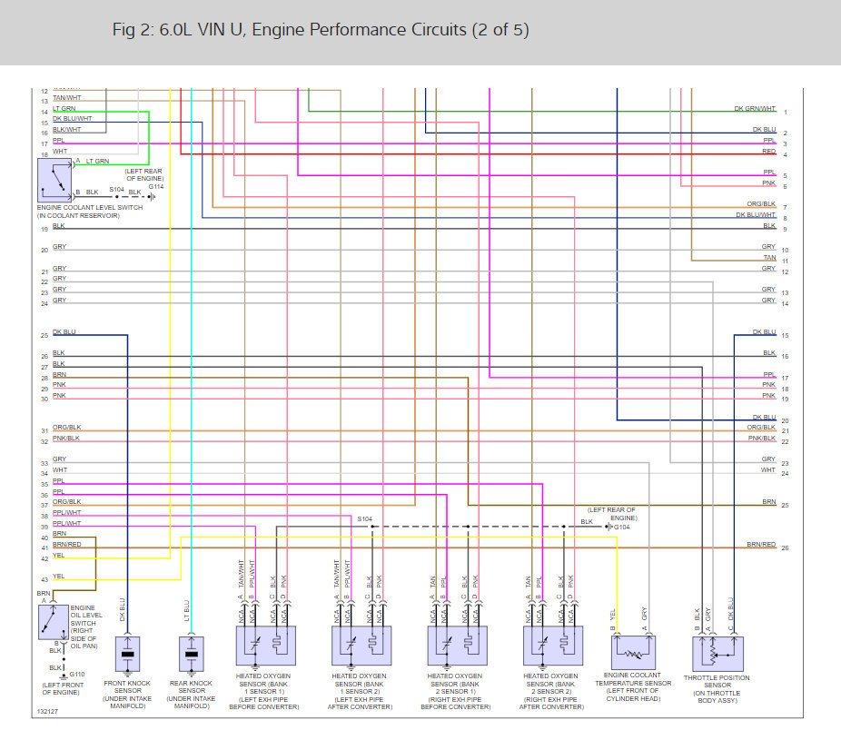

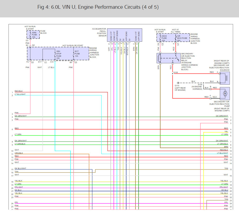

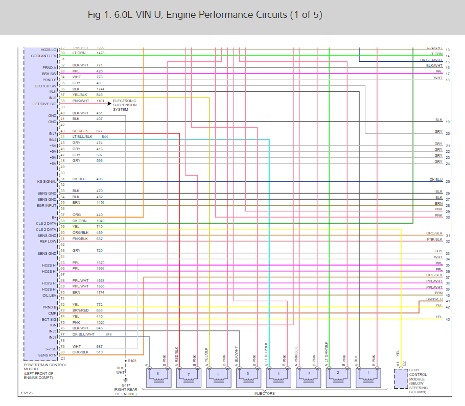

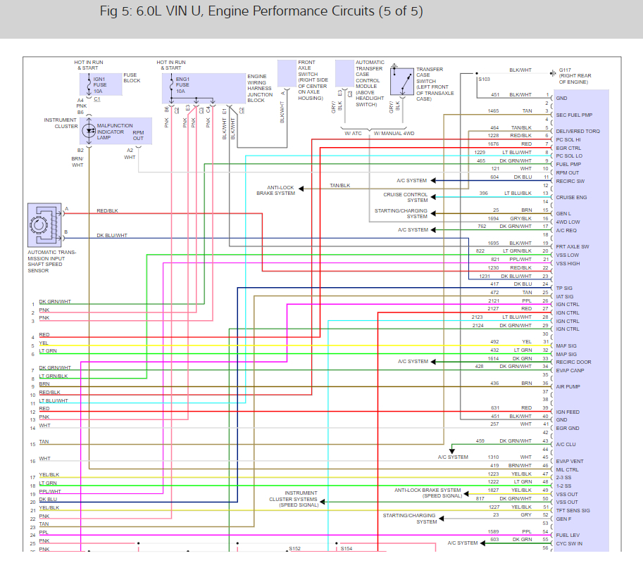

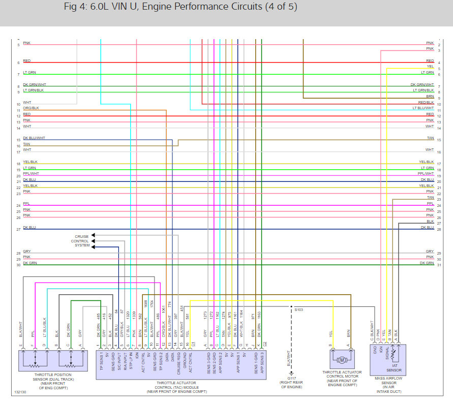

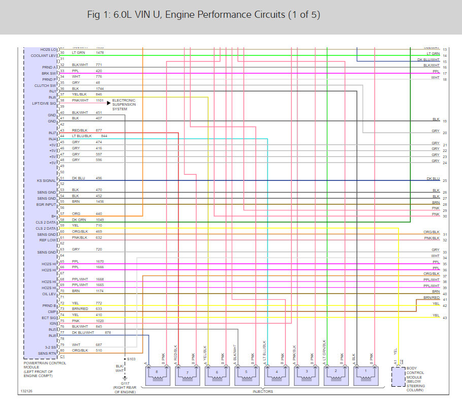

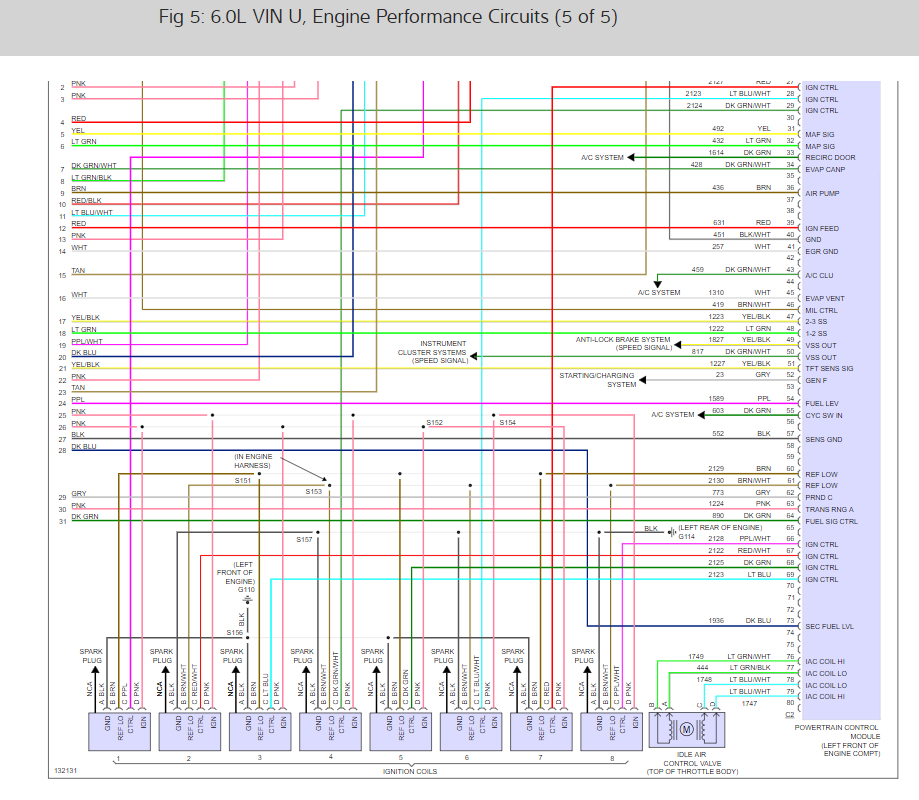

The ICM and PCM work together you might have a bad PCM. Here is a guide so you can check the wiring with the engine wiring diagrams below:
Jun 5, 2021 at 2:48 PM
JEANSIMMONS993
  • 14 POSTS
the pink wire is showing continuity to the ground from the PCM.
