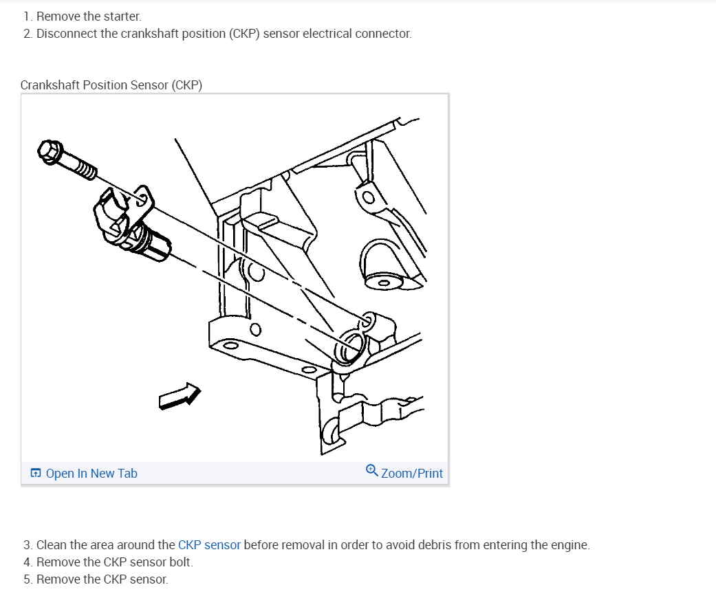

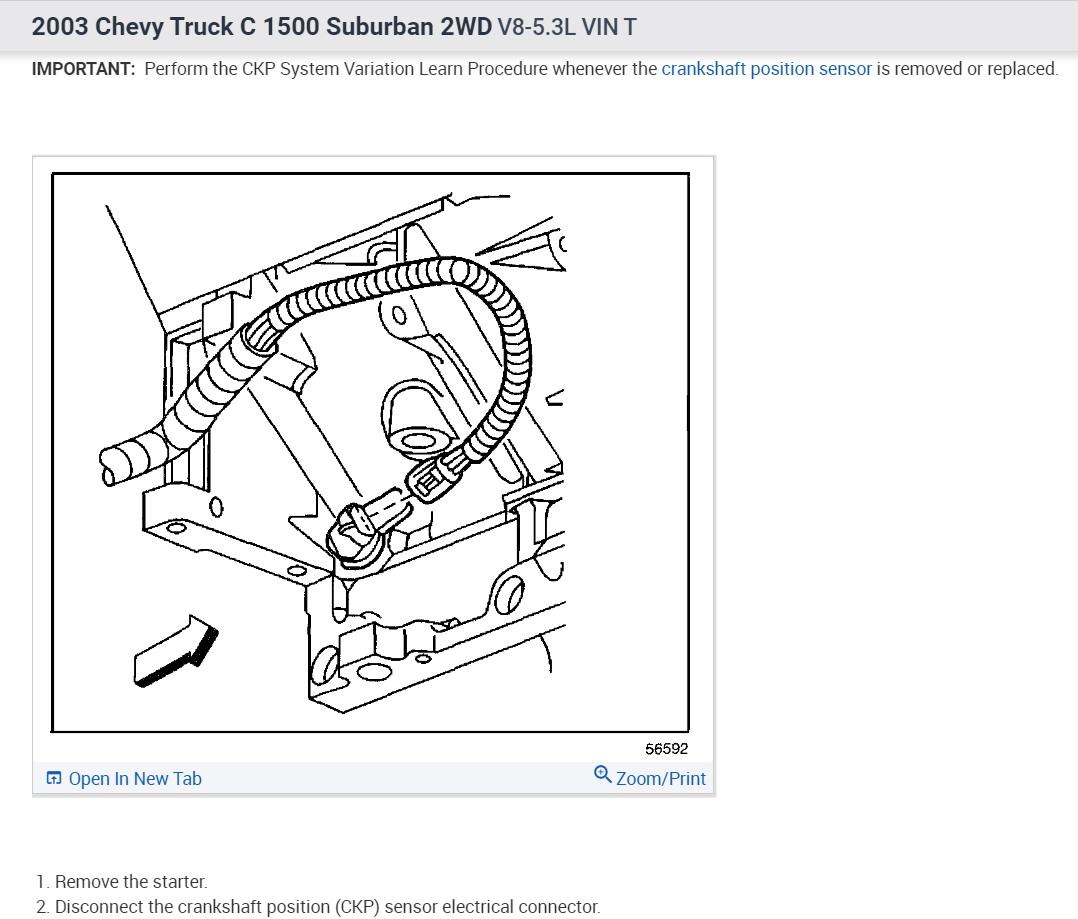

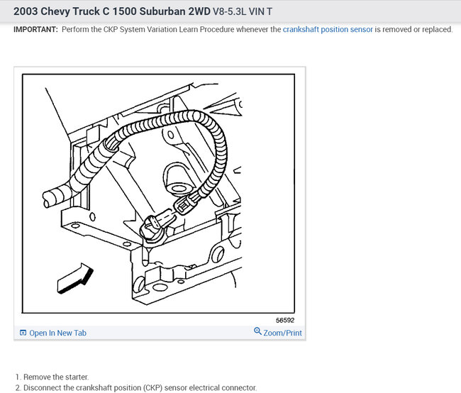

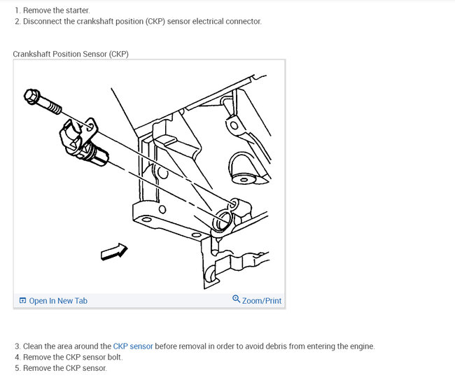

The crankshaft angle sensor is near the starter. Can you check the wiring connection at the sensor please? Here is the location of the sensor so you can check it out. Check out the images (below). Let us know what happens and please upload pictures or videos of the problem so we can see what's going on.
