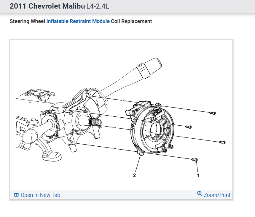

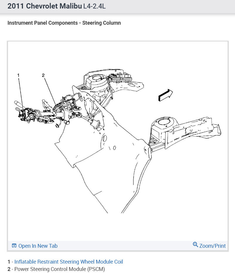

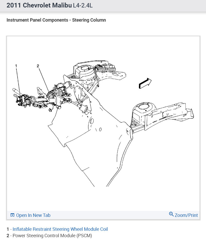

This sounds like the clock spring behind the steering wheel is out which is common. To be sure lets do a CAN scan to see what comes up. here is a video that shows what to do:
https://youtu.be/InIlnsjOVFA

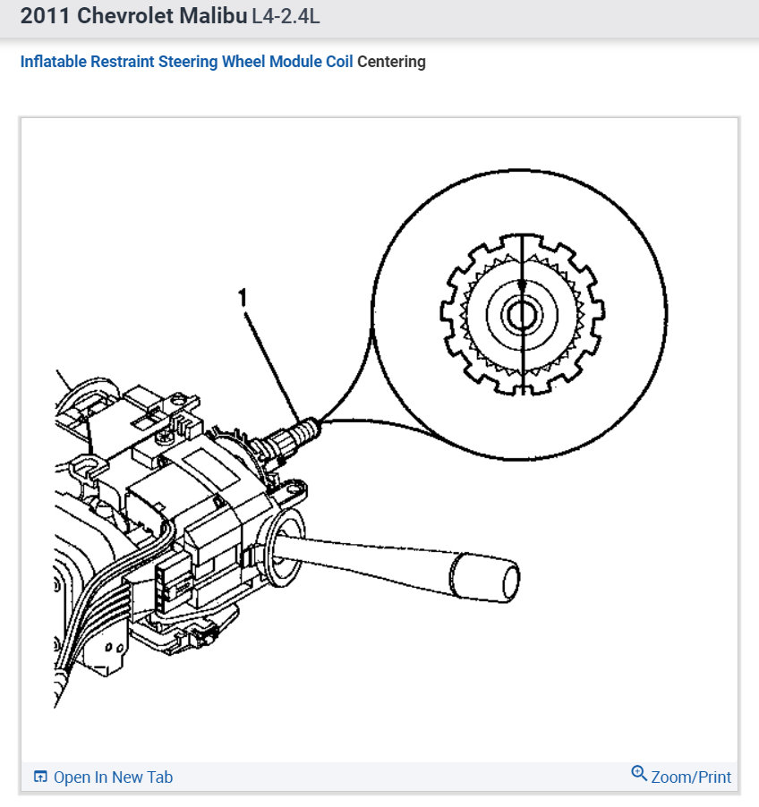

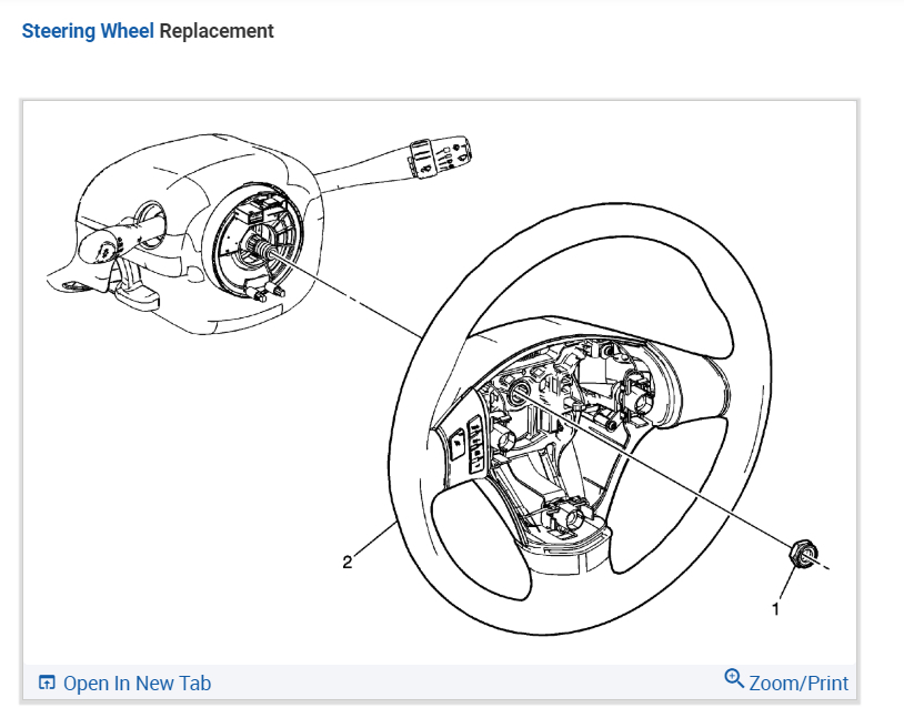

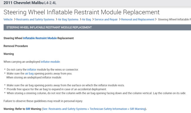

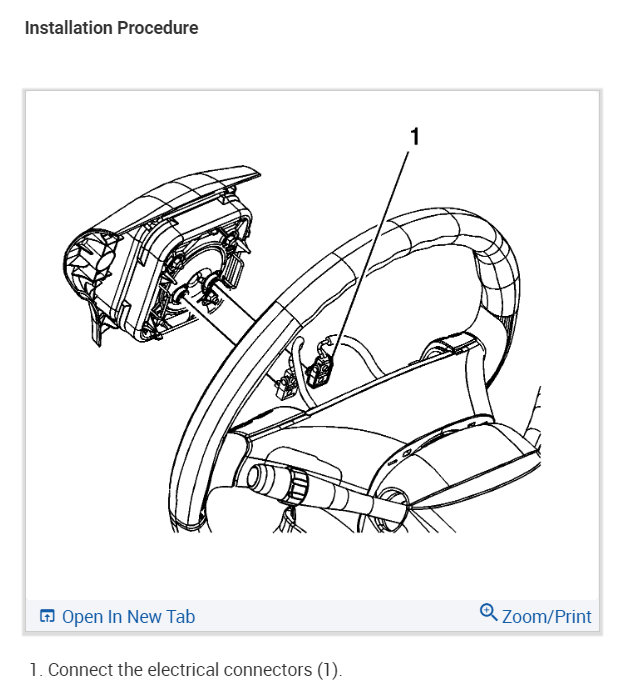

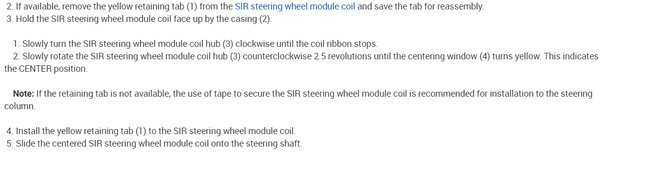

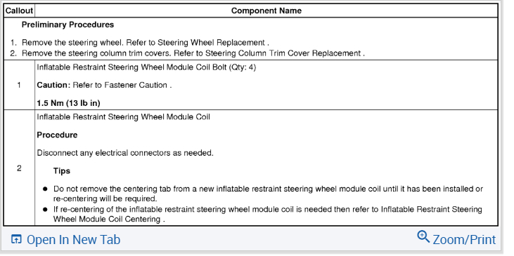

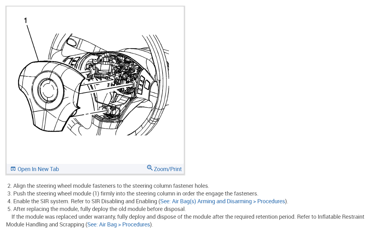

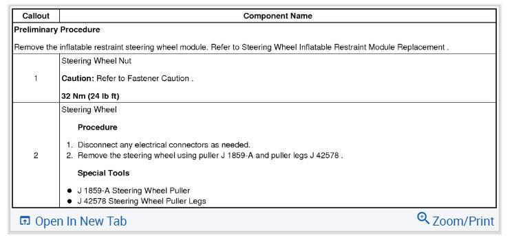

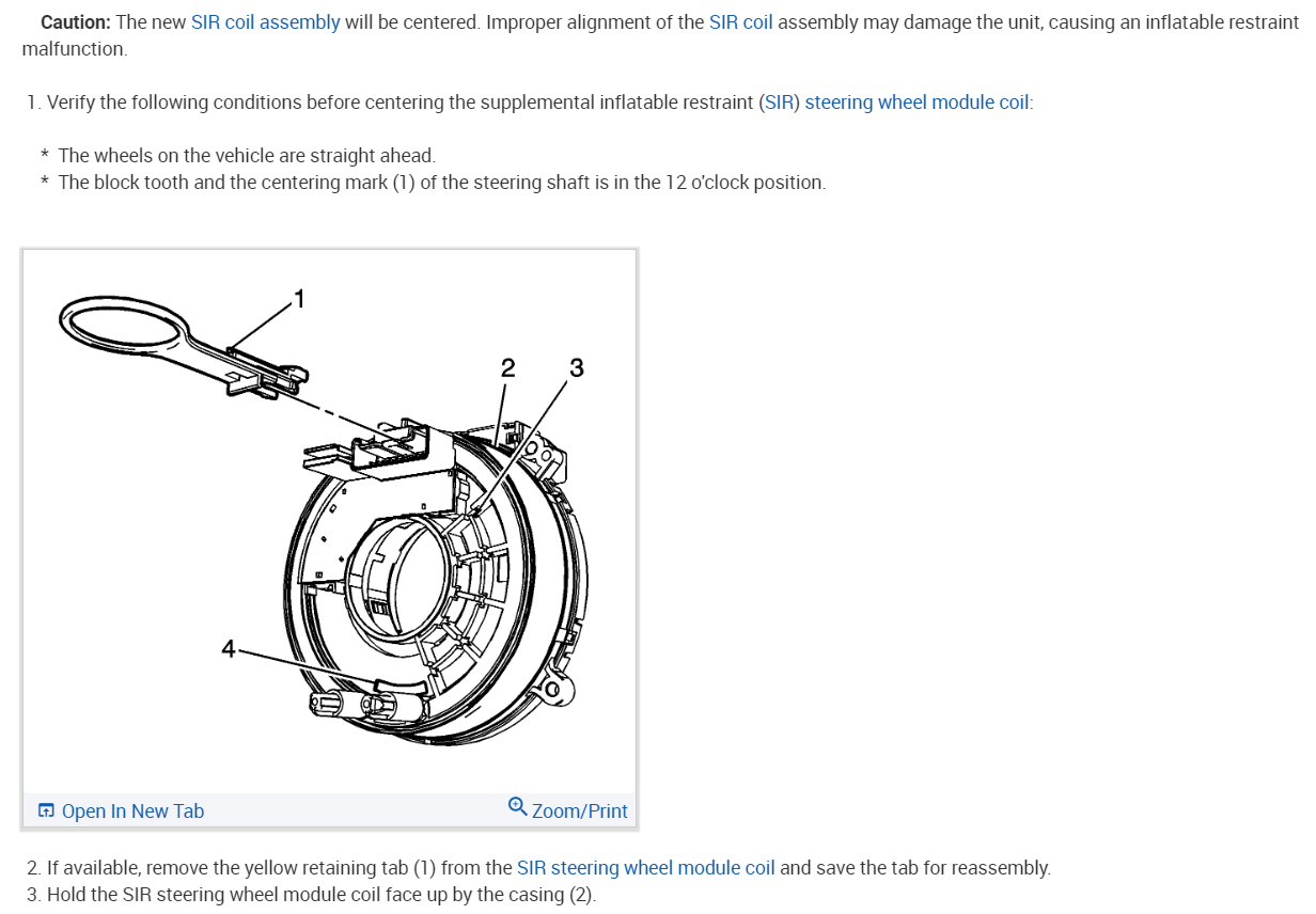

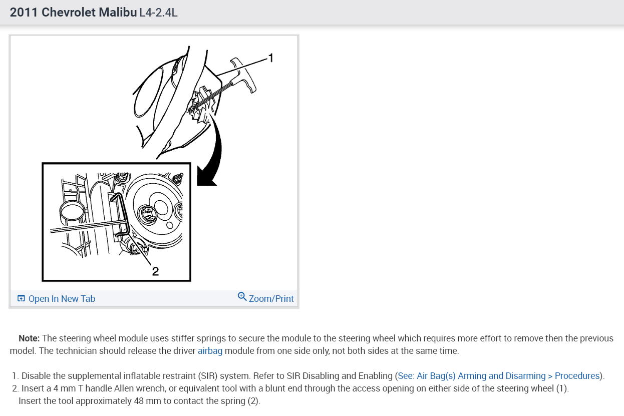

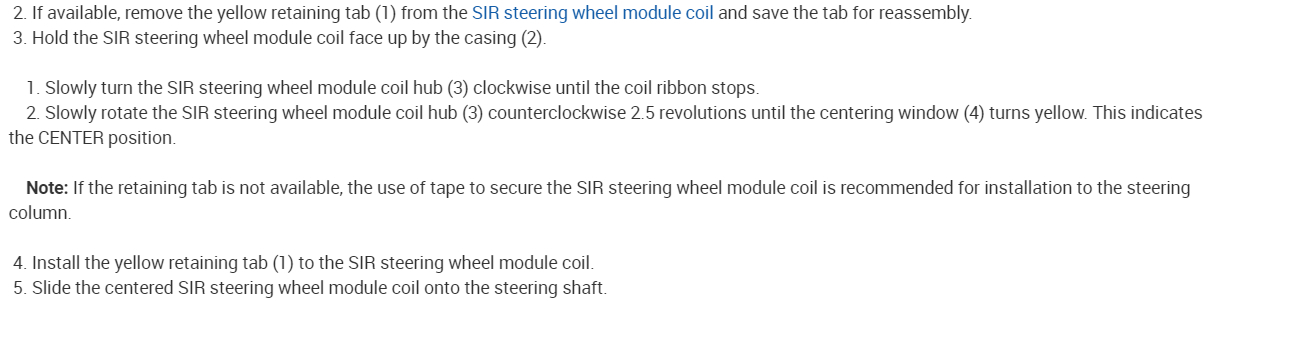

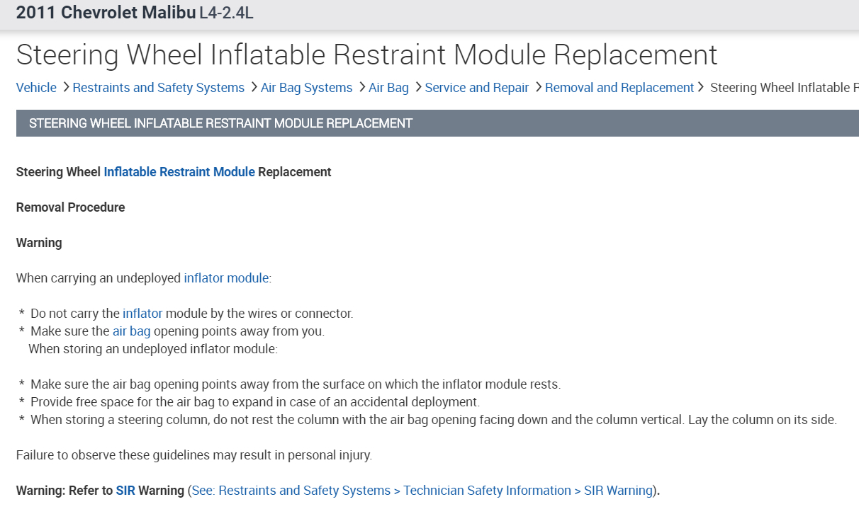

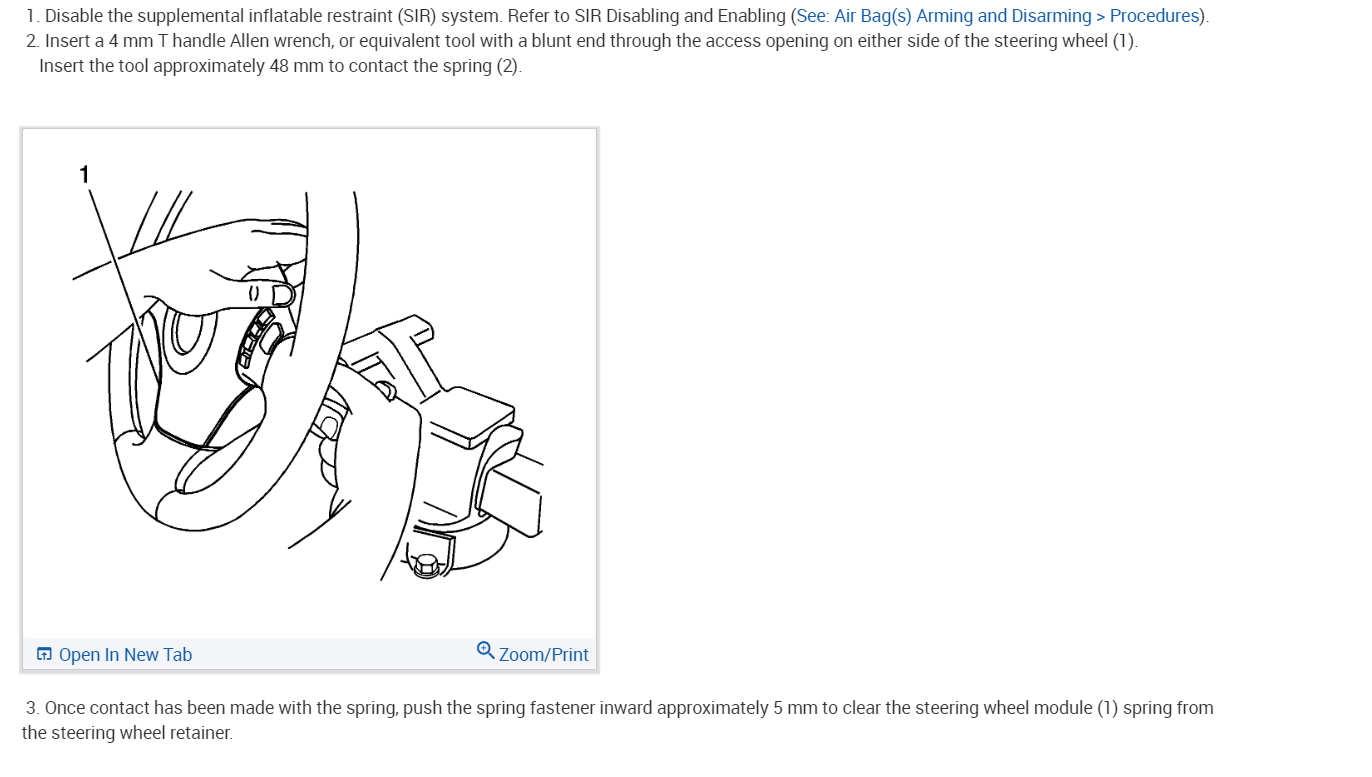

Here are the instructions on how to change out the clock spring in case this is what it turns out to be. can I ask if any work to the steering has been done lately?
