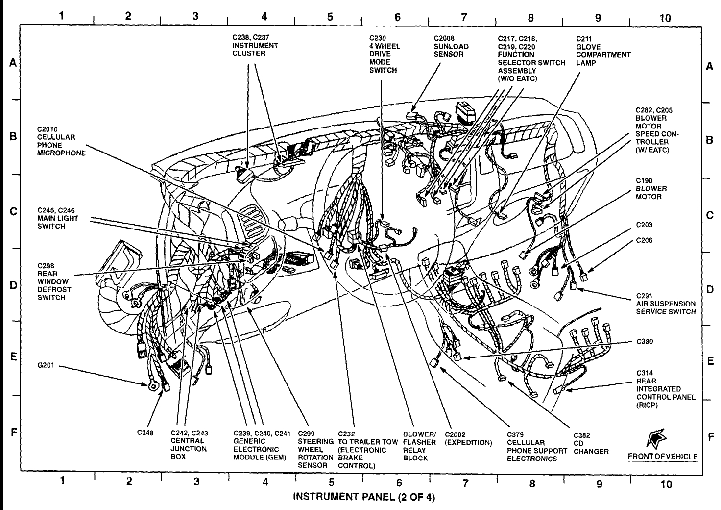

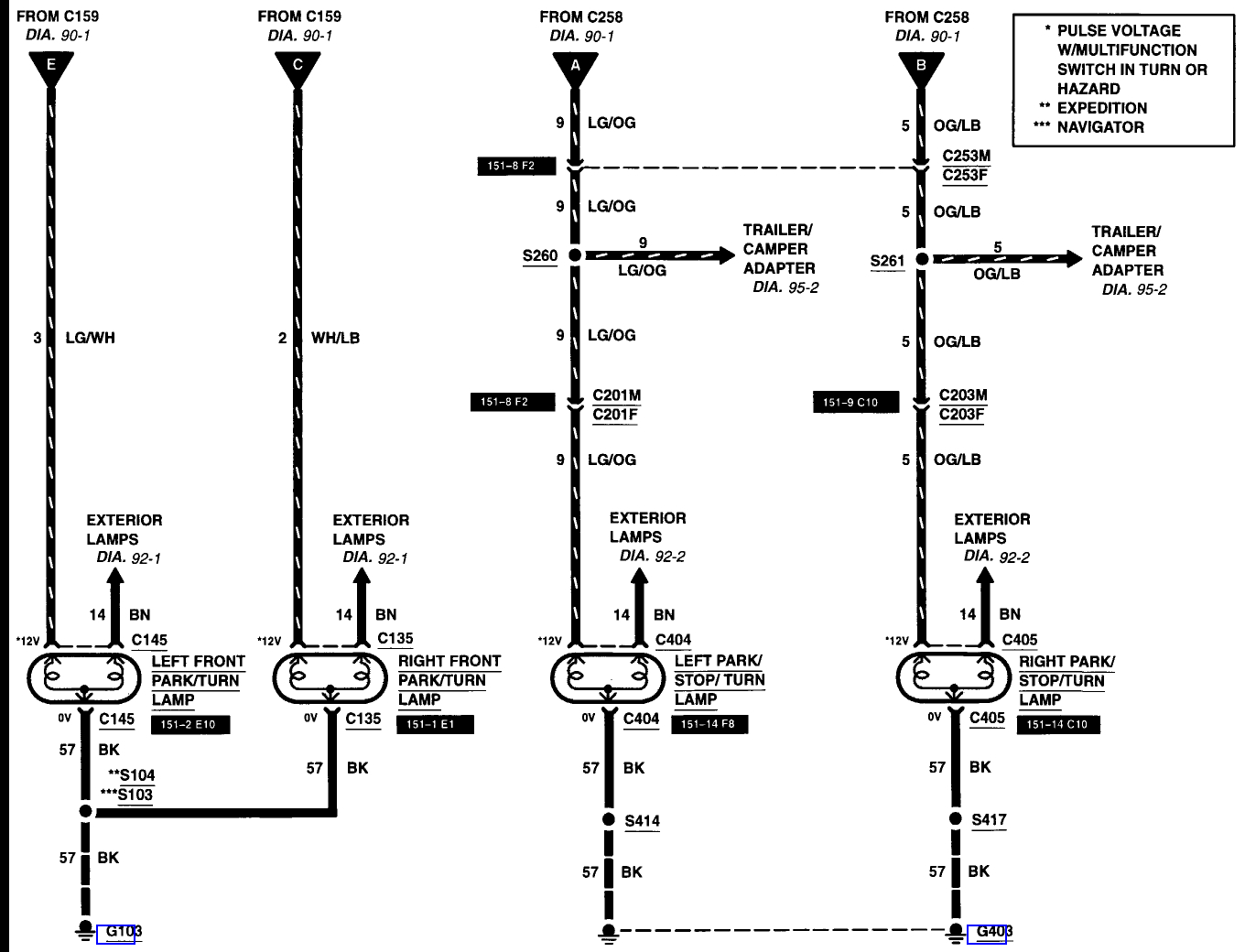

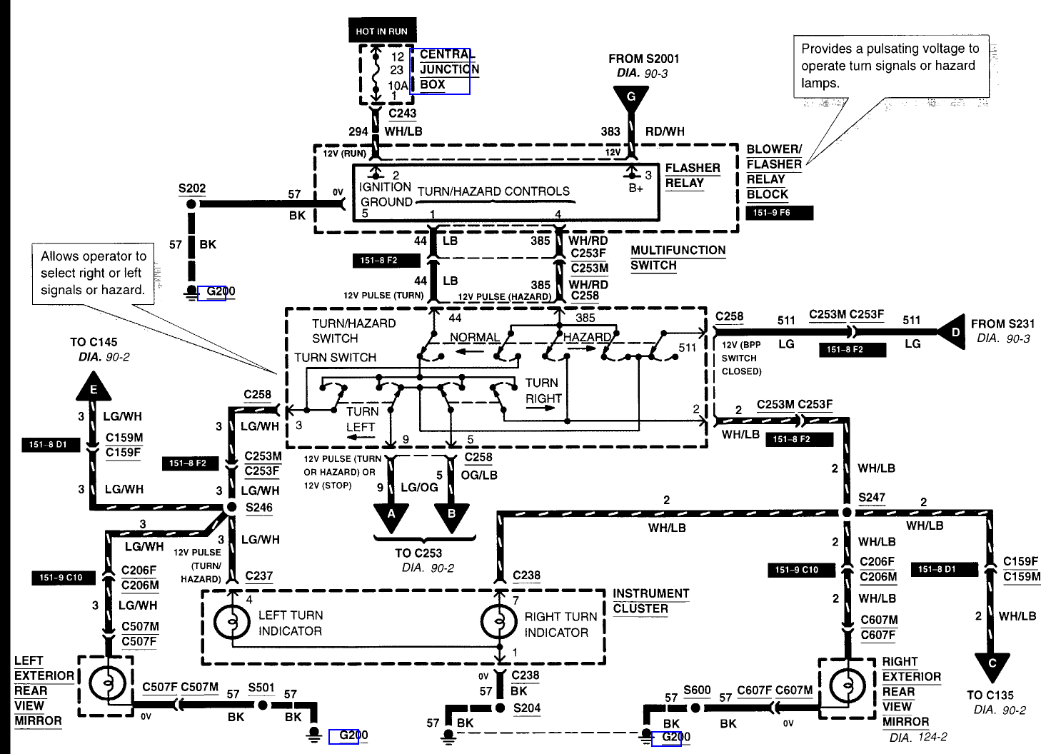

my turning signals/hazards are not working, will not turn on. I have no idea how to read the relay map. not sure which one to check, checked the fuse and it is good. help I am a nurse not a mechanic.
