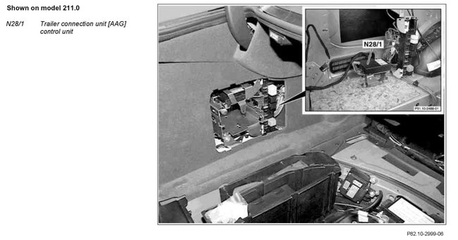

The trailer control unit could be out here is the location below. Let us know what happens and please upload pictures or videos of the problem.
