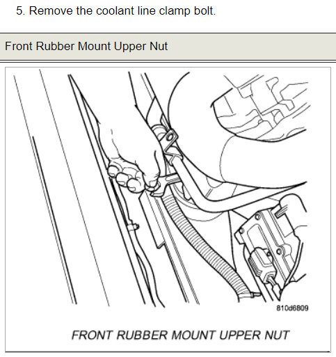

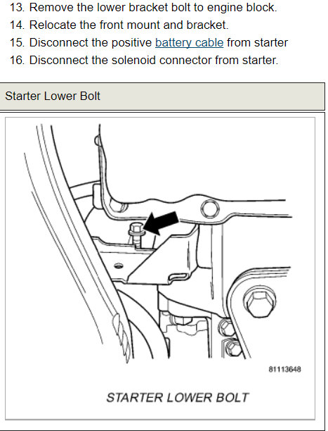

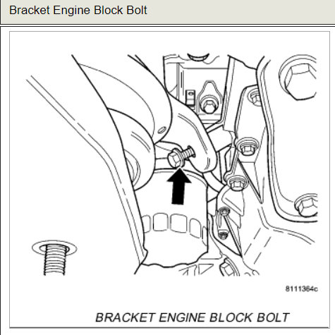

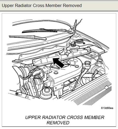

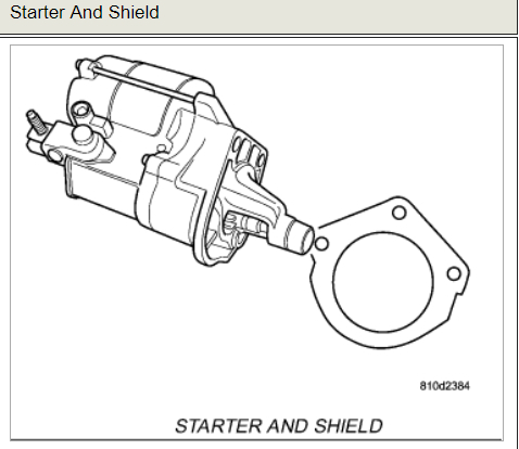

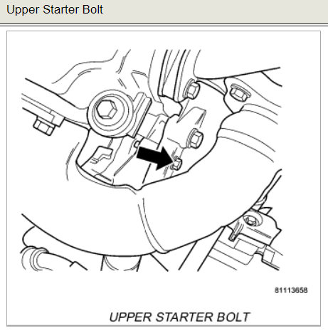

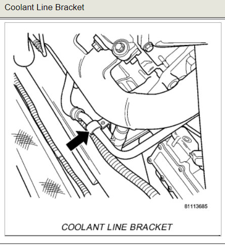

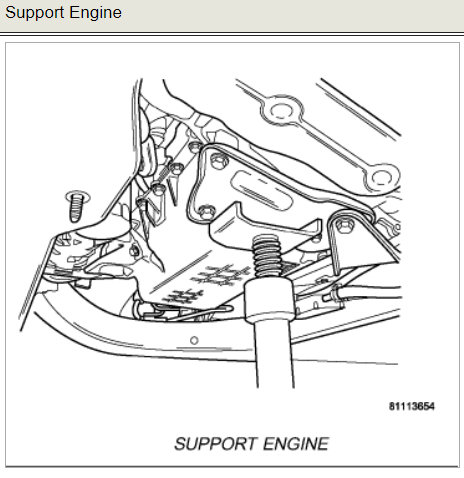

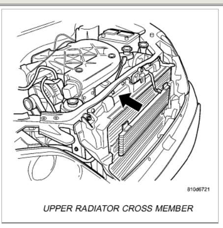

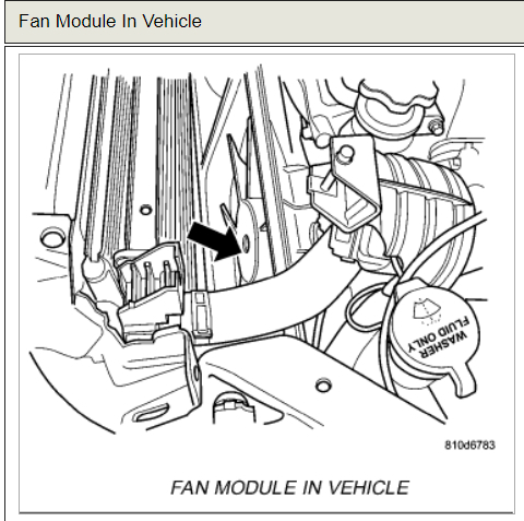

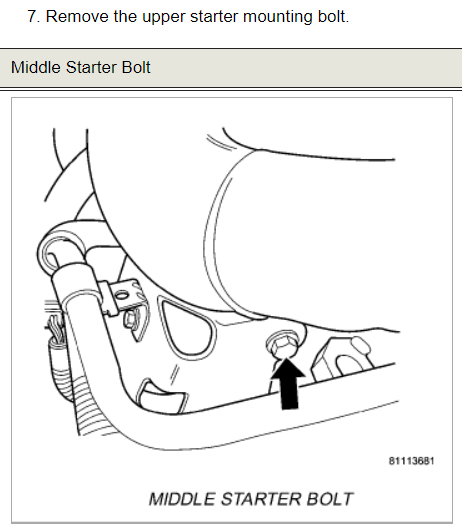

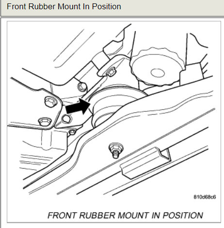

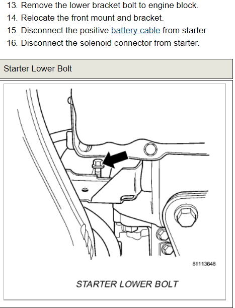

It sounds like you have a bad starter motor or a bad connection at the battery. Here is a guide to help you see what you are in for when fixing the problem:
and

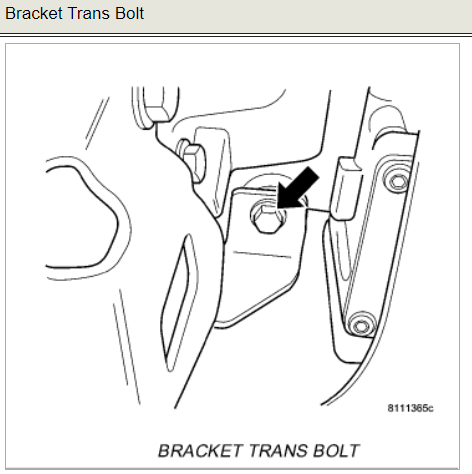

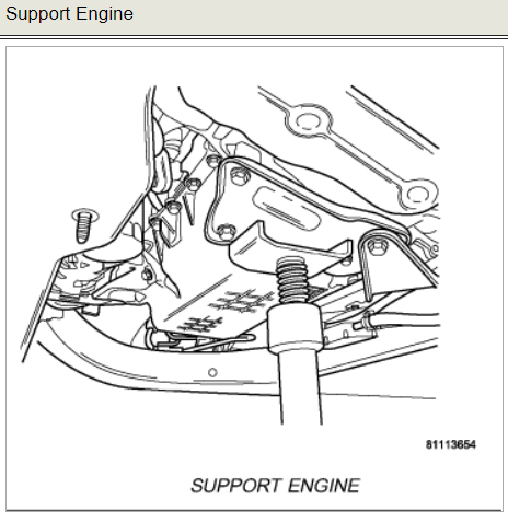

Below is how it will be to replace the starter in your car.
Feb 4, 2018 at 12:43 PM
