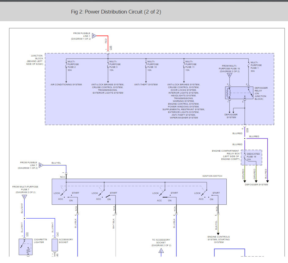

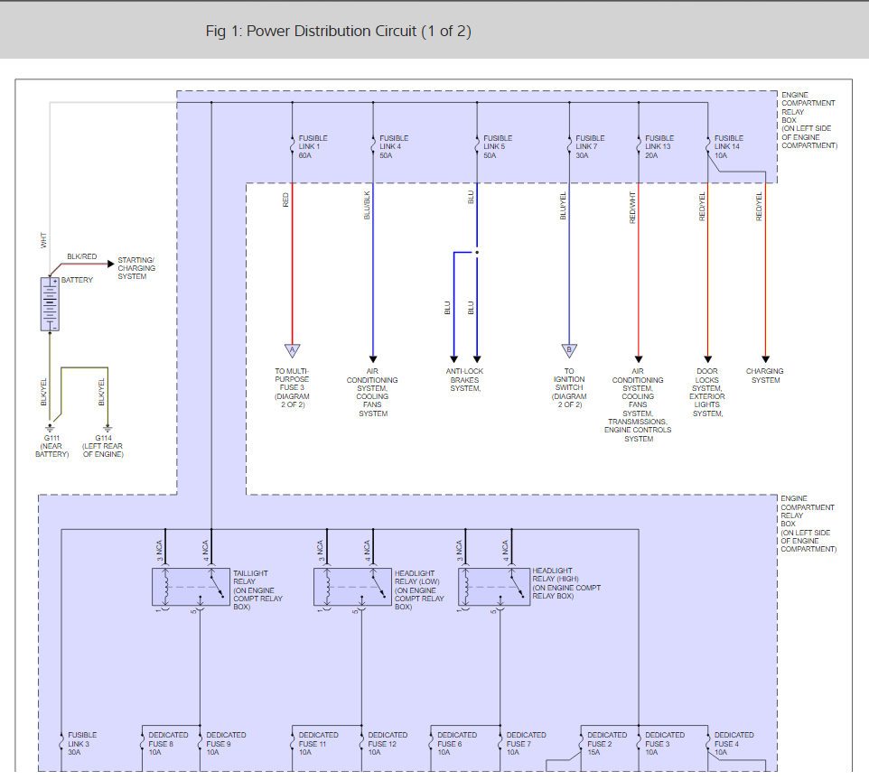

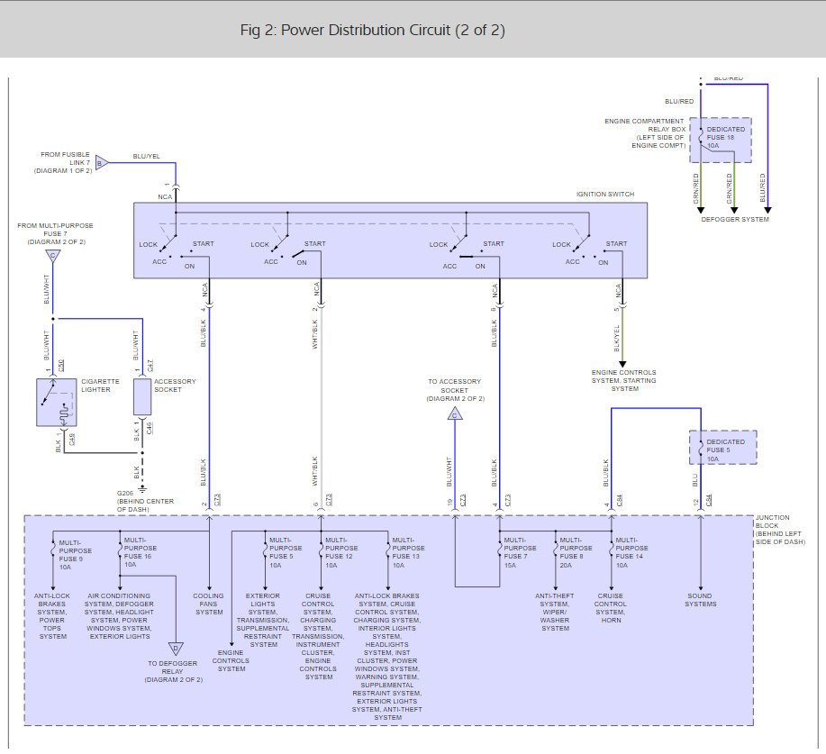

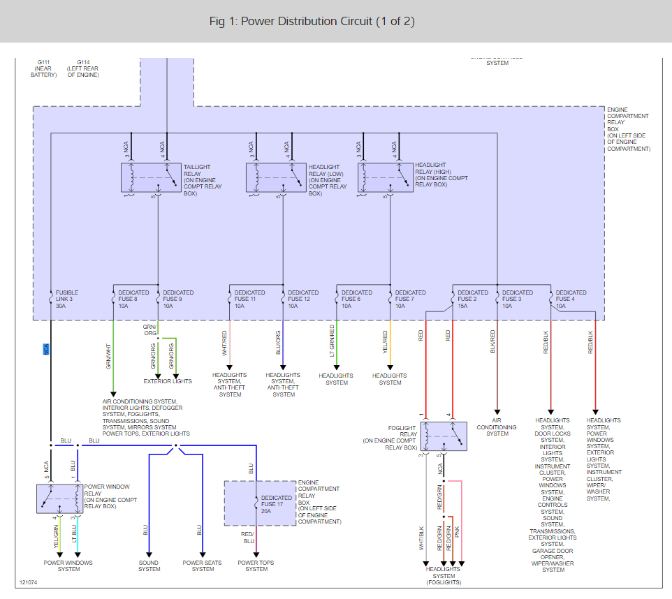

The starter went bad So i replaced it. When the key is in the ignition and to the start position there are no warning lights at all on the dash, just the chime that the key is in the ignition. I have check all battery connections and relays and fuses and still have only about four or five fuses that get power.
