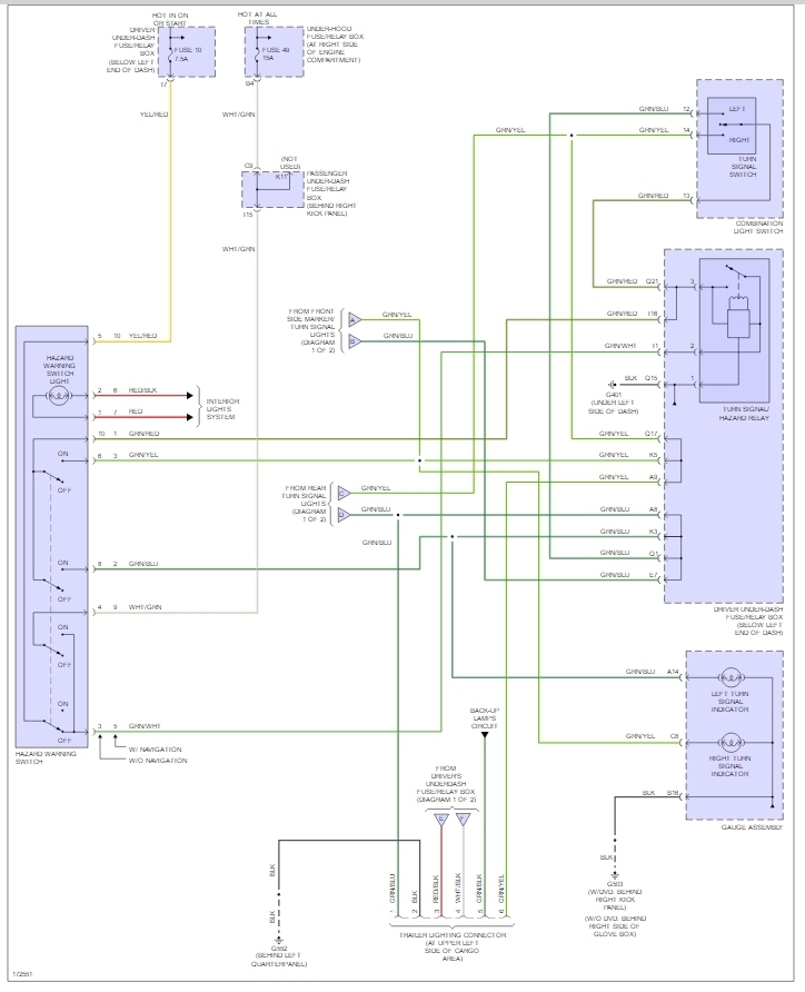

The problem started when the radio shorted out, the kids had put coins in the cd player. I disconnected the radio. the turn signals and warning flasher quit working. I checked all the fuses on driver and passenger sides, all were okay. I checked all fuses and relays under hood, all were okay. I replace the turn signal flasher, the emergency flasher switch and the combination headlight/turn signal switch on the steering column. The headlights and brake lights are working, but all of the others are not working. I AM LOST; PLEASE HELP ME WITH SOME KIND OF DIRECTION.

It looks like the turn signal hazard relay has gone bad, here is a wiring diagram to show you the location.
Let me know what you find
