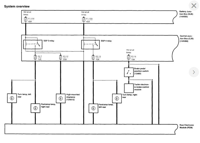

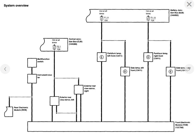

Lights flash rapidly turn signals don't work. fuses okay.
