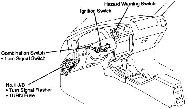

If you confirm that power is getting to the fuse and through it, the next thing you need to do is follow this diagnostic test. The attached pictures correlate with the directions,

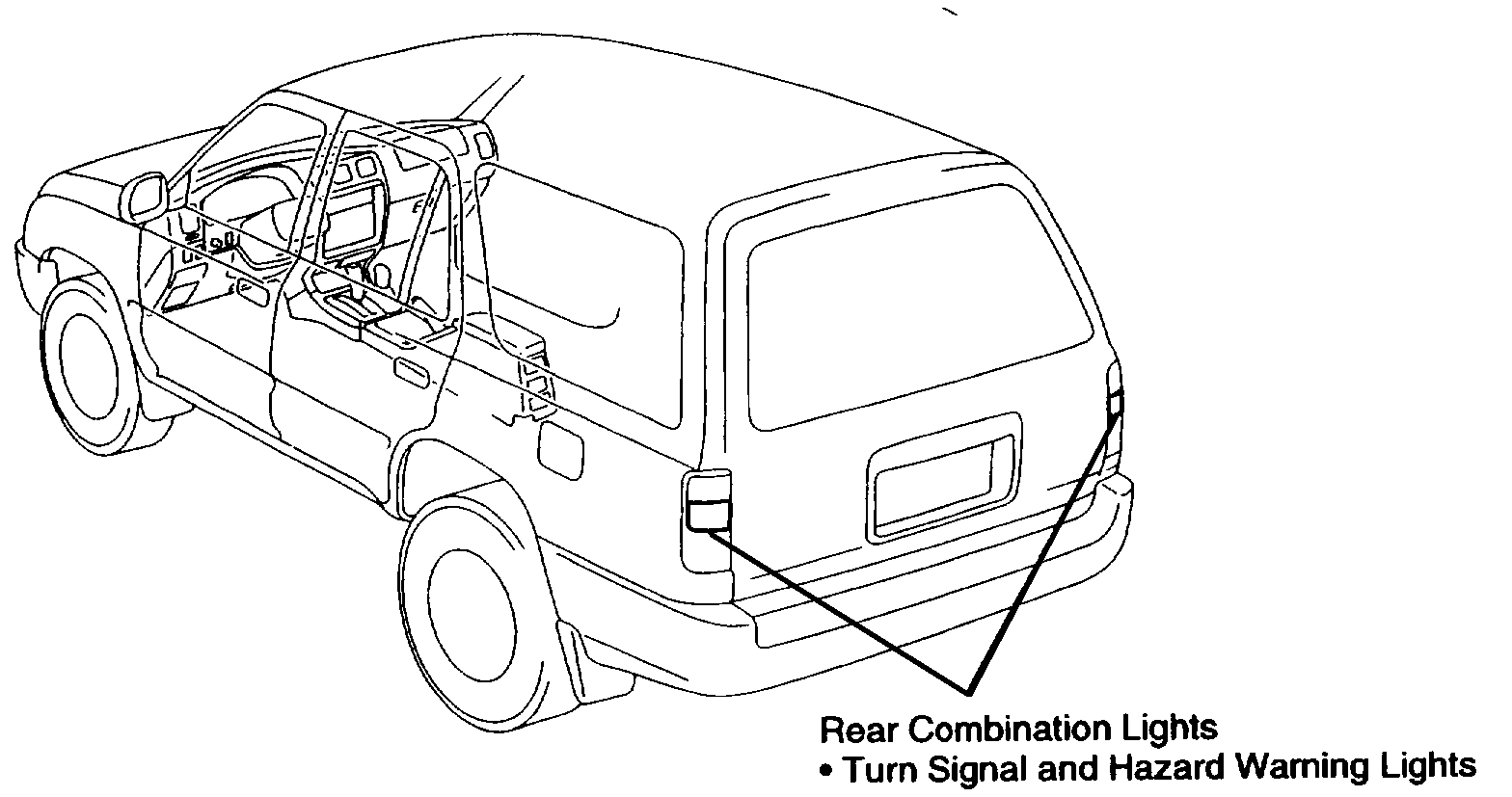

Turn Signal & Hazard Warning System Location
See Pic 1

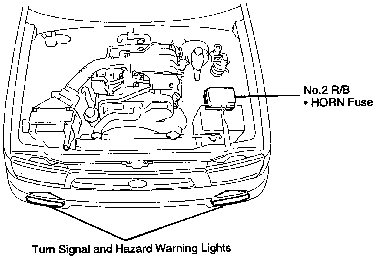

See Pic 2

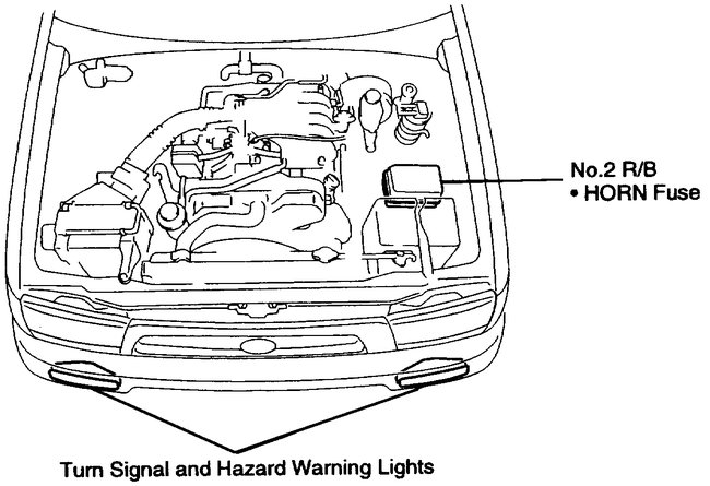

See Pic 3

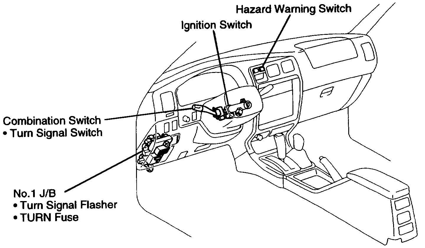

Turn Signal
See Pic 4

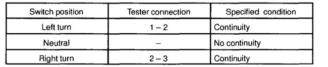

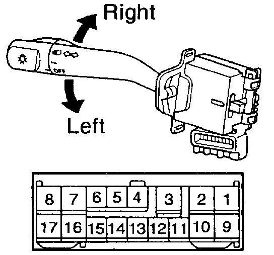

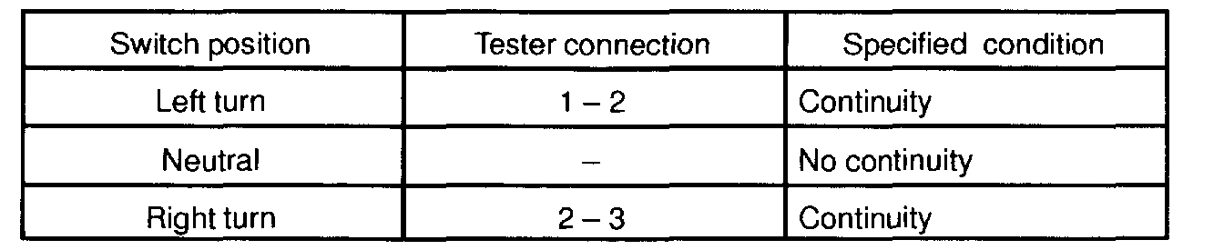

See Pic 5 Continuity pin locations
INSPECT TURN SIGNAL SWITCH CONTINUITY
If continuity is not as specified, replace the switch.
