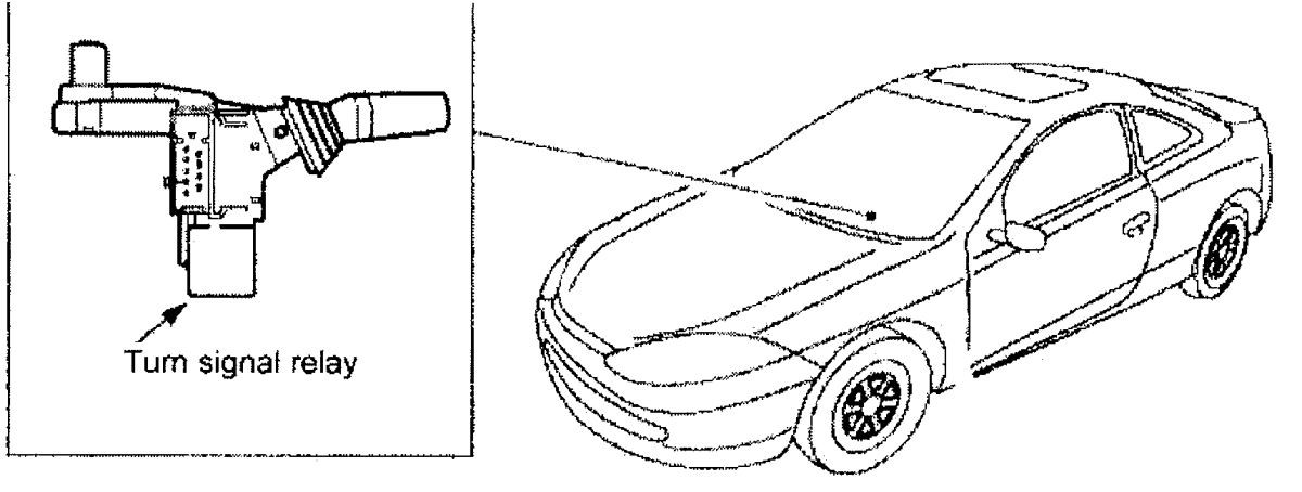

Hello. The likely cause is a failed turn signal/hazard relay. Apparently, this is located inside the steering column, mounted to the turn signal switch. Ford does not make it clear to us whether or not there is an access panel, so you will have to look for yourself. I am attaching the image that Ford has provided us.
