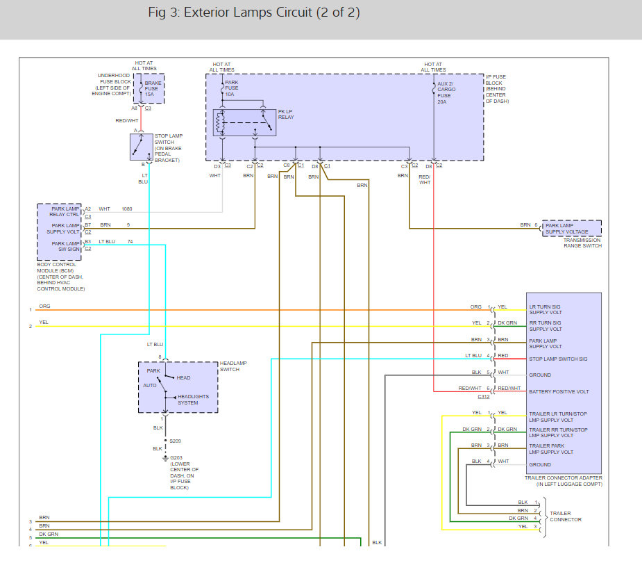

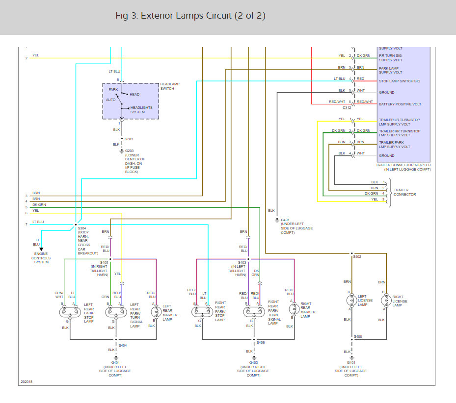

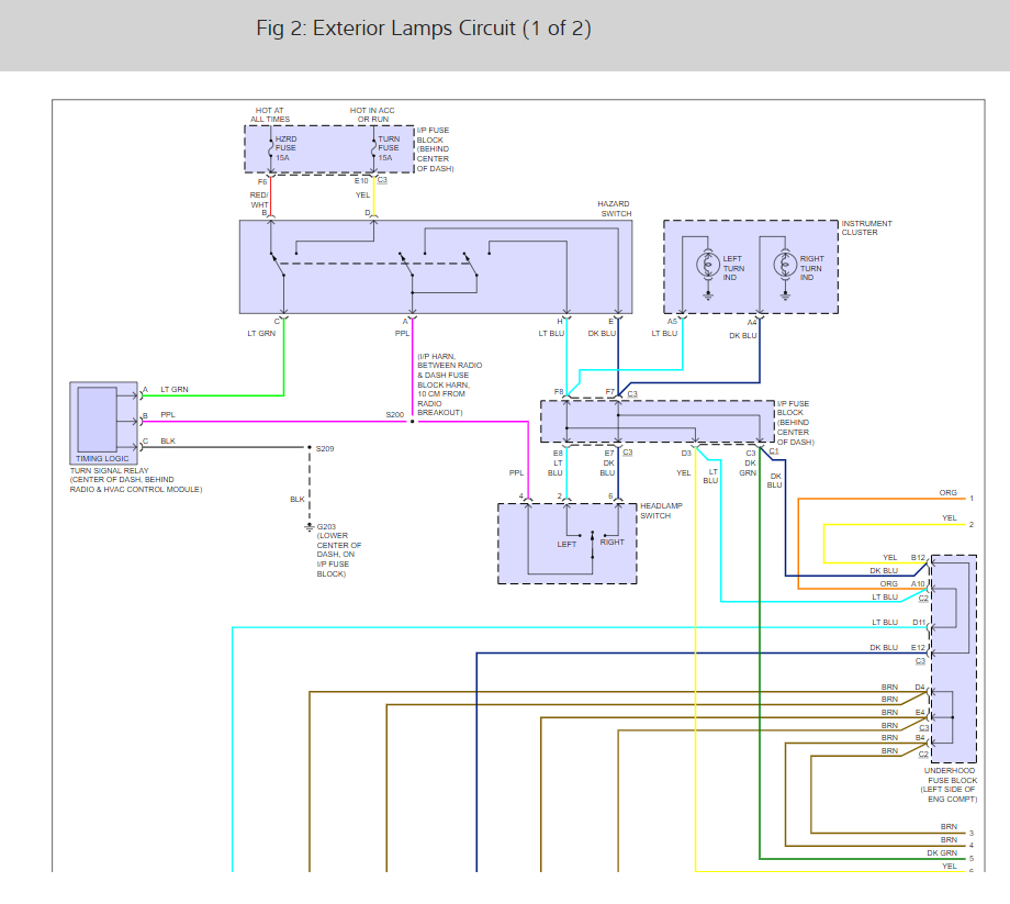

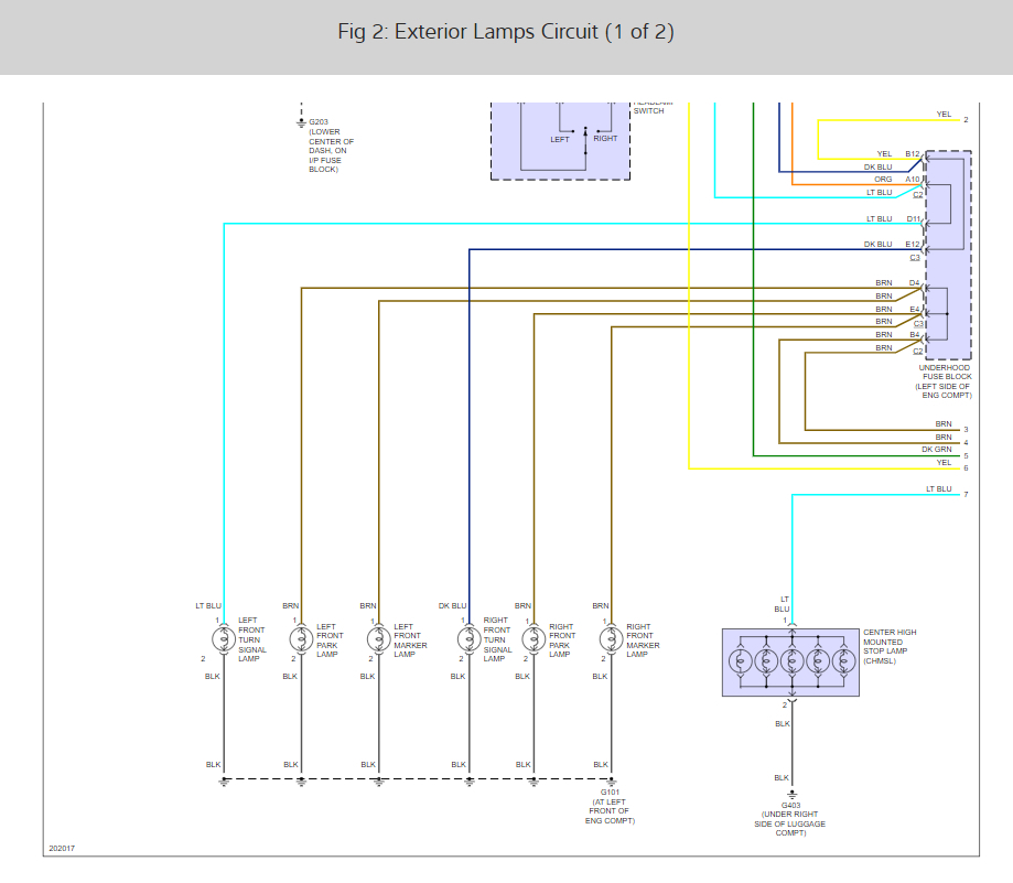

It sounds like you may have at trailer connector that is shorted out. here is a guide to help you test the wiring and the blinker wiring diagrams below so you can see how the system works:
