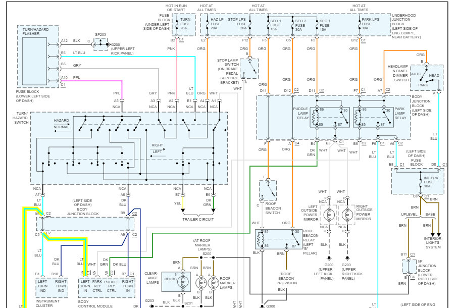

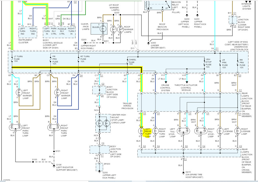

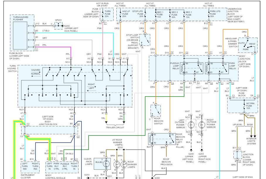

I attached the wiring schematic below related to exterior wiring. I have a question. Does the vehicle have a trailer wiring harness? If it does, disconnect it and see if the problem stops.
If there isn't one, you replaced the flasher, and nothing happens out of the ordinary with the right signal, my first suspect would have been the switch. However, if there was a short to power, it would happen when you used the right signals as well. Also, the front bulb would light up as well as the rear because the wiring is tied together (front/rear) I'm thinking there is a problem with the junction block in front of the rear bumper and mounted to the cross member. If there is some issue there, that would potentially eliminate the front right from flashing with the right rear. Ugh. This is an odd one.
Check the box and let me know what you find. Also, inspect the wiring to and from the box for evidence of damage.
