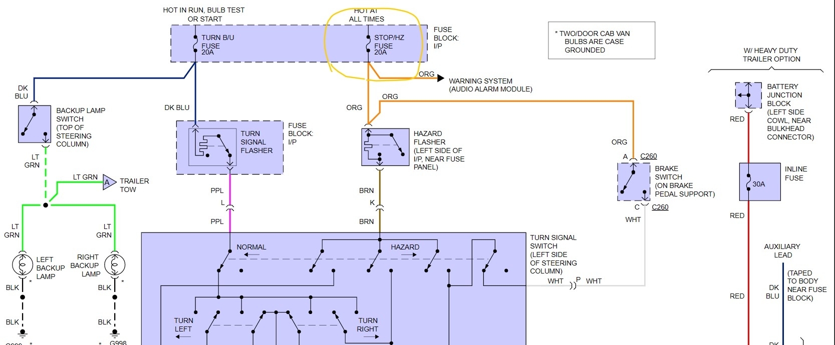

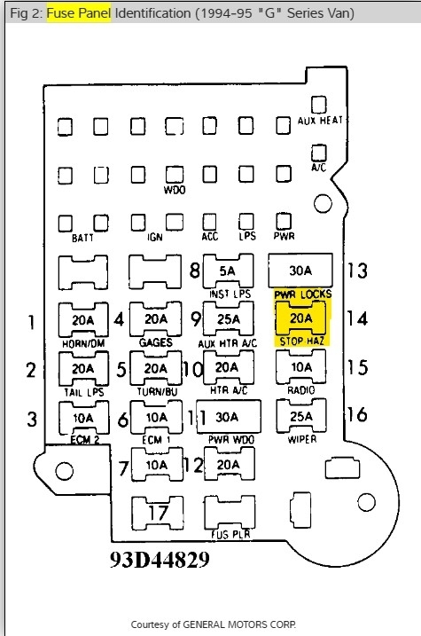

I would check the fuse first. I am adding a wiring diagram for you for the exterior lights. It shows there is a 20-amp fuse for this circuit. I have also added a diagram of you fuse box according to the info I have.
It doesn't give me a location for this panel except for by the instrument cluster but I believe it is under the steering column to the left on the firewall.
