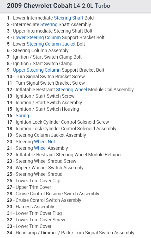

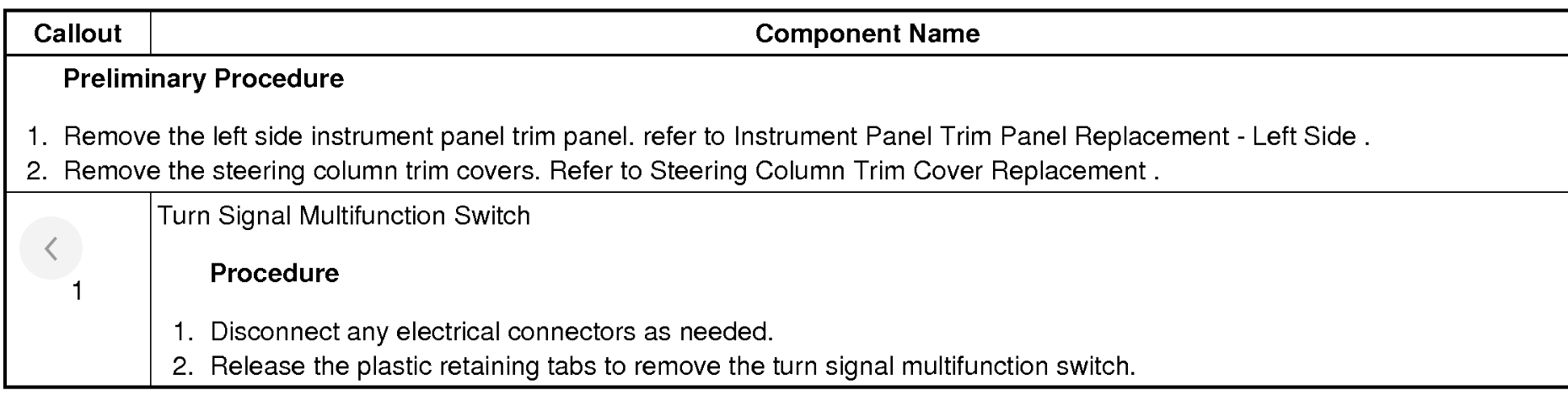

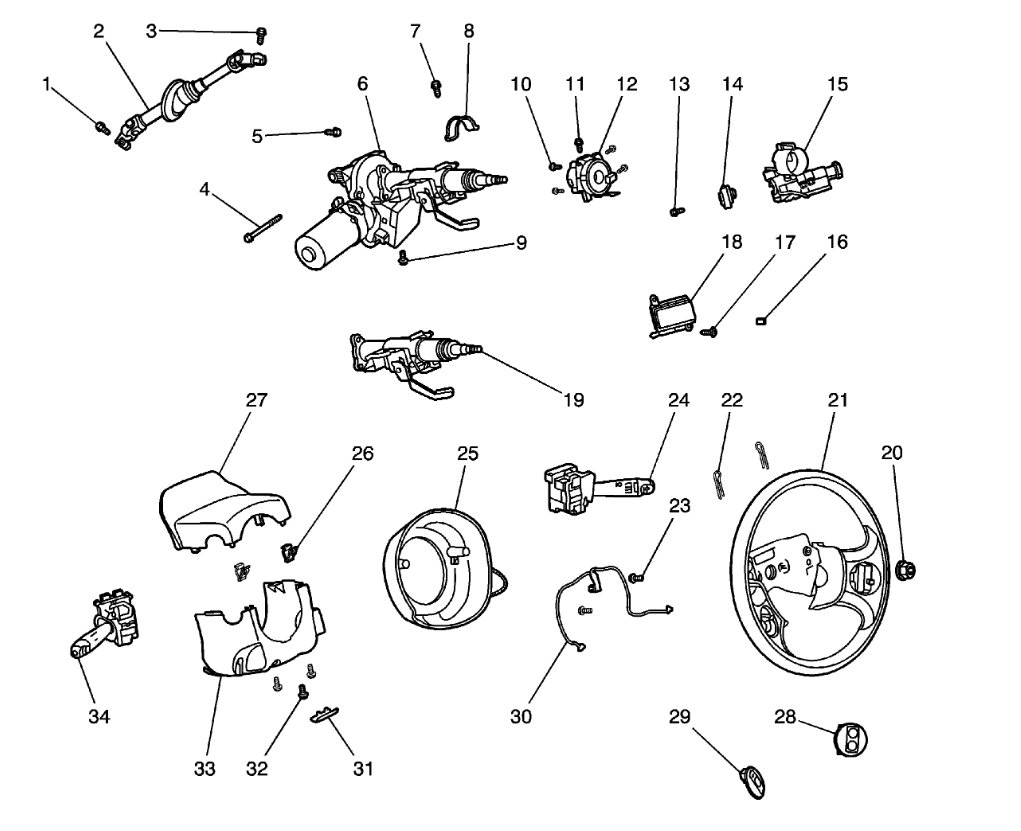

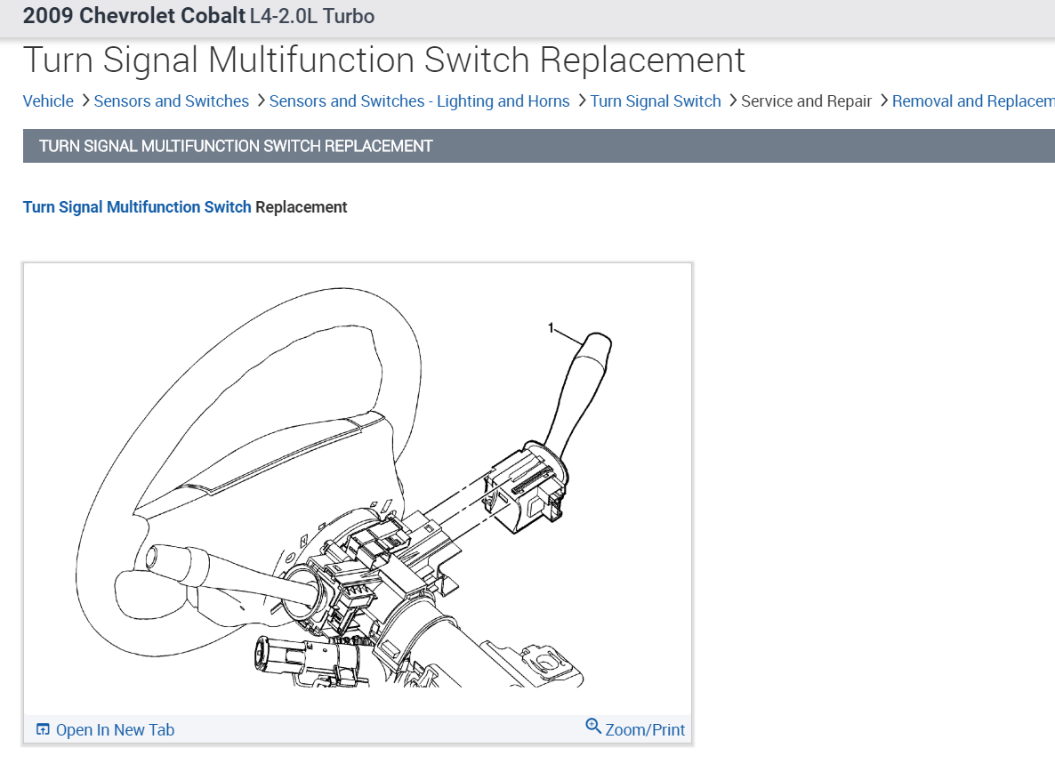

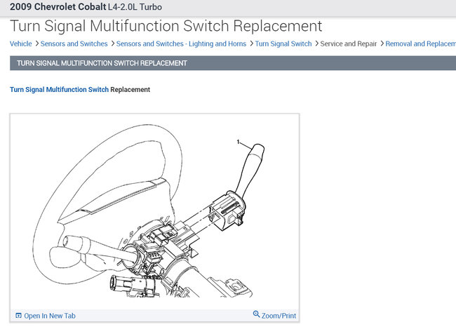

The return tang on the turn signal switch has broken which happens. Here are guides to help you get the switch replaced.
