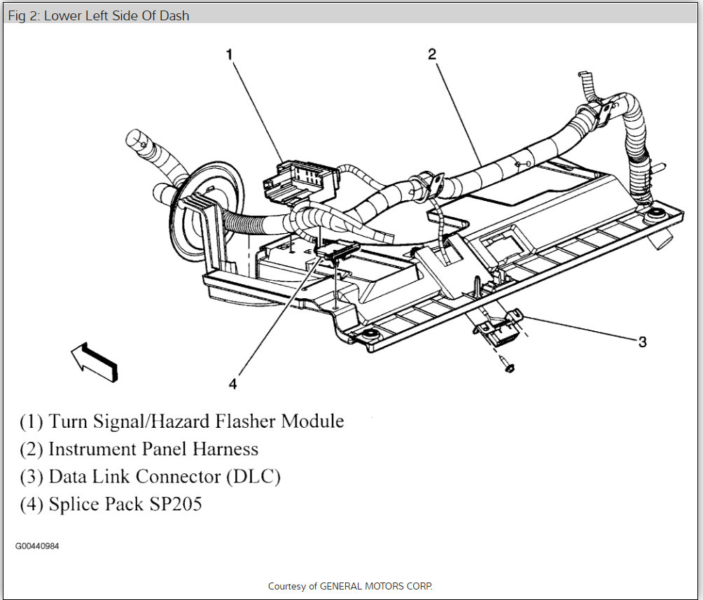

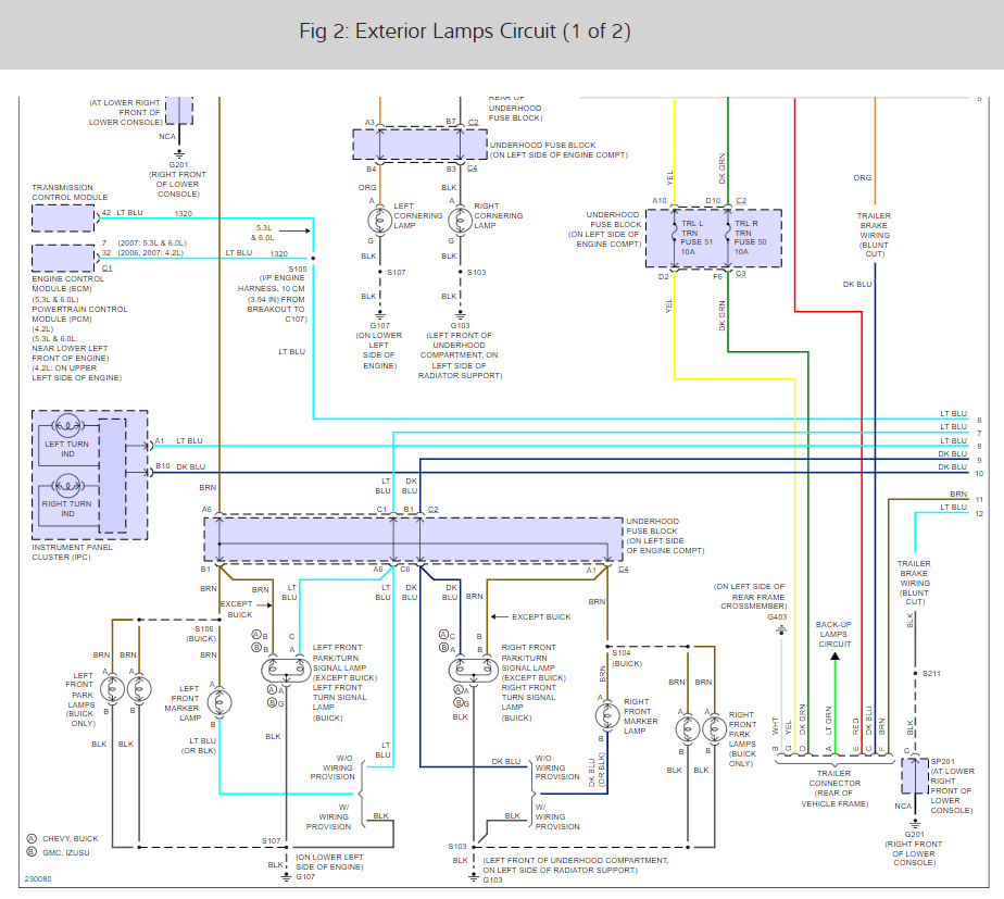

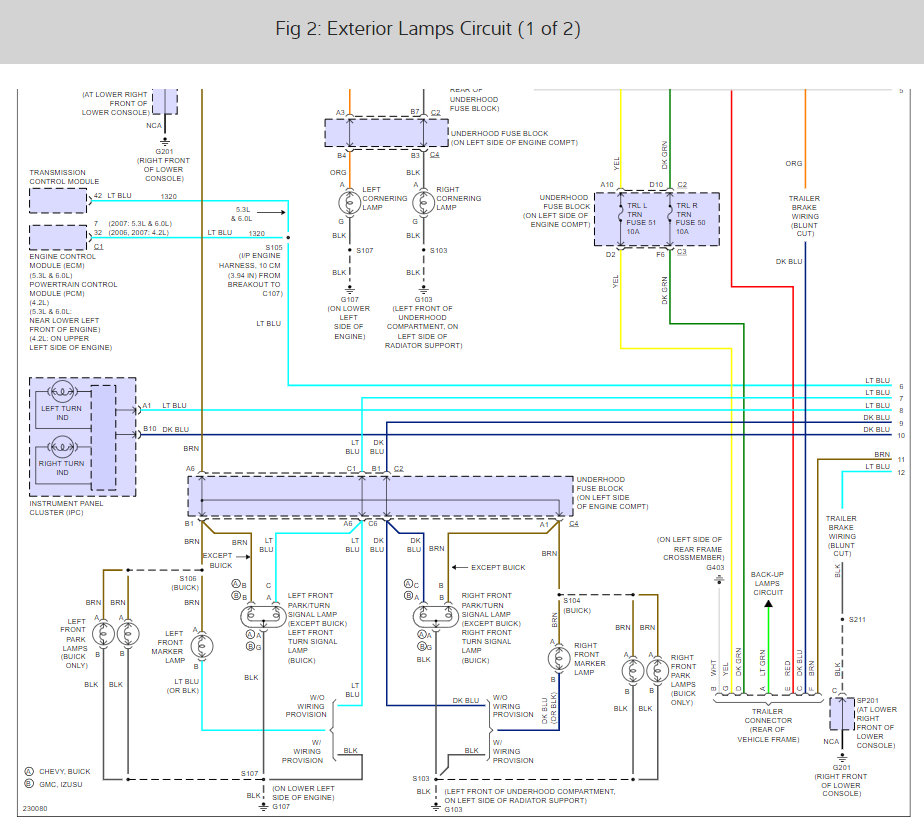

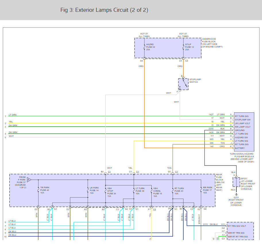

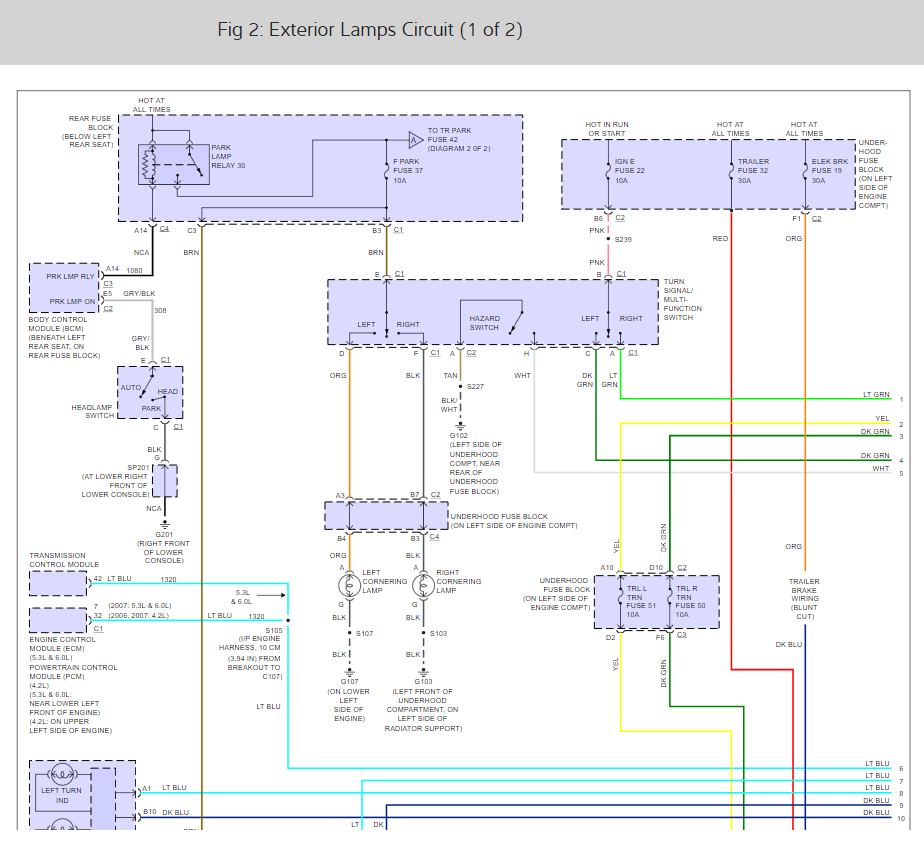

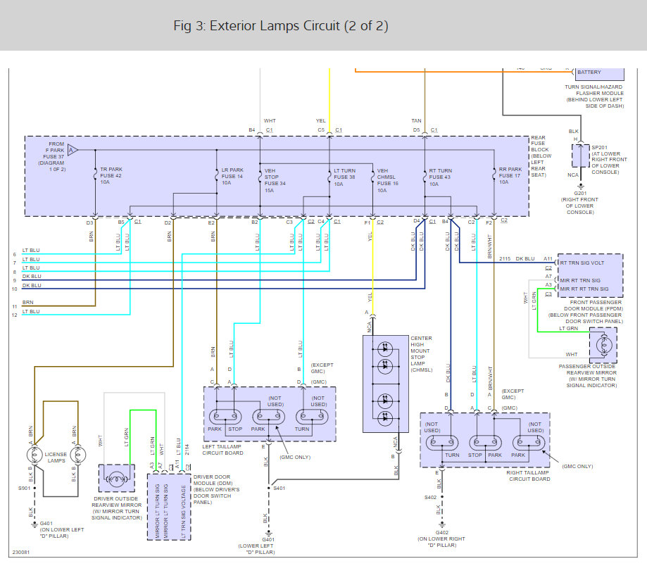

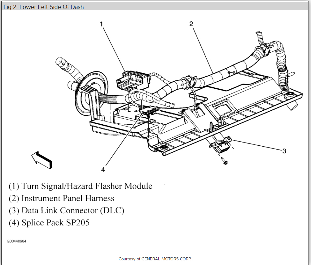

It sounds like you have a flasher module that is going out but to be sure here is a guide and the wiring diagrams for the blinkers and the blinker module location under the dash test to confirm where you are losing power.
May 28, 2018 at 10:35 AM

Ken, thanks so much for your advice on this turn signal issue. I am old school mechanic and did not even know of a turn signal module. My day's of a turn signal was a flasher.
Sep 9, 2018 at 10:39 AM
Yep, me too brother. Did it fix the issue?
Sep 9, 2018 at 12:33 PM
MIKE SUTHERLAND
  • 7 POSTS
Yes it sure did. Thanks buddy.
