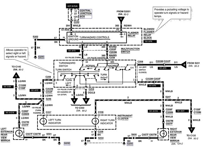

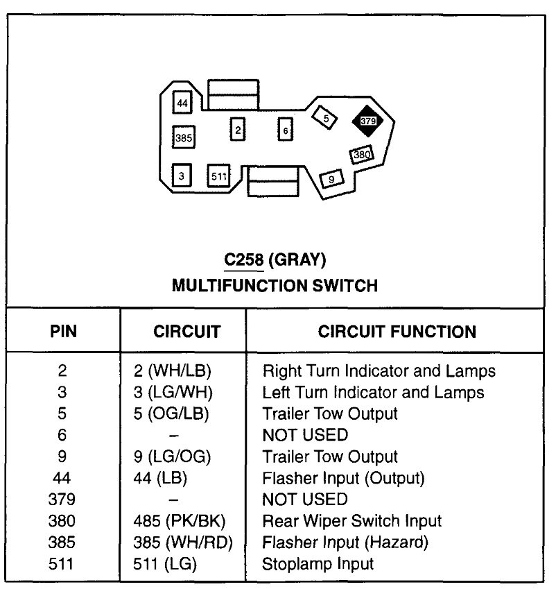

I'm trying to install a new connector but my other one's wires popped out, so I don't know where they go.

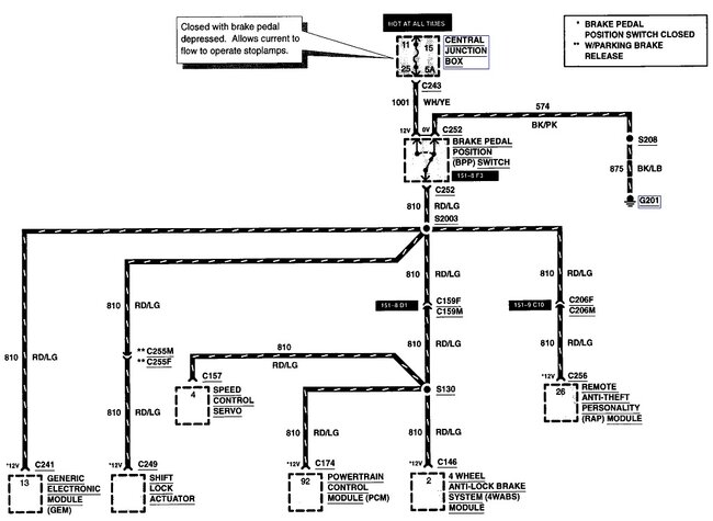

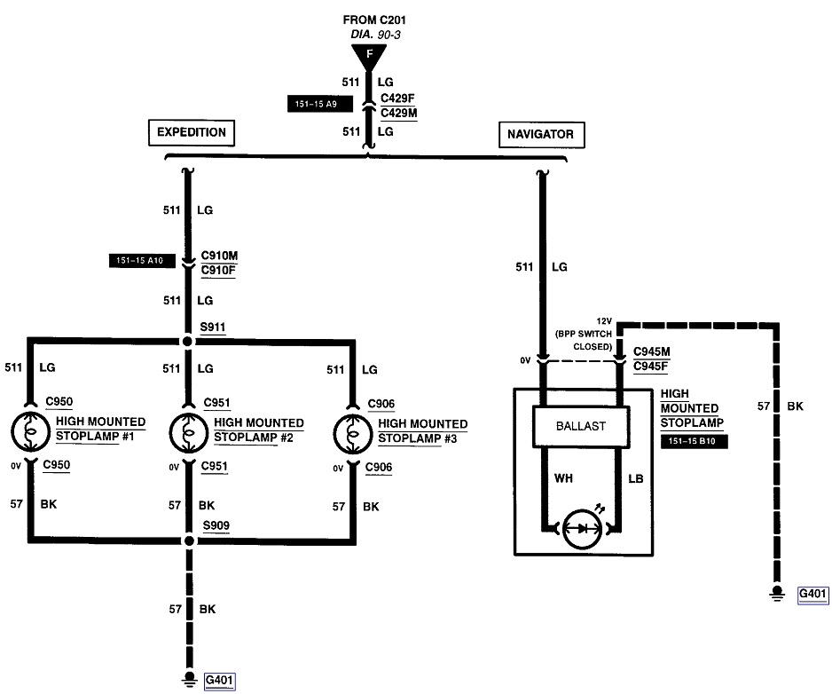

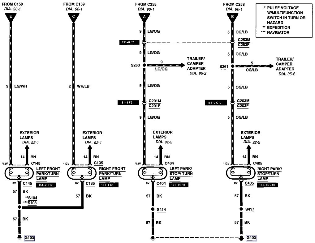

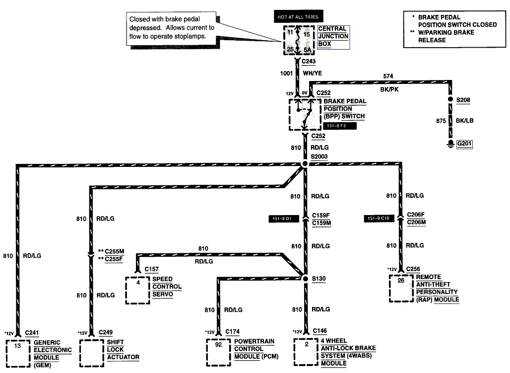

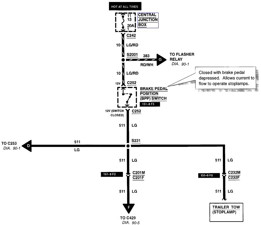

Here's the connector view. I included the diagrams for the signal system in case you need them.
