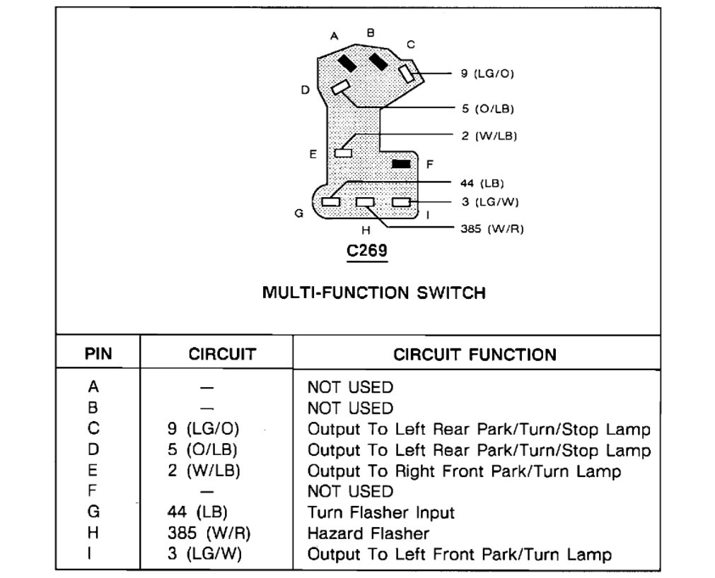

I have a problem with wiring the turn signal switch Pig Tail for the Blinkers ???

Good morning,

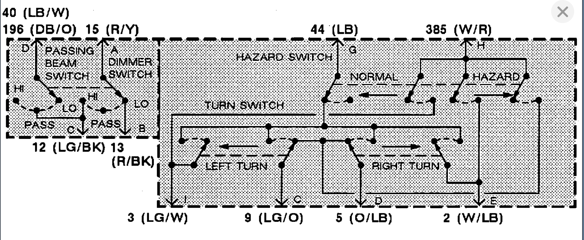

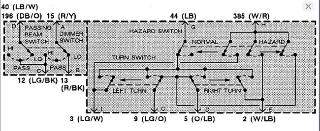

I attached the diagram of the switch itself. I also attached the diagram of the connector which identifies the location of the wires.
Let me know if you have any other questions.
