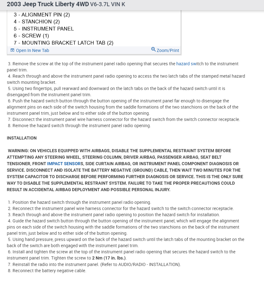

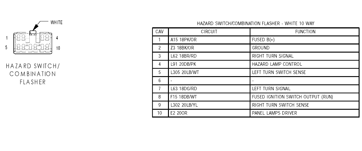

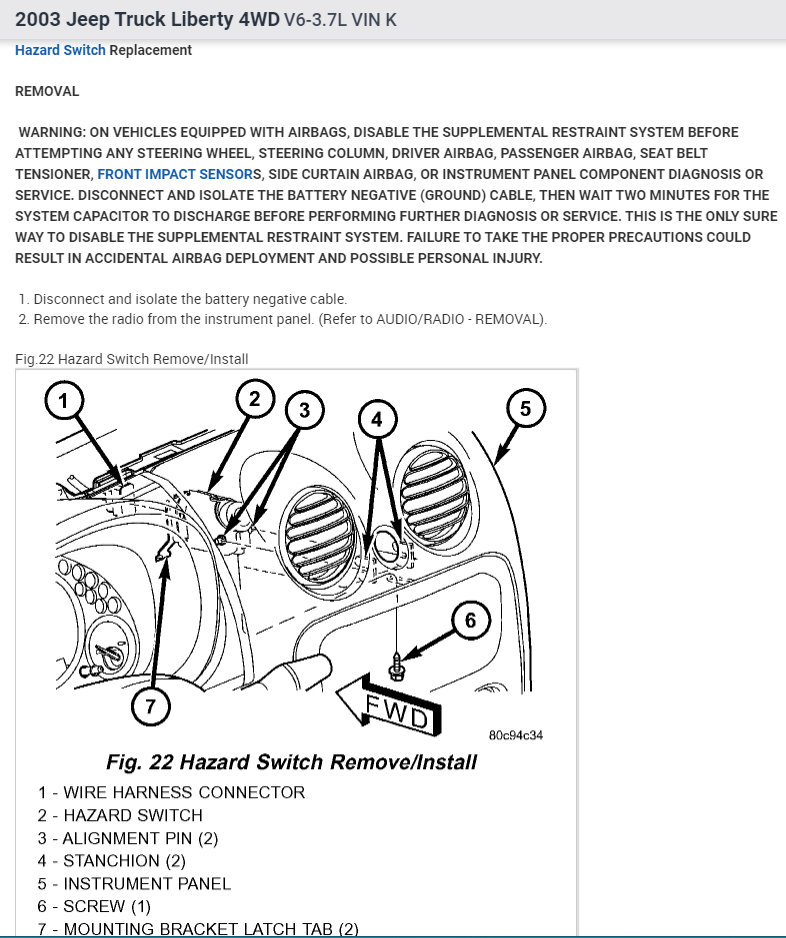

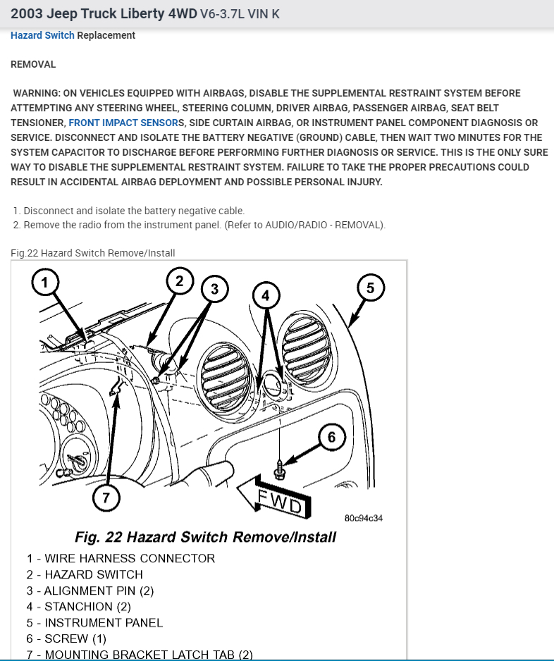

On this vehicle the turn signals are controlled by the hazard switch. It has built in flasher relay for the turn signal as well as the hazard lights.
The left and the right turn signals are controlled by separate pins, and it is possible to have one side functional but not the other.
I have attached diagrams below for your reference.
