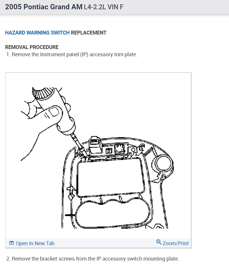

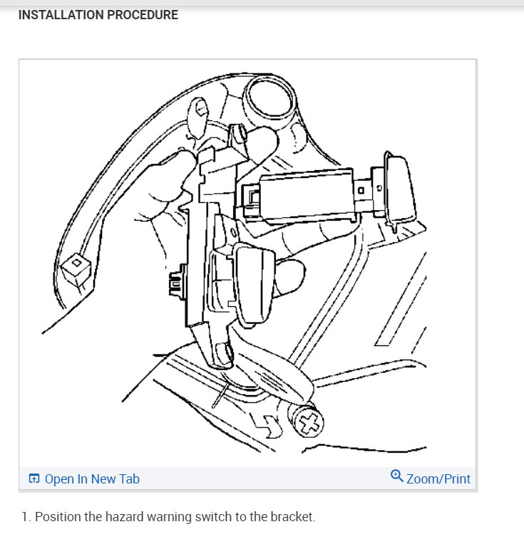

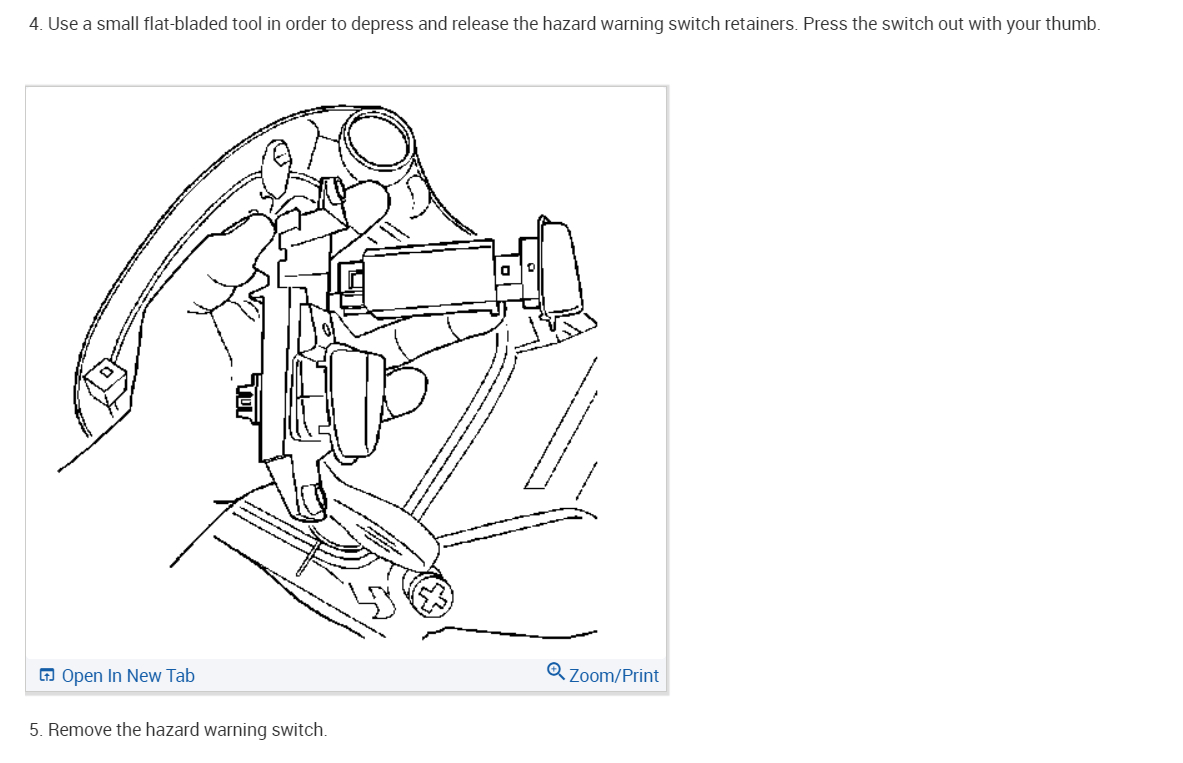

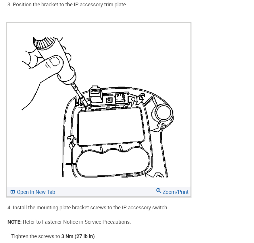

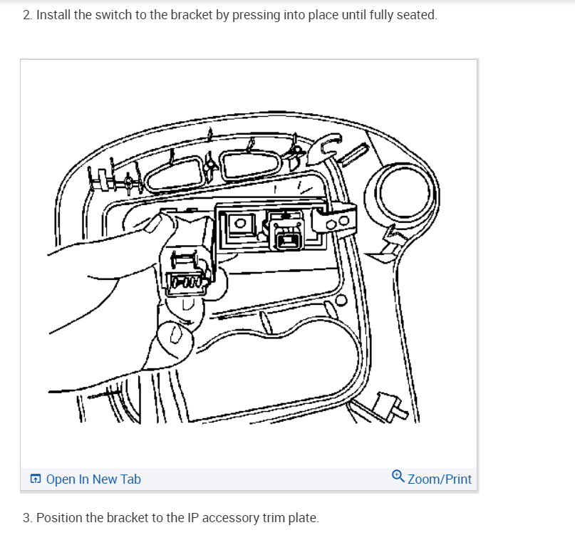

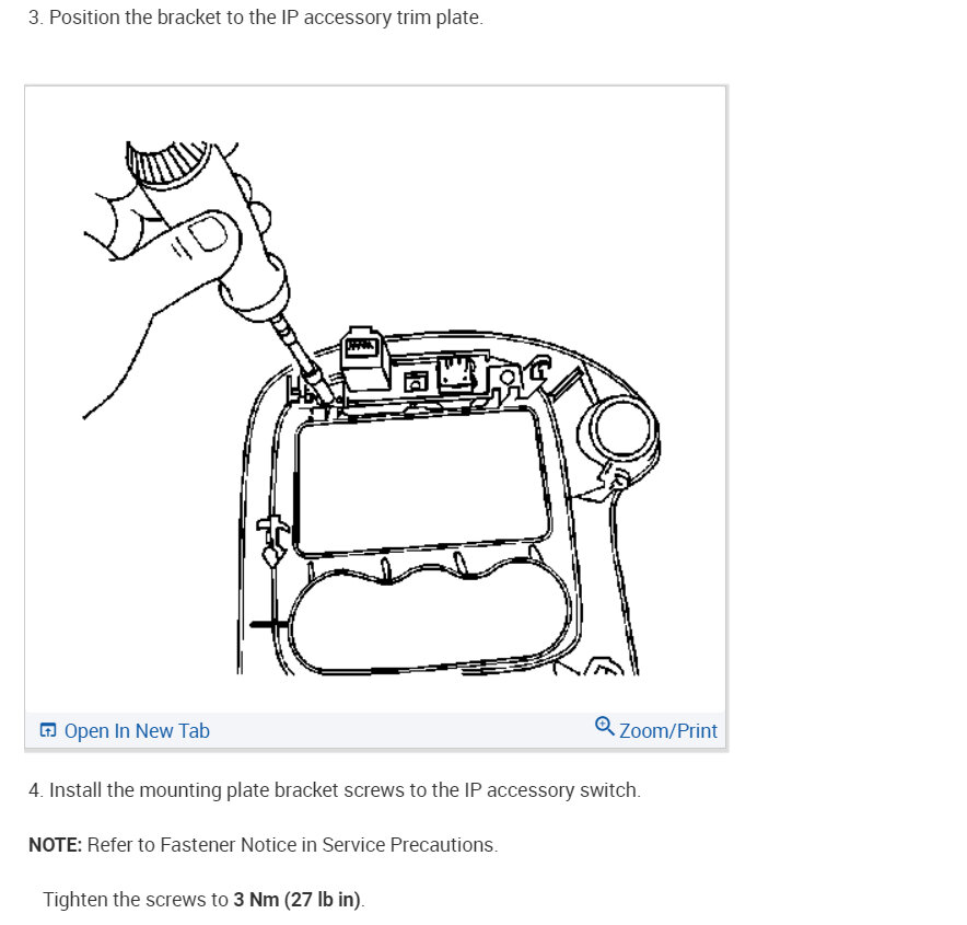

My turn signal flasher blinks fast when activated but my fuse and bulbs are fine. Looking online I'm seeing mixed things so thought I'd ask here. I've seen the flasher reply is bad and then I've seen it is an integrated system with the hazard switch. I'm curious which it is and where are they located.
