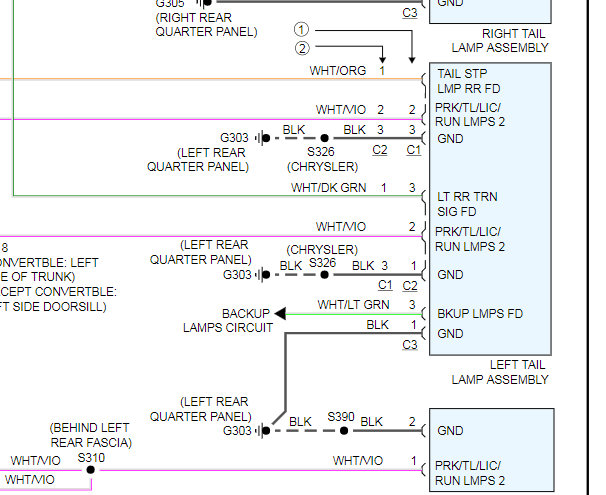

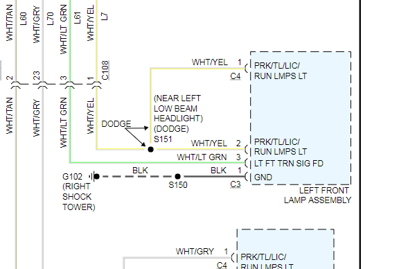

My vehicle's left turn signals aren't working and the left brake light isn't working. All the bulbs are in working condition. When I turn the left signal on, the light on the dash flashes fast like the bulbs are burned out. Also if it matters the vehicles current codes are: P000A,P000B,P0440,P0700.
