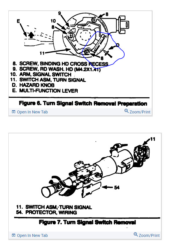

That's why I wanted a picture.
If it is the old style column, the hazard switch is part of the turn signal switch.
I attached the breakdown of the column I was referring to.

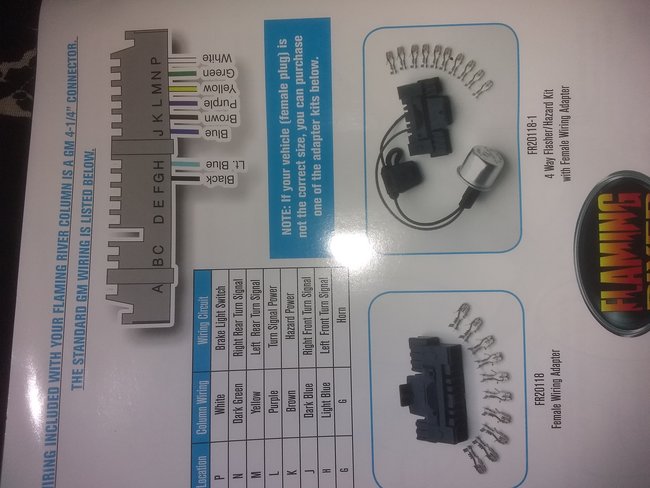

Just got a brand new Flaming River column ($600.00) - plug it in and same thing , all wires hot.
White wire should be hot at all times (coming from brake switch) , as should brown wire from hazards. purple from directionals hot with key on.
So I can't understand why the other four turn signal circuits are hot coming out of the column without anything being turned on.
- I've checked the connector and it looks good. I'm at my wits end trying to figure this out.
