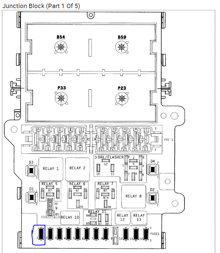

First, pic 1 below shows the fuse that powers the turn signals. Check it first. In addition to the condition of the fuse, make sure there is power to and from it. Here is a link you may find helpful:

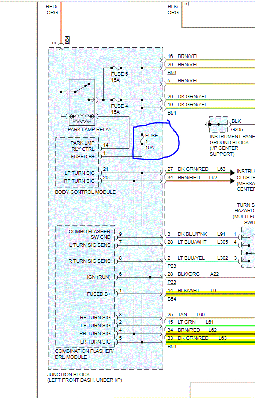

In pic 2, I circled the fuse's location in the fuse box under the dash.

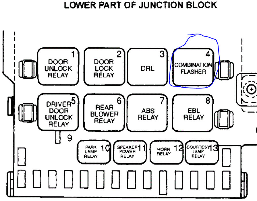

In pic 3, I circled the flasher. Make sure it is tight and there are no corrosion issues where it plugs in. If there is another relay with the same part number, switch them to see if it makes a difference.
