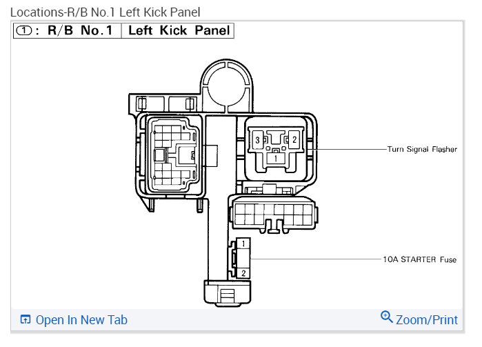

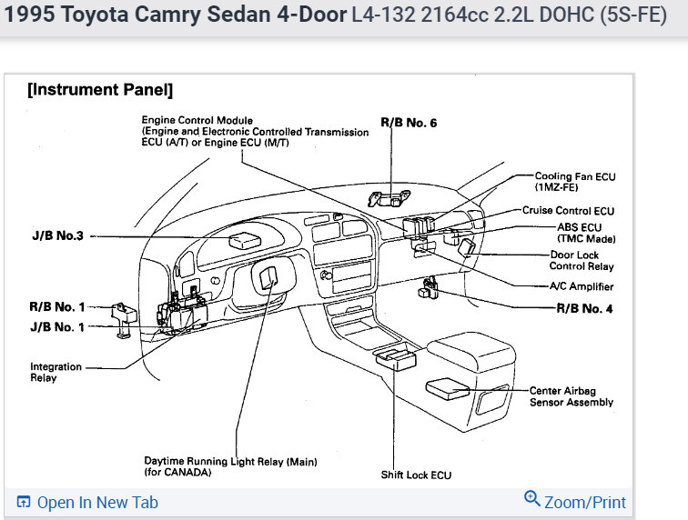

Where is the relay for the turn signal flasher located on a 1995 Camry made in North America? I have already removed the glove box assembly and could not find it there. The blinkers and hazard lights just stay on without flashing.
