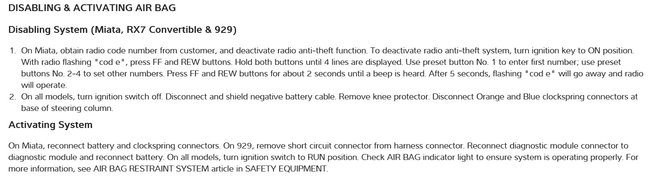

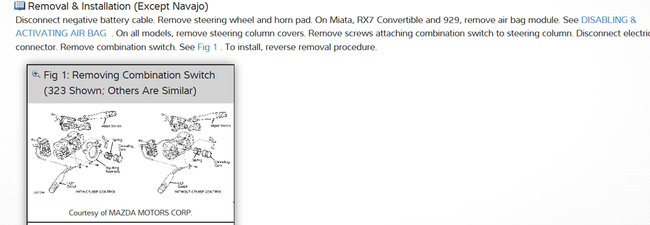

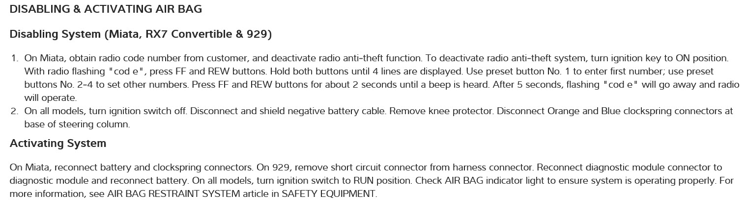

see pictures for removal install is pretty much reverse of removal. air bag disabling is included, but be very careful so it does not explode in your face.

you need to take off airbag then undo nut and use a puller auto parts rent them
