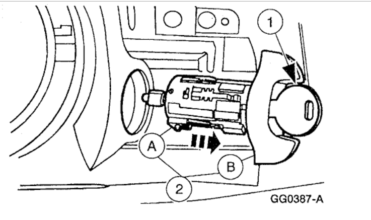

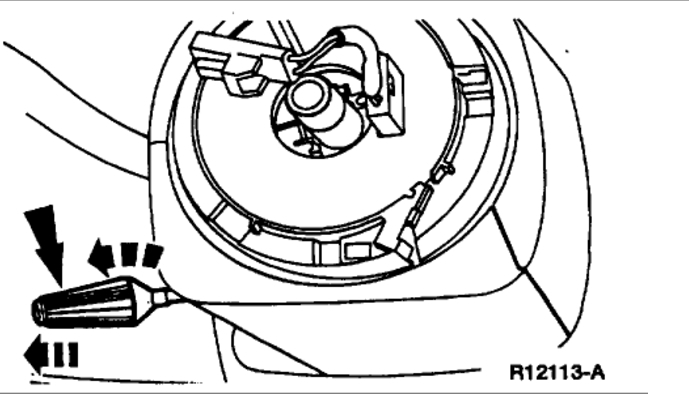

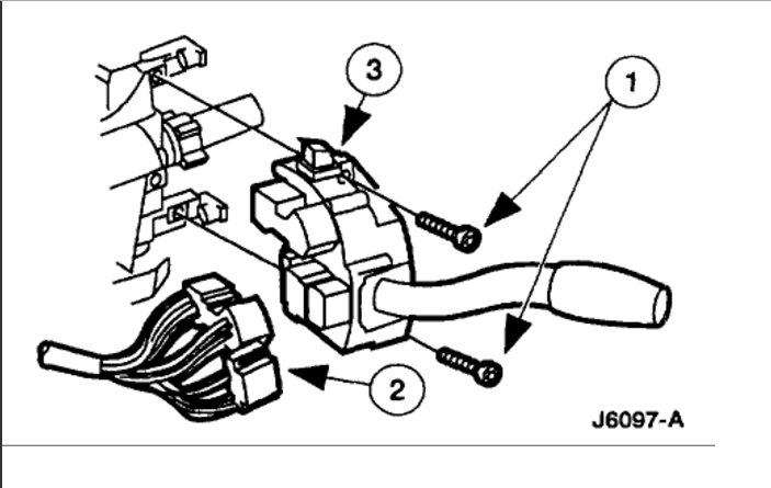

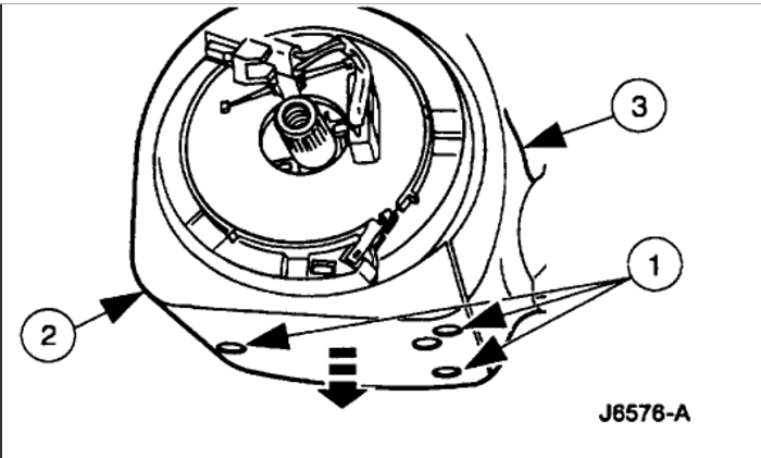

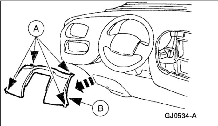

Here are some diagrams (below) that will help you. I do not think you need to do remove the ignition switch like the manual says you can get around it.
Check out the diagrams (Below). Please let us know what happens.
