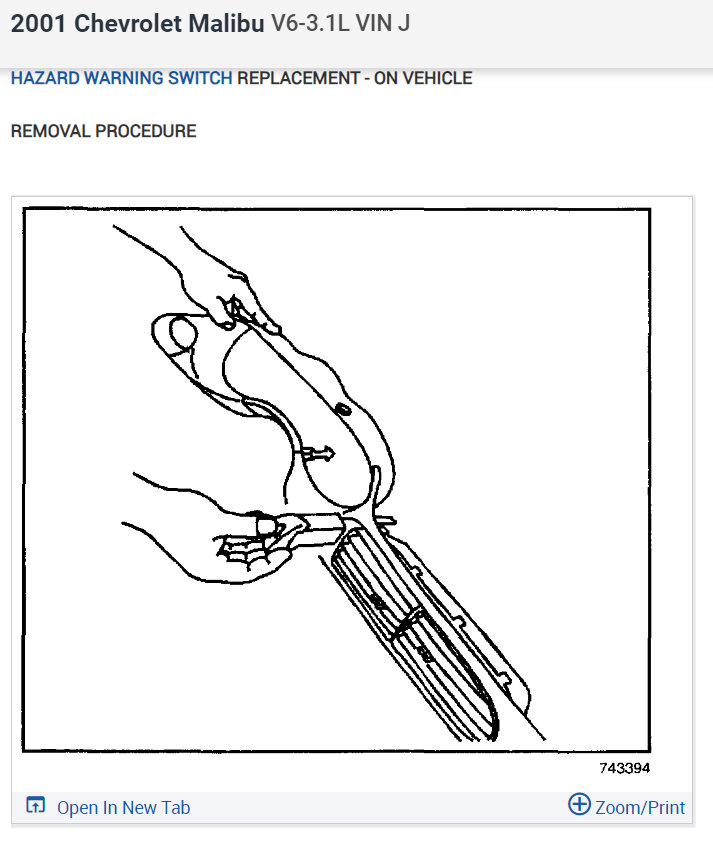

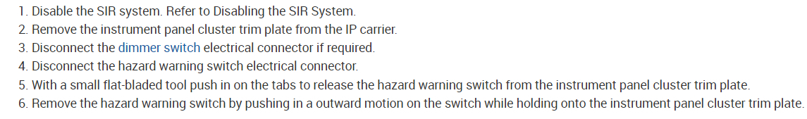

Turn signals were not working, just clicking fast. Checked all bulbs. Hazards work. Replaced the Hazard switch/relay. Now all lights work properly, but there is a fast clicking that won't stop when the key is turned on. Replaced the turn signal/multifunction switch, clicking still continues. It does stop and clicks normally when using the turn signals or hazards but goes back to a constant fast click when they are turned off.
