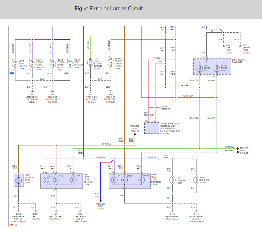

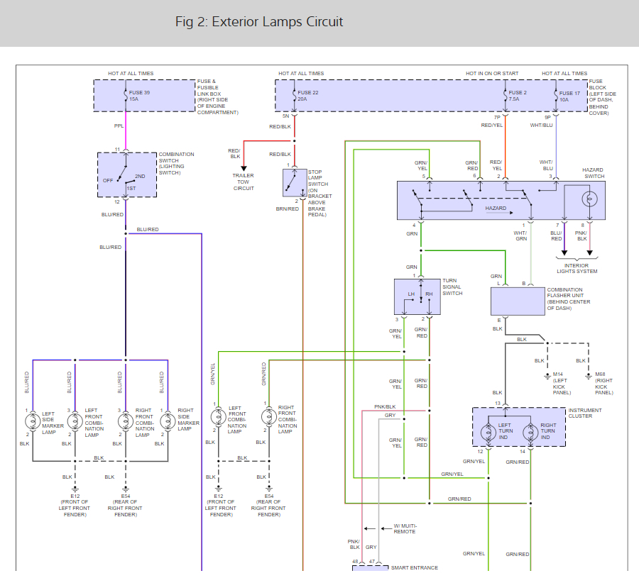

At the flasher unit there is a ground wire that sounds like it is not connected. Here is a guide and the blinker wiring diagrams so you can see how the system works and how to test the ground:
Please test the ground and let me know how it goes.
