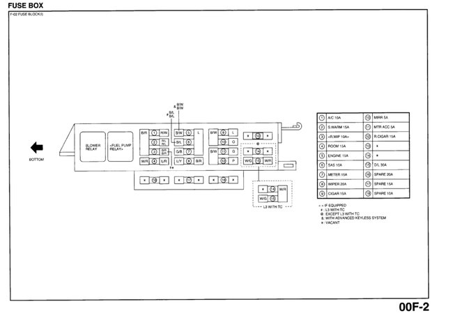

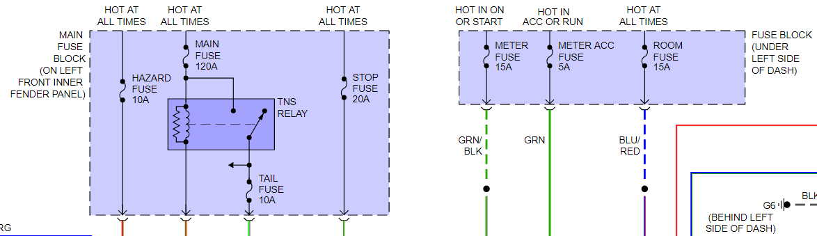

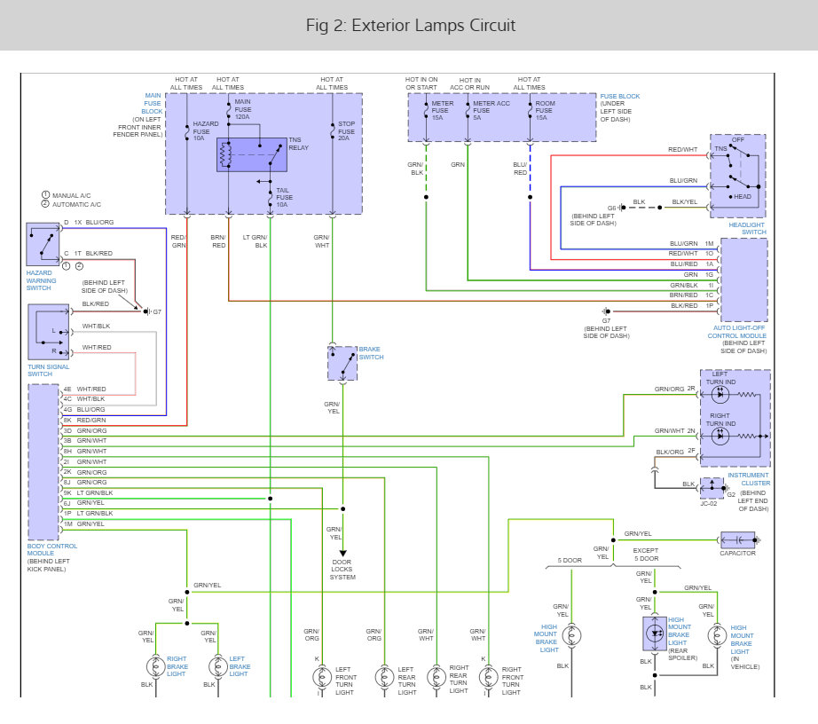

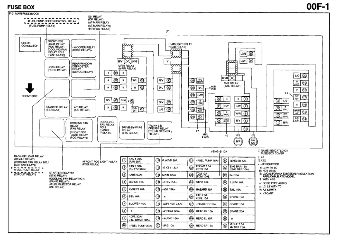

We need to check for power at the fuses to make sure they are good (the fuses are in the diagrams below). here is a guide to help you and the fuse location as well. Also I have included the turn signal wiring diagrams so you can see how the system works.
May 28, 2021 at 10:07 AM

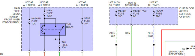

Okay, let's check the TNS relay which in under the hood inside the fuse panel. here is a guide you help you test it. You you are in question try replacing it.
May 30, 2021 at 11:39 AM
