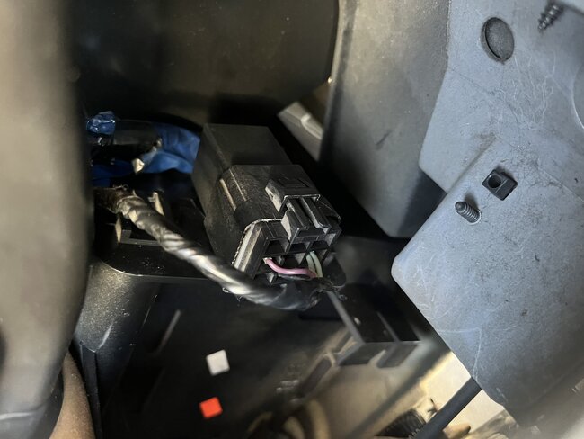

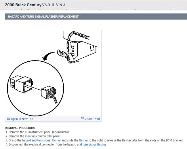

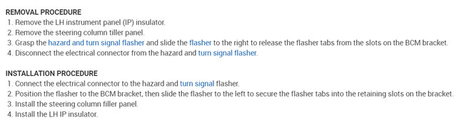

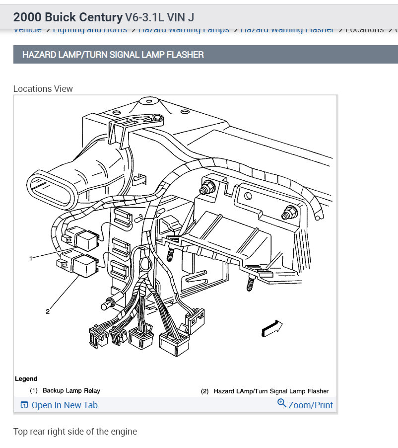

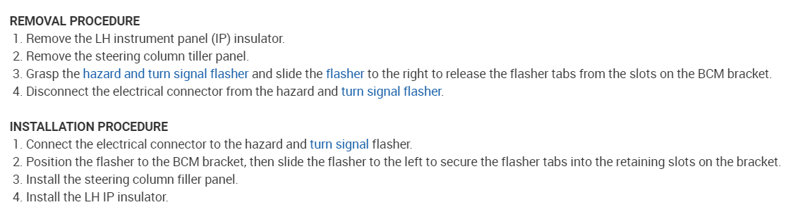

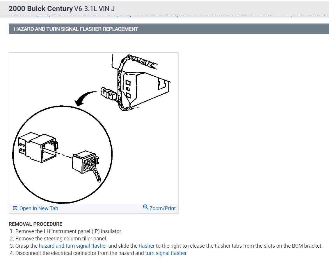

It is common for the combination flasher to go out in these cars. Here is the location near the steering column so you can swap it out which would fix the problem. Check out the images (below). Please let us know if you need anything else to get the problem fixed.

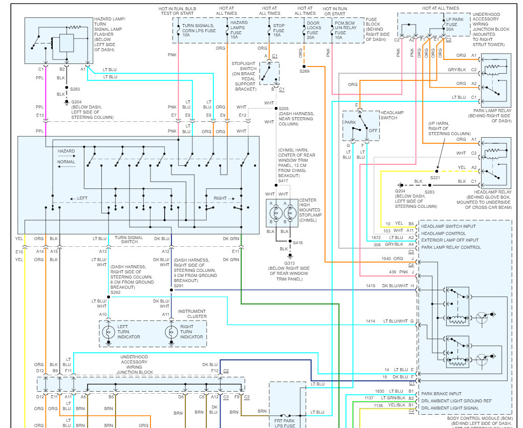

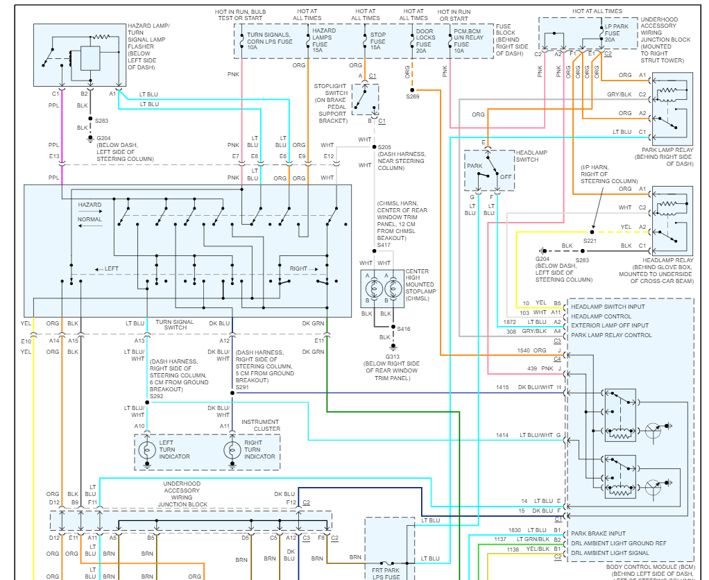

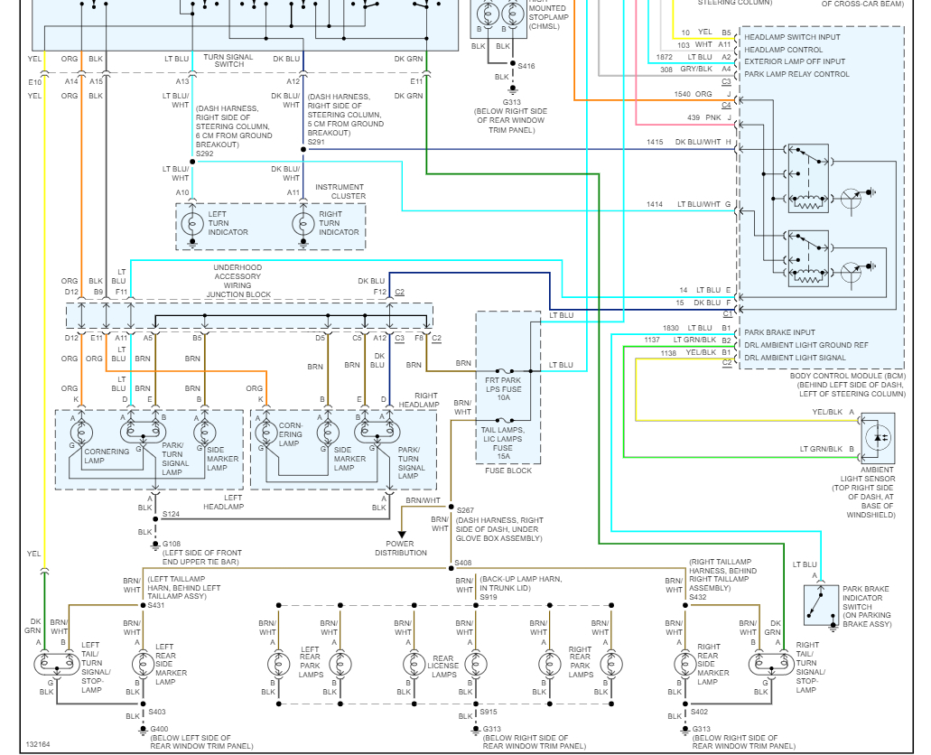

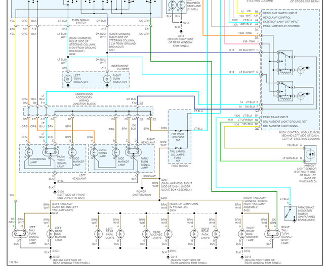

It sounds like you have the wrong or defective flasher. Here are the blinker wiring diagrams so you can see how the system works. I would check the grounds.
