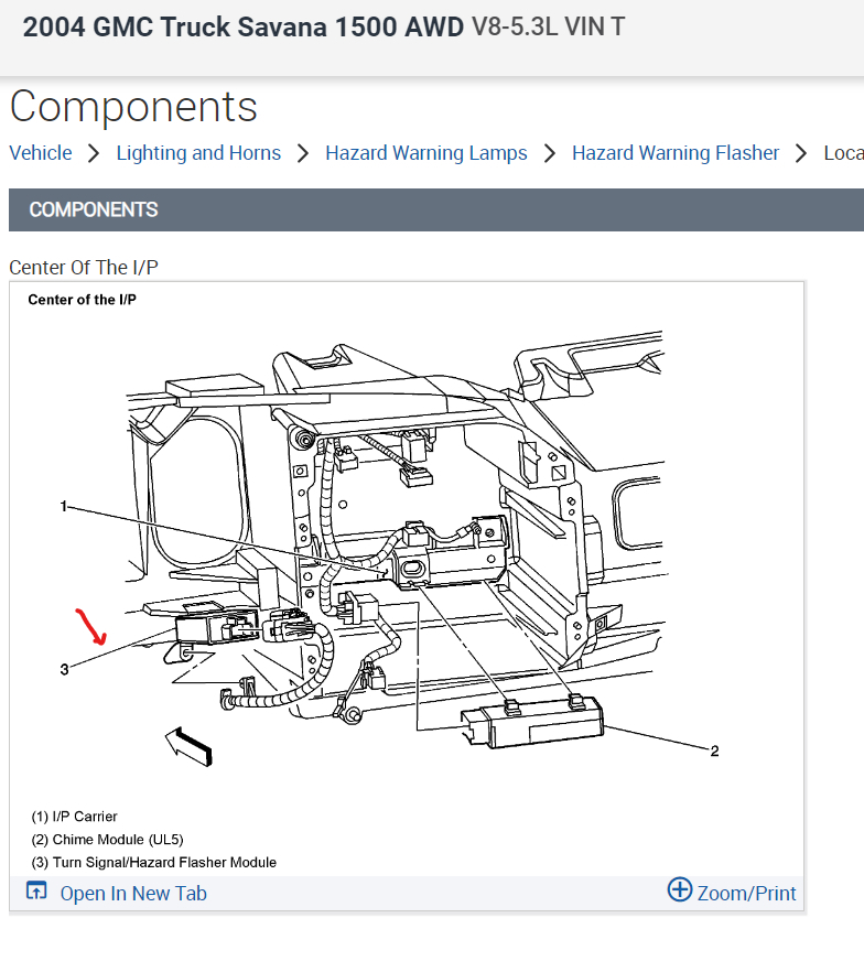

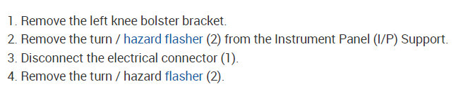

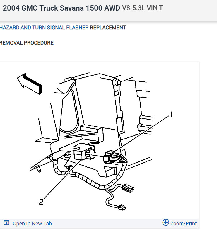

If it still blinks fast with both new bulb, I would swap out the turn signal flasher. Check out the images (below). Please let us know what happens.
