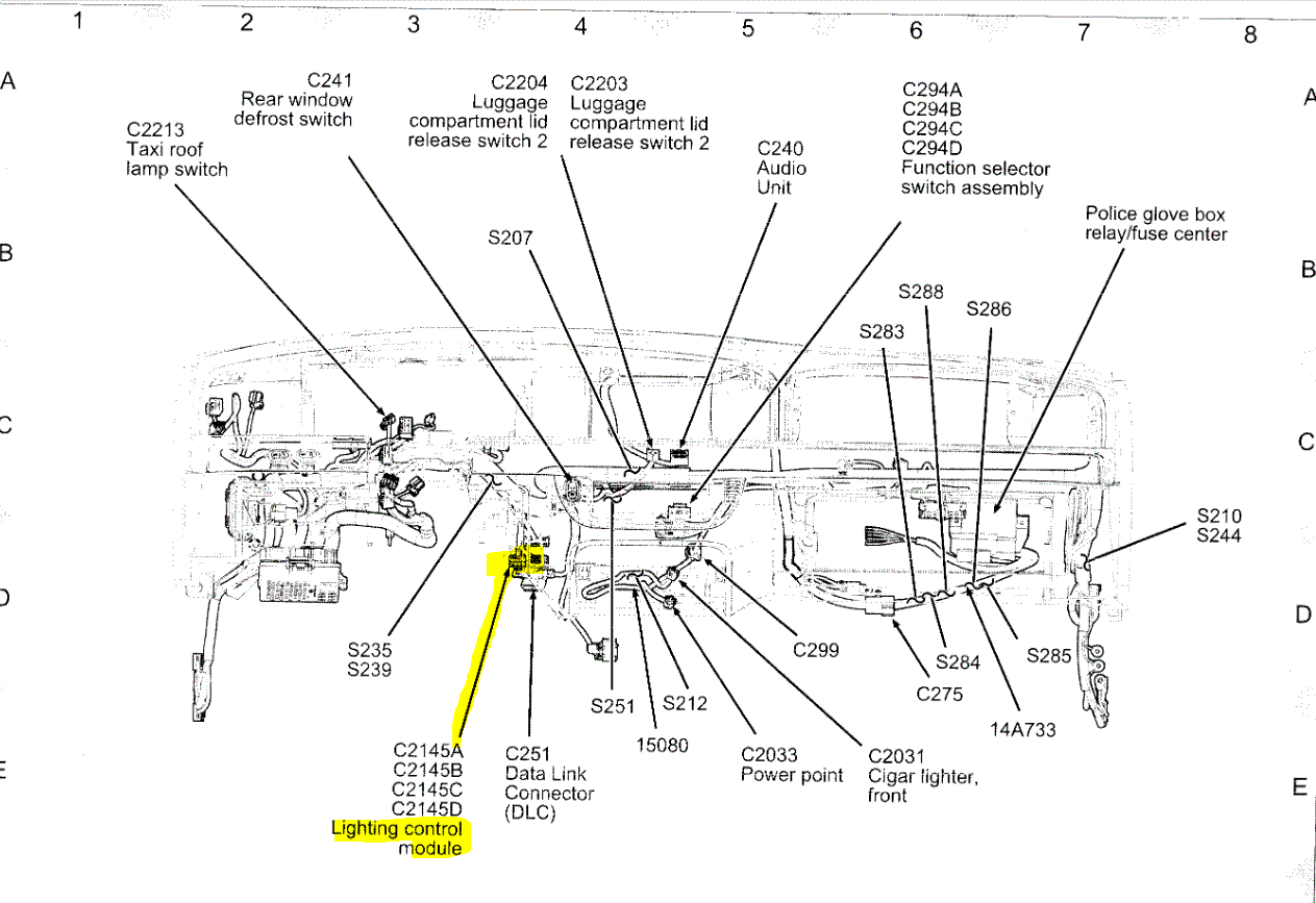

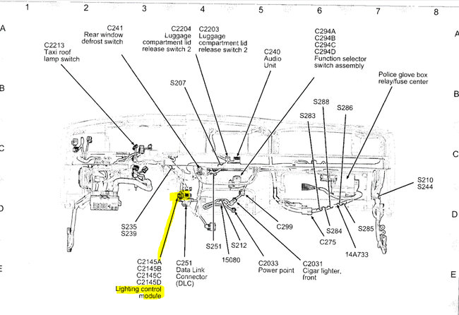

The lighting control module has taken the function of a traditional flasher relay which would make the noise you hear. In this case, I suspect that is where the sound is coming from.
The module is approximately above where your right knee would be when driving. See pic below.
