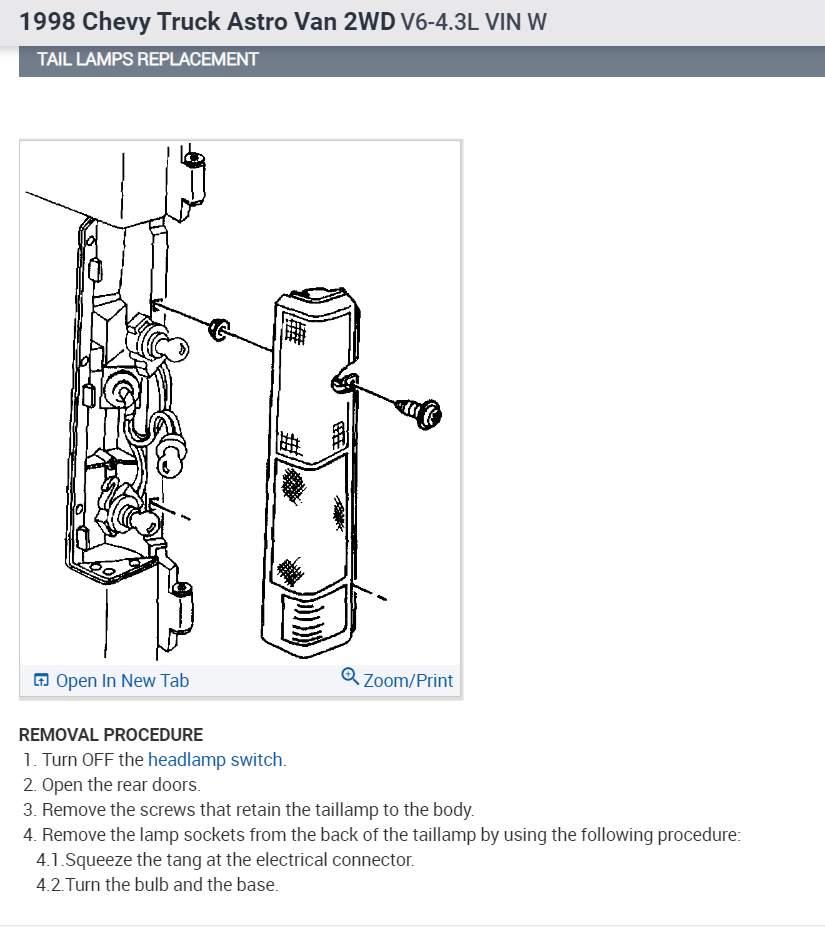

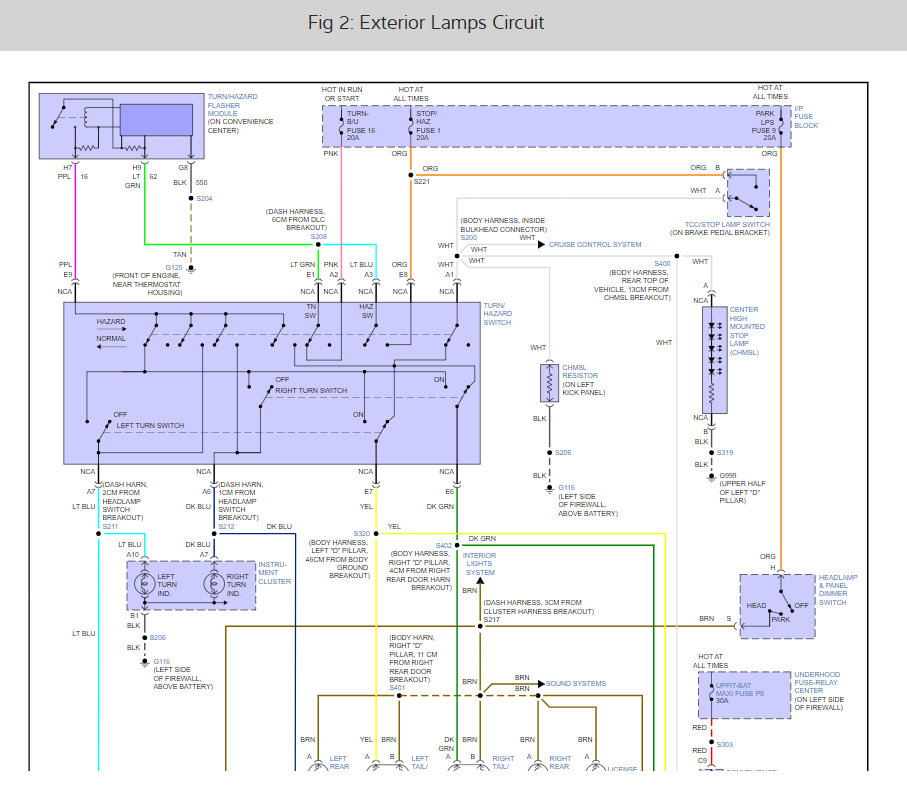

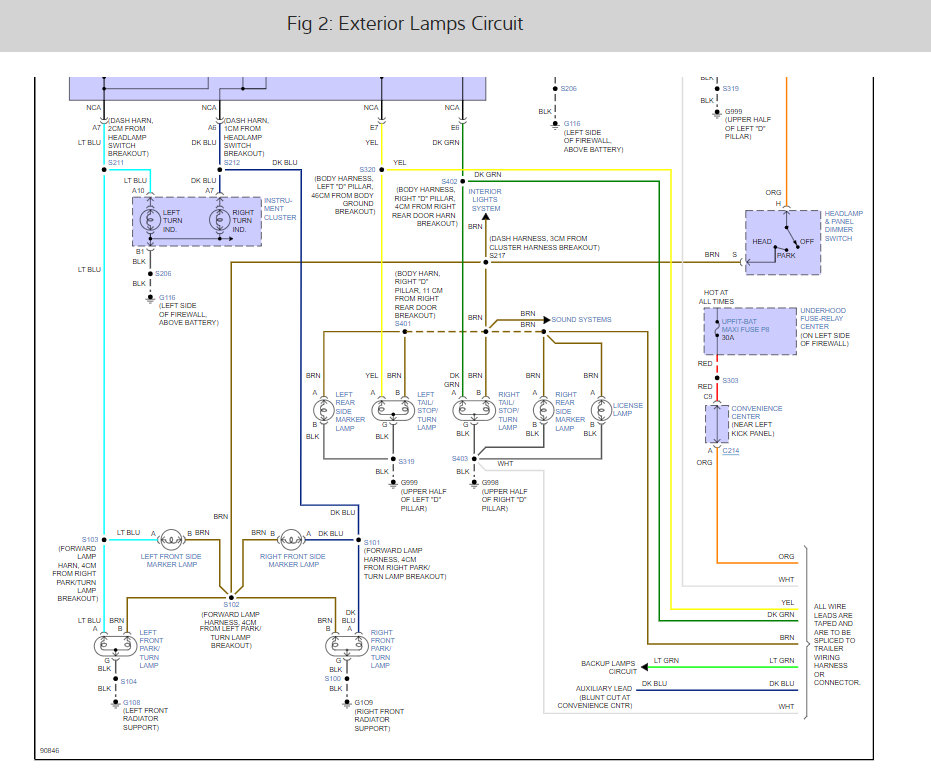

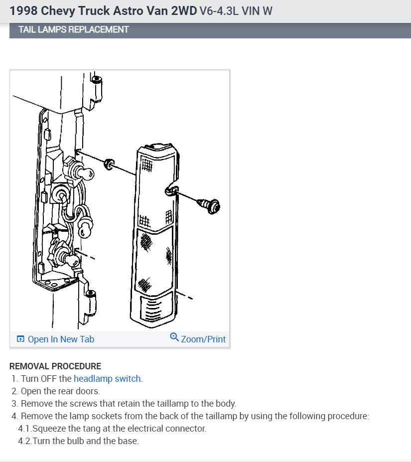

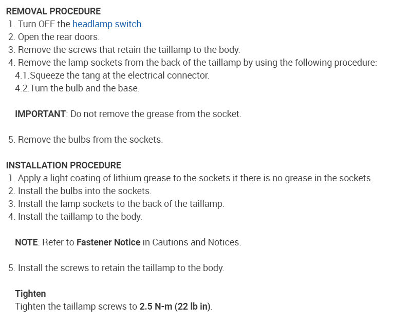

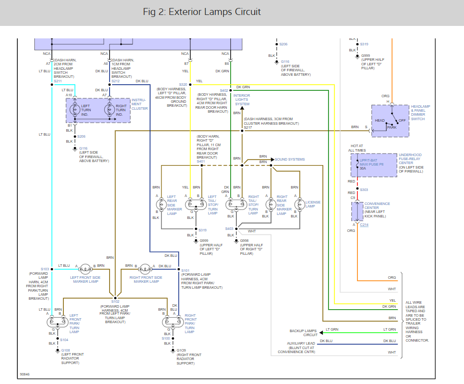

Yep, this happens when the right passenger side blinker has a bad ground or the bulb socket is melted allowing a back feed condition when the headlight is on, lets remove the right rear blinker assembly to check it out here are the instructions in the diagrams below. Also, I have included the blinker wiring diagrams so you can see how the system works.

Check out the diagrams. (Below) Let us know what happens and please upload pictures or videos of the problem.
