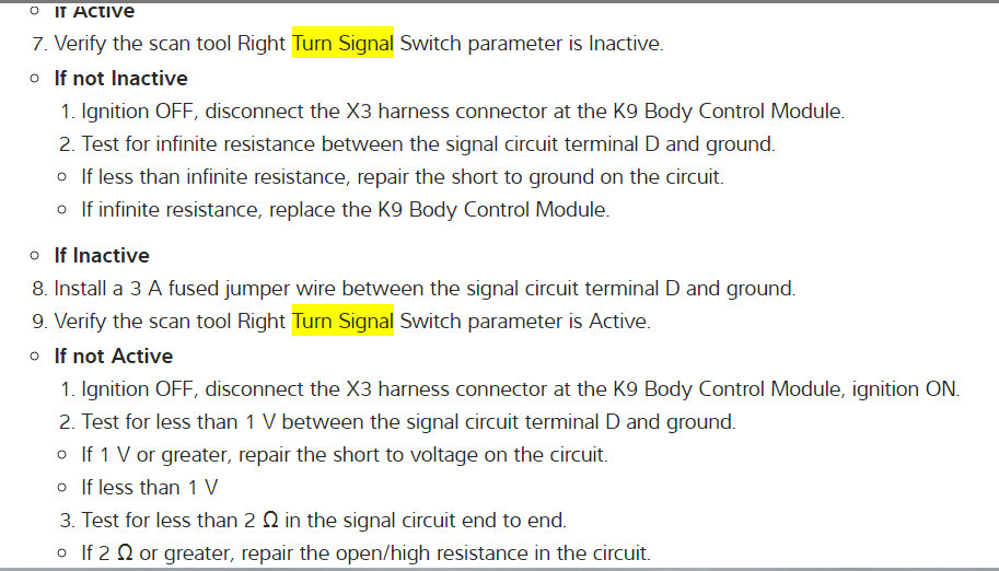

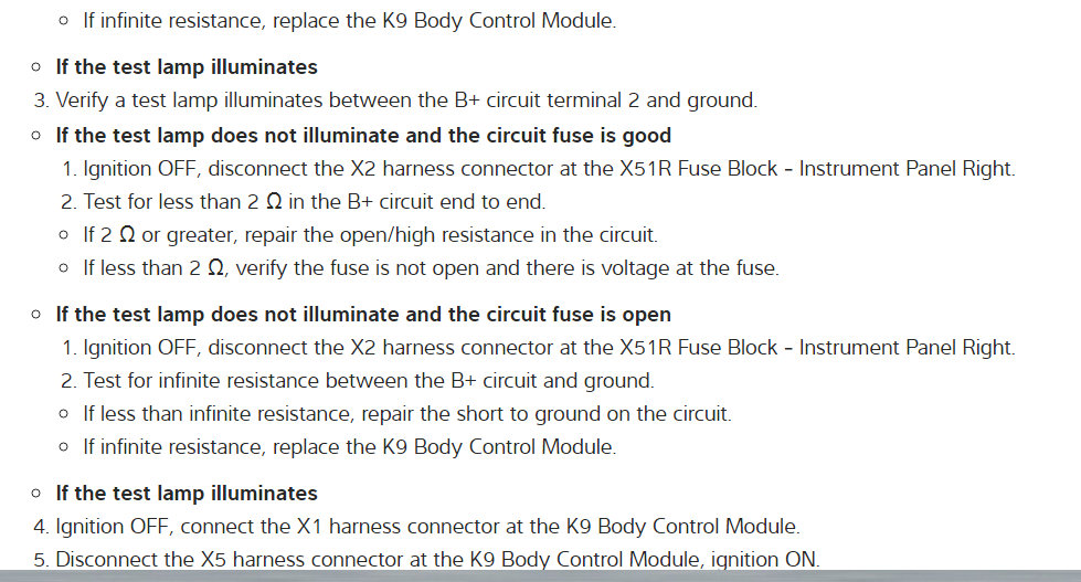

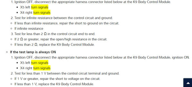

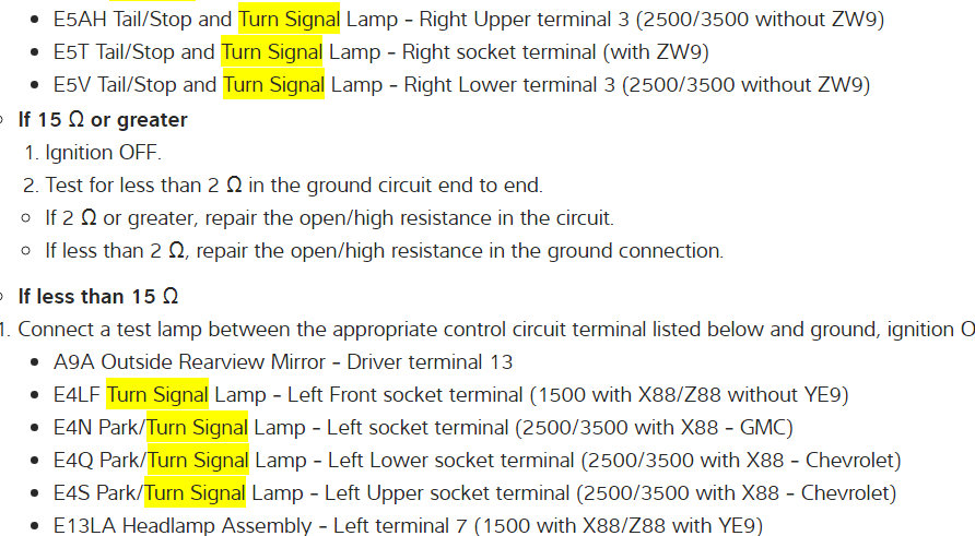

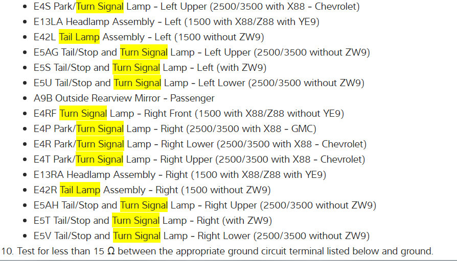

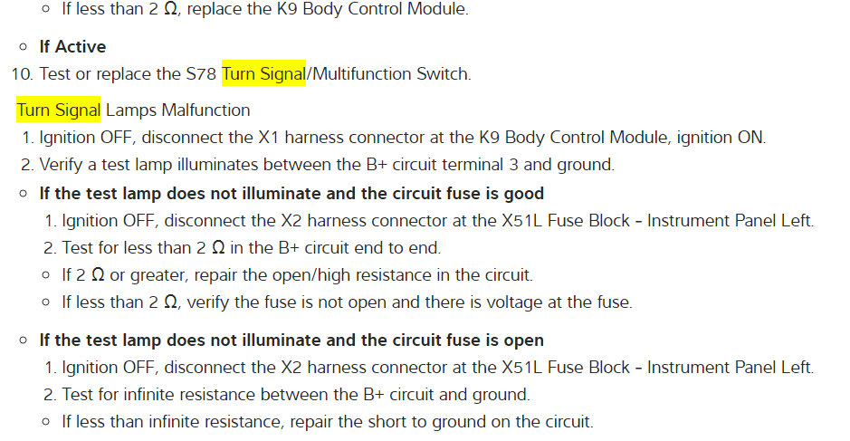

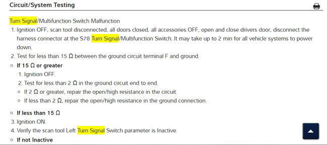

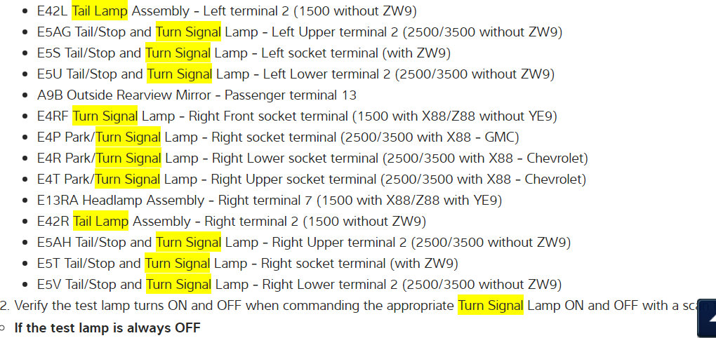

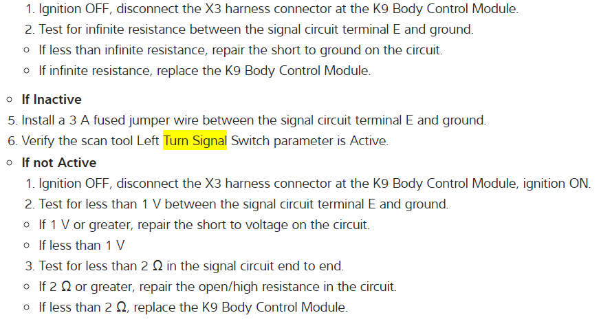

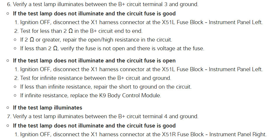

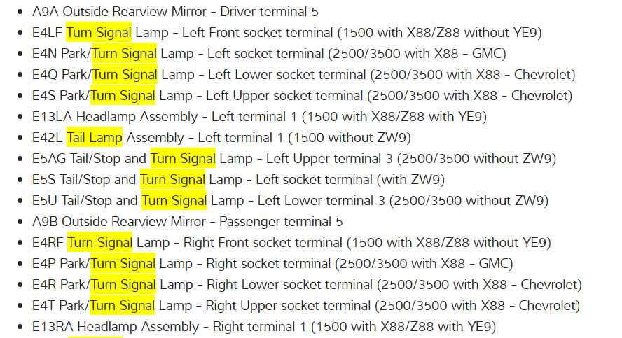

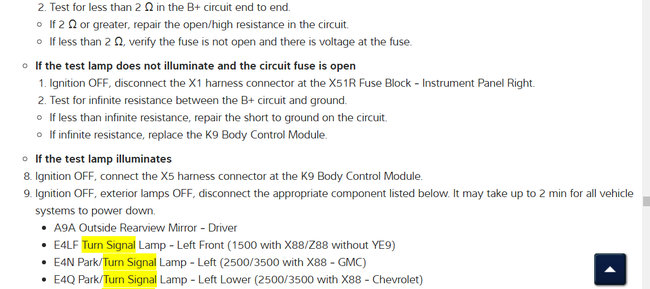

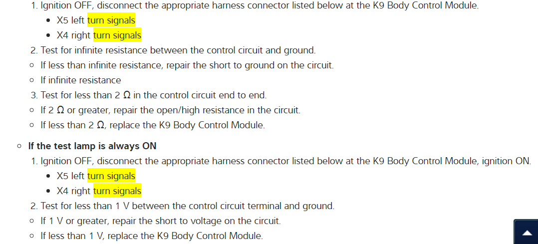

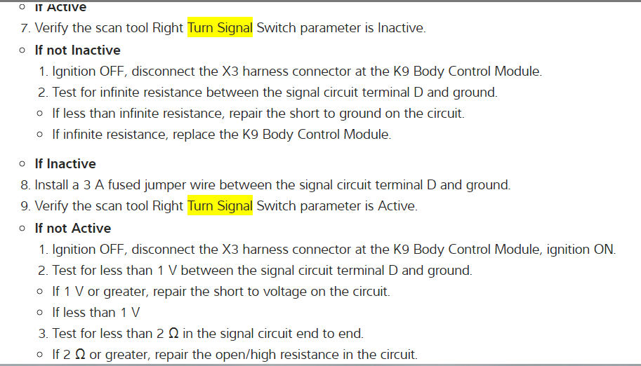

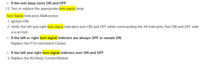

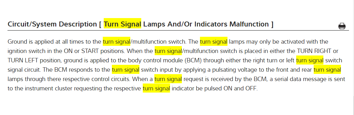

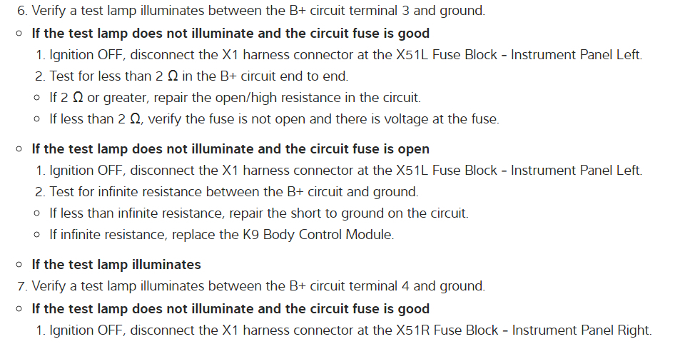

Hello again,

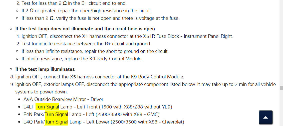

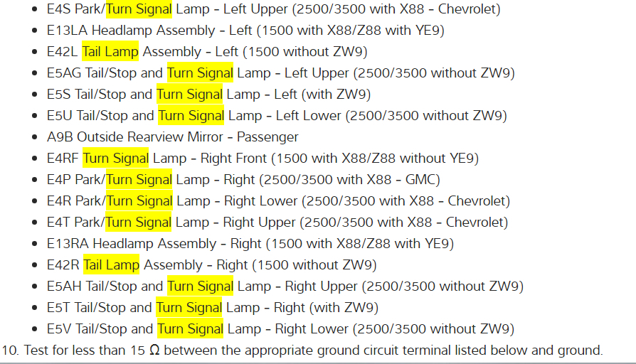

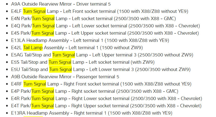

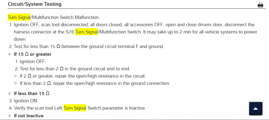

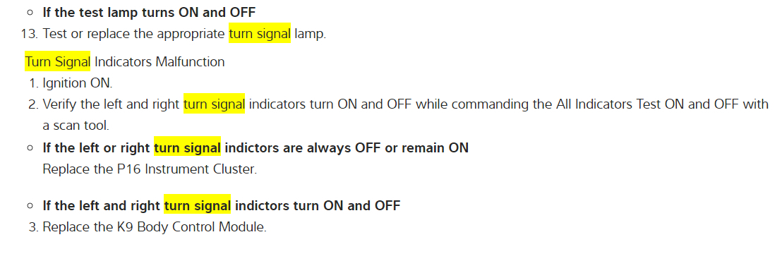

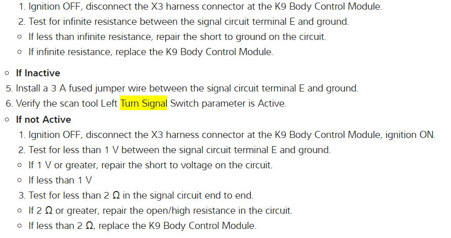

I have included for you the factory diagnostic troubleshooting guide for your vehicle's turn signals in the diagrams down below. It is quite involved, so please be patient and go through it step by step. It will require you to use a multi-meter so I have included a link for you to go to below if you are unfamiliar with how to use one.
Please go through these guides and get back to us with what you are able to find out, please.
Thanks,
Alex
