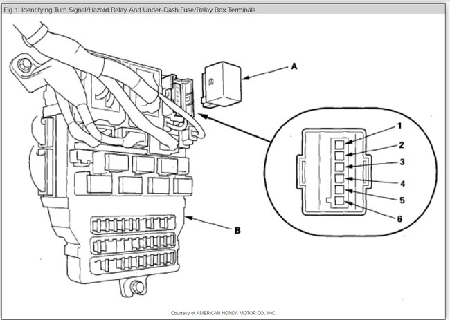

Here is the testing procedure
Inspect the relay and fuse/relay box socket terminals to be sure they are all making good contact.
If the terminals are bent, loose, or corroded, repair them as necessary, and recheck the system.
If the terminals look OK, Go to step 4.
Do the following input tests:
If any test indicates a problem, find and correct the cause, then recheck the system.
If all the input tests prove OK, the turn signal/hazard relay must be faulty; replace it.
CAVITY TEST CONDITION REFERENCE CHART
Cavity Test condition Test: Desired result Possible cause if desired result is not obtained
6 Under all conditions Measure the voltage to ground: There should be battery voltage.
Blown No. 16(15 A) fuse in the under-hood fuse/relay box
Faulty under-dash fuse/relay box
An open or high resistance in the wire
1 In all ignition switch positions Check for continuity to ground: There should be less than 0.2 V.
Poor ground (G501)
2 Connect terminal No. 6 to terminal No. 2 with a jumper wire. Check the turn signal lights operation: The left turn signal lights and indicator should come on.
Blown bulb
Poor ground (G601, G301) or an open in the ground wire
3 Connect terminal No. 6 to terminal No. 3 with a jumper wire. Check the turn signal lights operation: The right turn signal lights and indicator should come on.
Blown bulb
Poor ground(G201, G602) or an open in the ground wire
4 Ignition switch ON (II) and turn signal switch in Left position. Measure the voltage to ground: There should be about 10 V.
Poor ground (G501) or an open in the ground wire
Faulty turn signal switch
Faulty combination switch control unit
(1)
Faulty MICU
(1)
5 Ignition switch ON (II) and turn signal switch in Right position. Measure the voltage to ground: There should be about 10 V.
4 Hazard warning switch ON Measure the voltage to ground: There should be about 10 V.
Blown No. 16 (15 A) fuse in the under-hood fuse/relay box
Faulty hazard warning switch
An open in the wire
Faulty MICU
