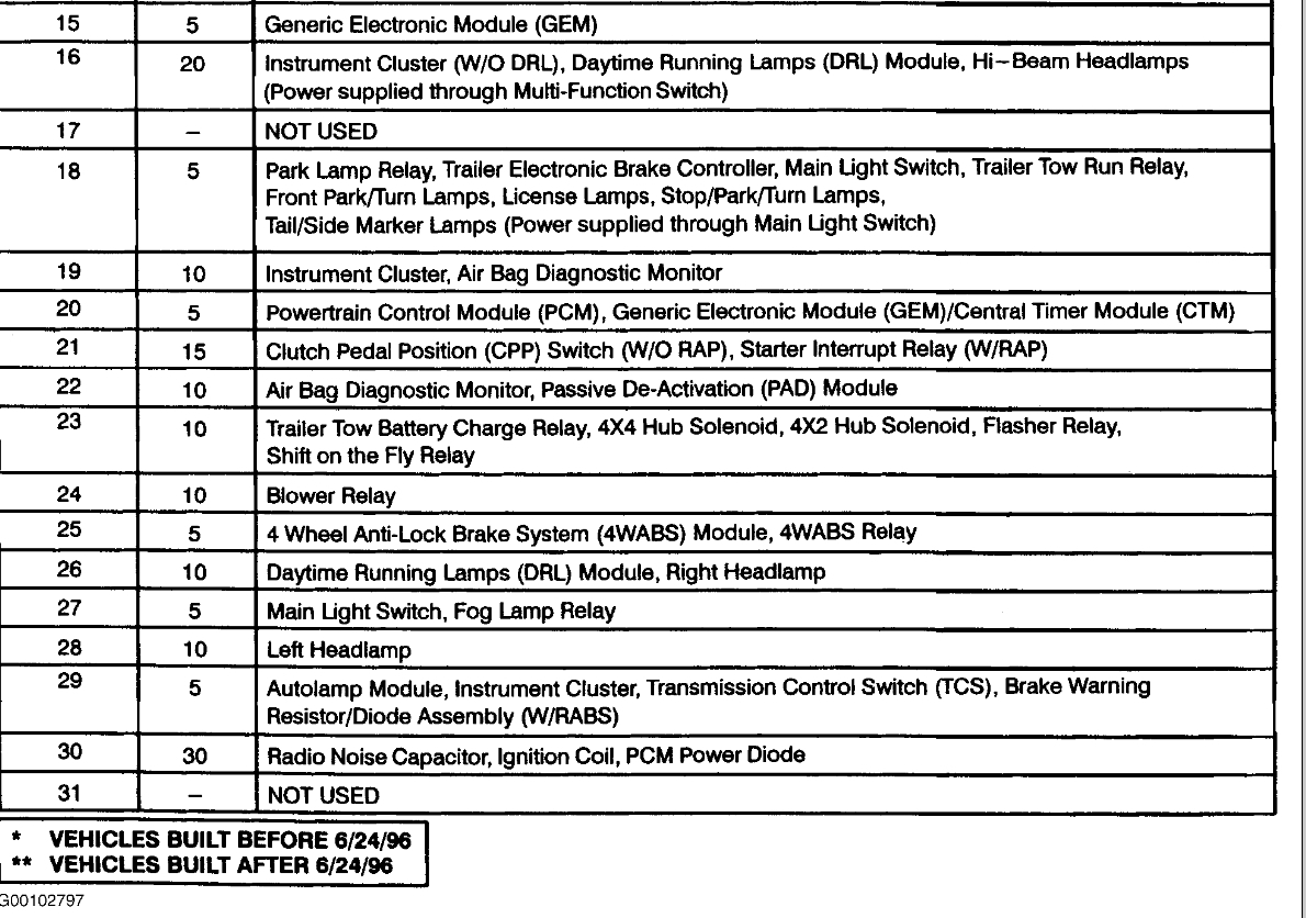

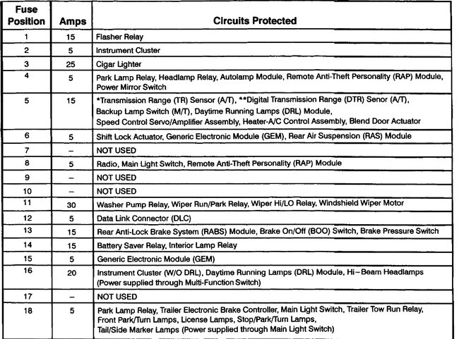

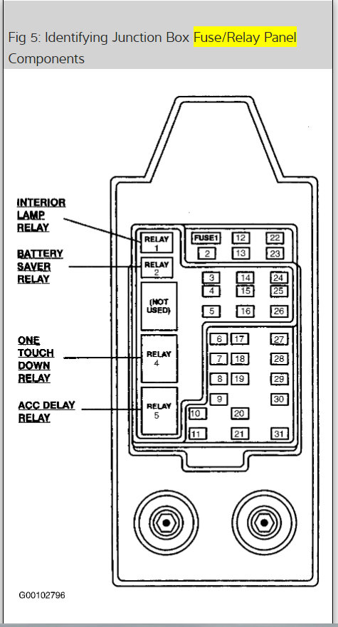

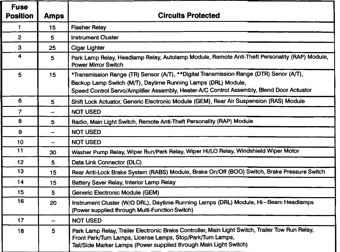

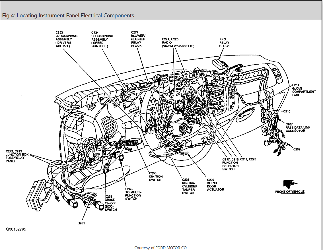

It is in the fuse relay panel under the left side of the dash, fuse#18(5A). I have included a diagram for you in the diagrams below.
Thanks,
Alex
