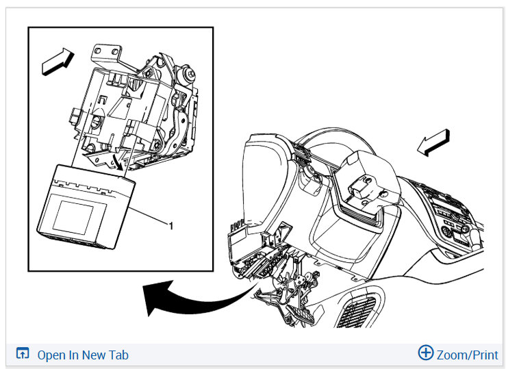

for some reason no one seems to know where the bcm is or doesn't want to share. i do my work if i can reach it.
Jul 9, 2025 at 4:58 PM
Here is the location of the BCM under the dash on the left side, you can get a preprogrammed unit by searching Google or Ebay. Check out the images (below).
Jul 9, 2025 at 6:02 PM
MAILHANDLERJON#1
  • 4 POSTS
i'm assuming that's just left of the steering wheel.
Jul 9, 2025 at 9:56 PM
Yes, that is correct, you will need to remove the knee bolster to get to it.
