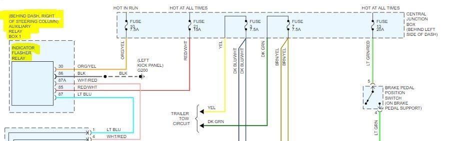

I can’t find the turn signal relay. I have read up on finding it, and it says that it is left of the steering column, but I don’t see it.

It's to the right of the steering column in the relay box. I attached the only picture I could find. Although it doesn't physically show its location, it explains it.
