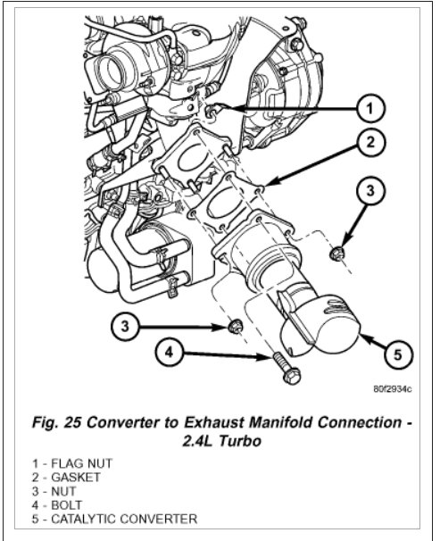

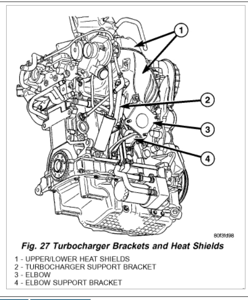

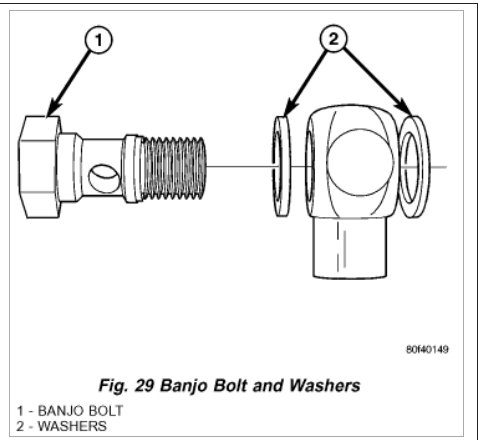

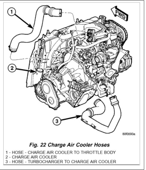

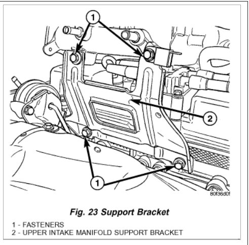

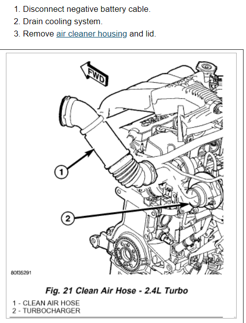

Yes, this is a sign the turbo has gone out check eBay for a replacement.
Here is how the turbo works:
https://www.2carpros.com/articles/how-turbo-chargers-work

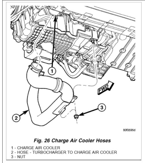

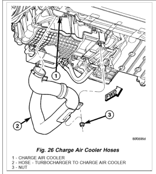

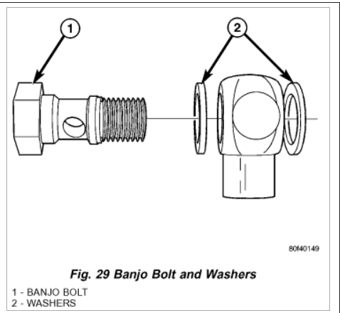

Here is how you replace it. Check out the diagrams (below).
