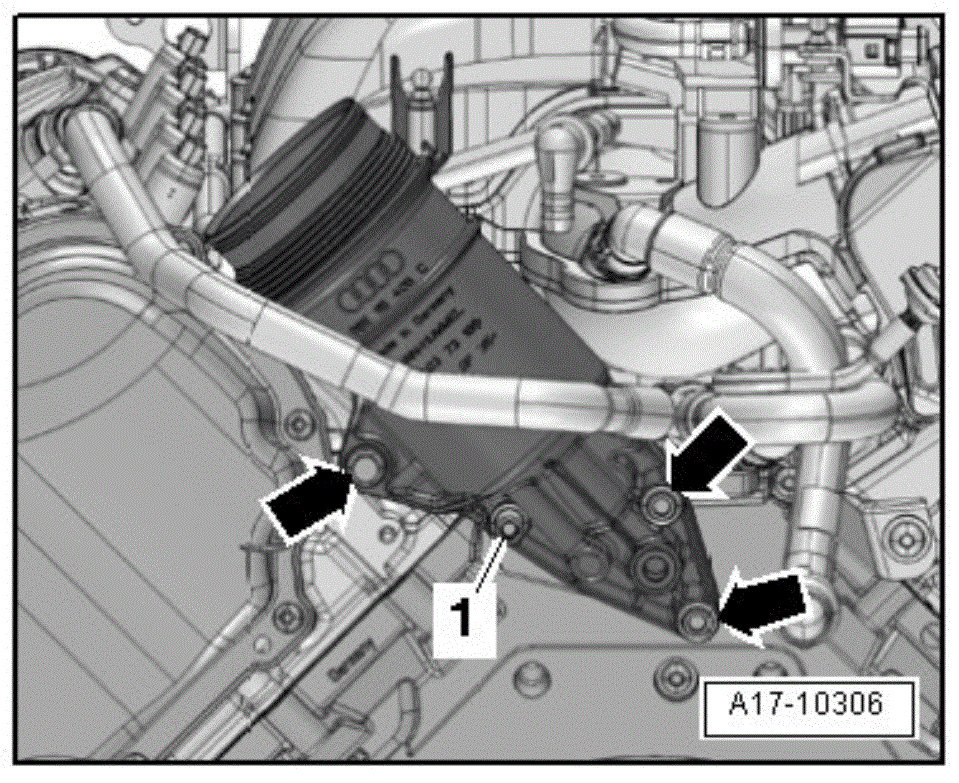

Next, there could be a leak at the oil filter housing. Standing at the front of the vehicle, the housing will be on the left side of the engine below the air induction tube between the air filter box and throttle body. See pic 1 below. Check that area for leaks.
