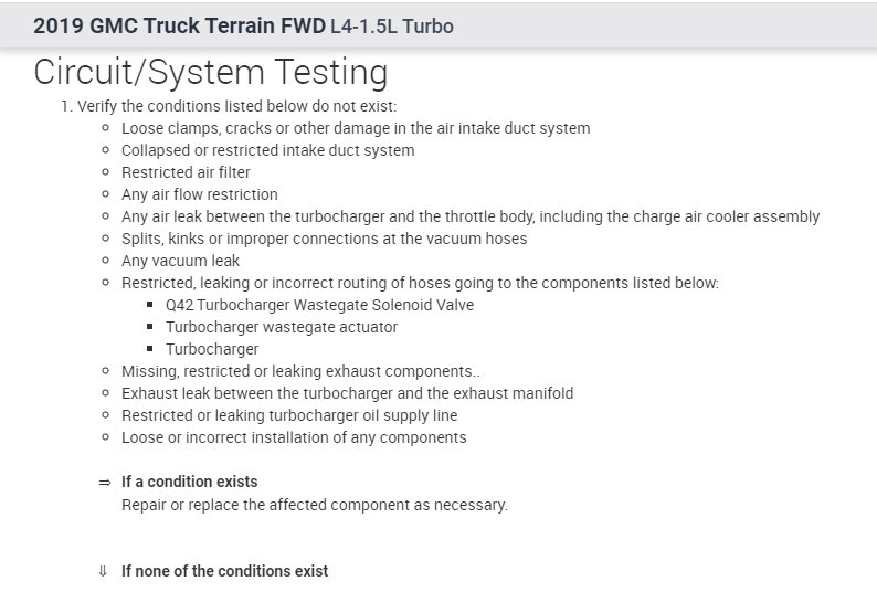

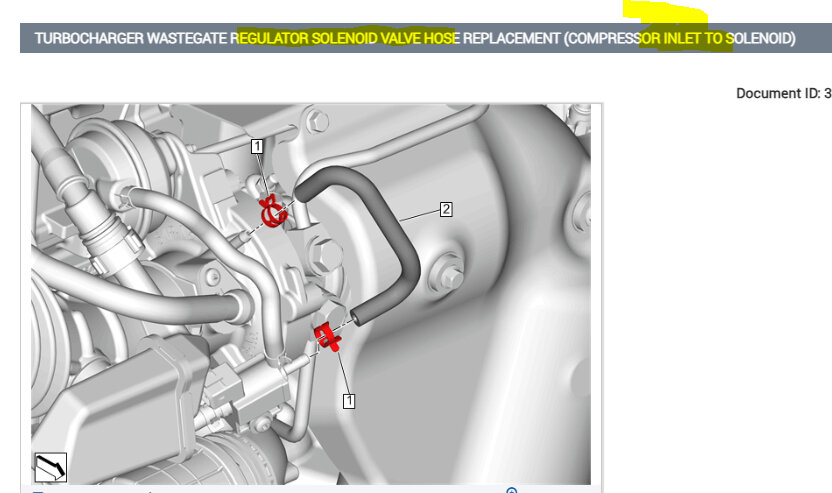

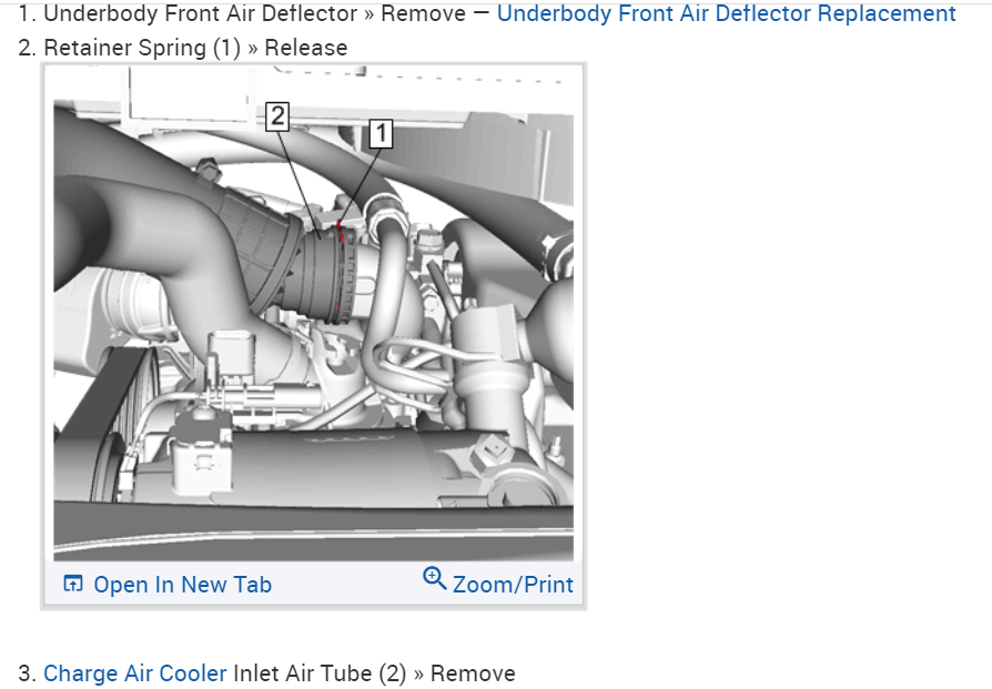

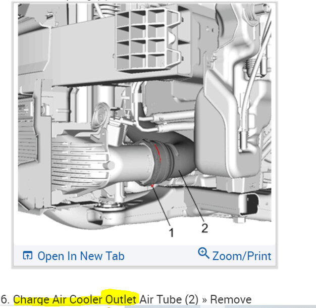

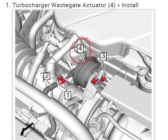

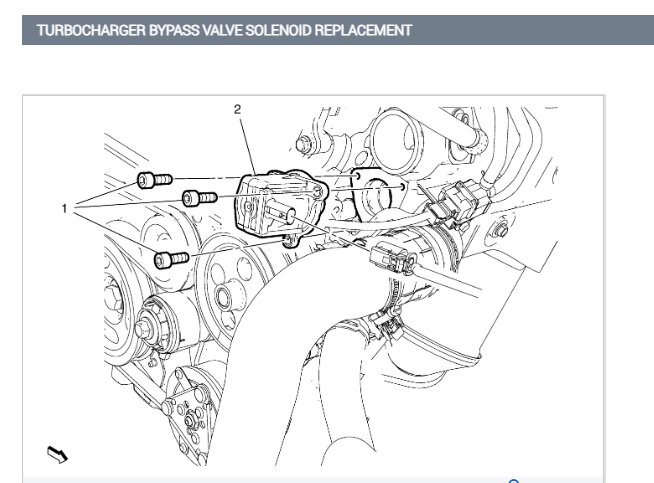

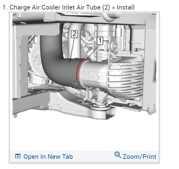

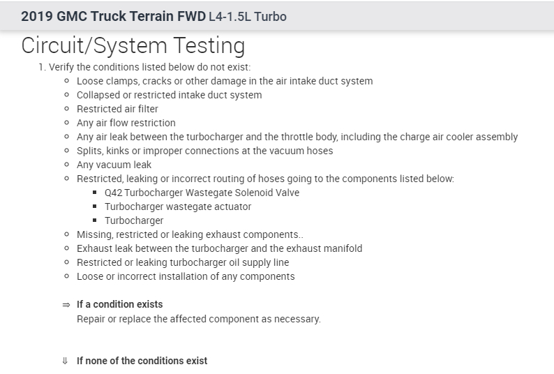

Where is the turbo boost location? I have code 0299. I would like to check if maybe there is a leak on the turbo oil line feed? Thanks
Aug 22, 2023 at 9:53 PM

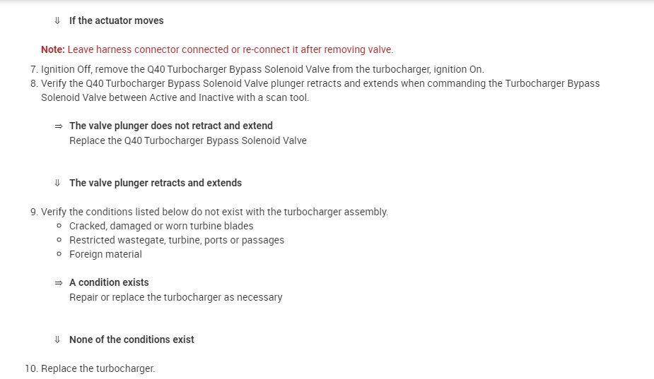

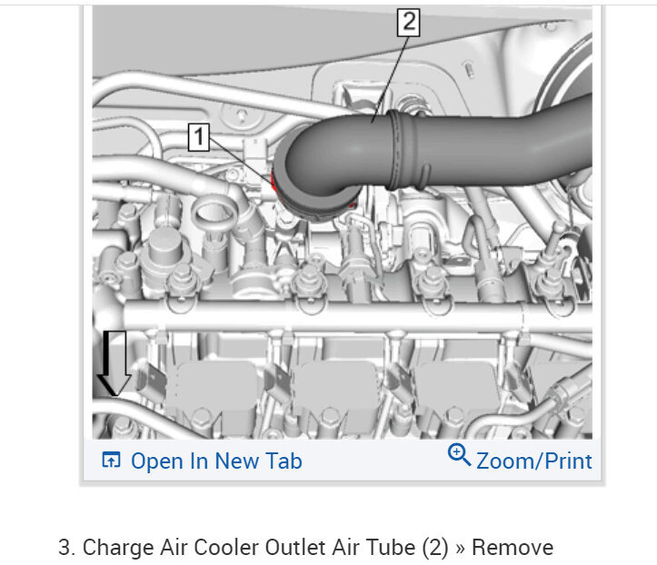

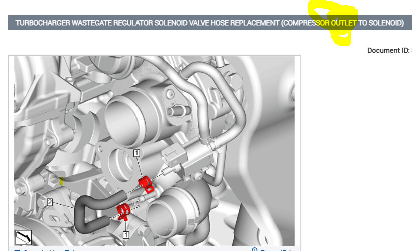

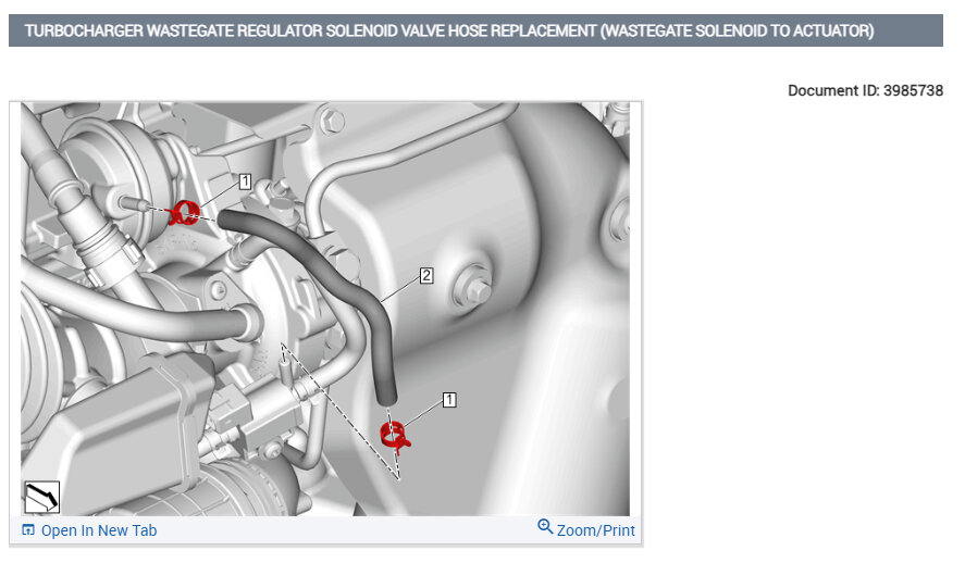

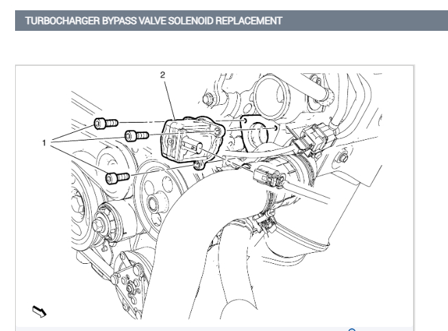

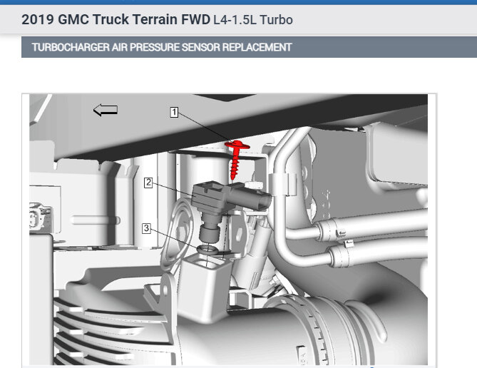

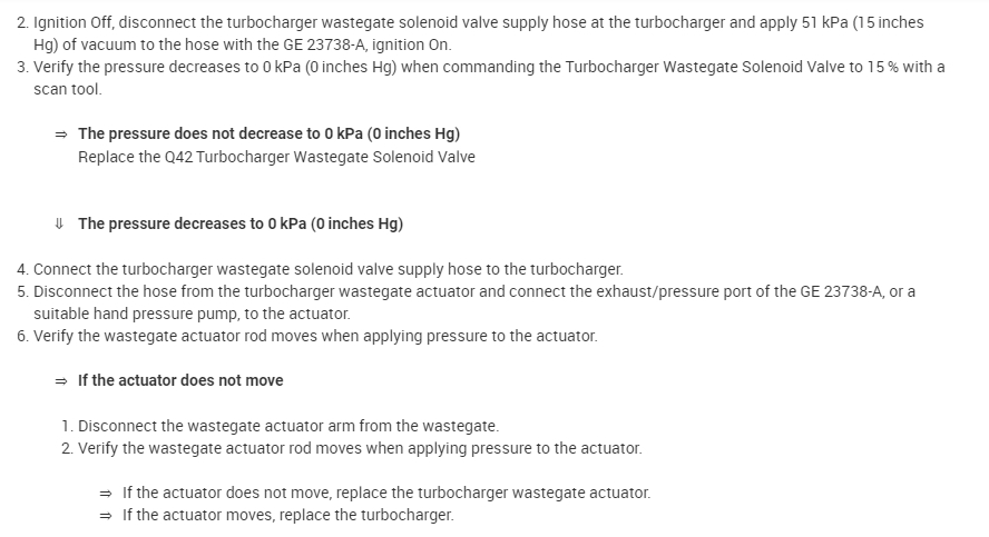

As far as the code, it is specific to turbo under boost. If you look at the first three pics below, they provide the circuit testing diagnostics. The remaining pictures (to the best of my ability) should be all related hoses.
Take a look through the pics and let me know if they help.
See pics below. The pics show parts and are headed with the hose or component name. I had to jump through multiple sections to get them. I hope I got all that you need.
